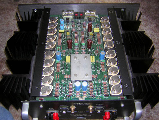

Am finally back after a long winded service trip through Nevada. Nothing is close together in that state!
Many have asked or denied they need to build the larger Krell....however......
Yesterday we had the opportunity to compare my KSA-50 MK-2 Klone to Bill WW's Krell KST-100 Class A-B amp. Clearly the KSA-50 clobbered the KST-100 in high frequency end of things... it was much more refined while the Krell KST was colder fomr about 5K up and just a tad bit gritty sounding. HOWEVER... the KST-100 blew the KSA-50 out of the water in the low end department driving my Dynaudios with a slam factor that never seemed to run out. The KST was literally able to make my floors shake playing back track 1 from Crystal Method, clearly the KST was definately more like my old KSA-80B. Also the KST-100 was not lagging that far behind in the midrange department as compared to the KSA-50, it was close with the KSA-50 taking the edge. The KSA-50 MK-2 kas really amazing bass response for a 50 watt amp but is nothing compared to the KST-100! This only re-affirms to me that the KSA-100MK-2 is the next thing on my list to build. Clearly my Dynaudios and a larger Krell are a much better match and I will continue to go ahead with the KSA-100 MK-2 amp.
Those of you that have speakers in the 86 to 90db sensitivity range also really need a larger amp to get the results I have been able to get with the larger Krells.
The KST looks like a pretty complicated circuit to attempt to Klone and I don't think it would be worthwhile to do. At that point going to the KSA-80 would be the better route to take for the time and $$ involved. Here is a photo of the inside of the KST.
Mark

Hi Mark
I liked that, and I am very interested to join this project.
BTW, interesting picture, every component placed on one board (it looks like that). If building an amp like the one on the pictures it demands a chassis that fits perfect for the board, dont you think?
It must be easier to build an amp (clone?) where you could have different options for to choose the chassis you like ( or maybe already have) ?
The project must go for one main/driver board per channel. thats only my opinion.
Regards 😎

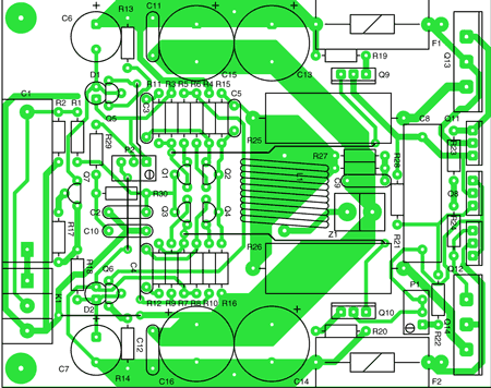

Also, I must admit that the long delay between posts in this thread had lead me to design a PCB on my own software. PCB design is not finished, only component placing and outer physical format of the board is done. No routing of traces and no ground-plane is done yet. (board outline ca 5.50" x 5.00").
I dont know if this could be of interest or you would like to start from scratch(or maybe you already have started).
BTW, right now Im searching for computer grade caps for this project( see this thread: http://www.diyaudio.com/forums/showthread.php?s=&postid=1011227#post1011227 )
Regards 😎

I haven't done any work yet on the board, but since there seems to be a lot of interest on a KSA100 clone and as I think that Al has made more than his share of contributions, somebody else might take it further.
There's no need to do a completely new design since his KSA50 boards are well designed and also work well. The same general layout could be used as basis; otherwise the genuine KSA100 MK2 board can simply be copied and adapted for the modern components.
I'd suggest that all the comments of what should be included on this clone compared to the KSA50 should come in within the next two weeks or so, after which design can start. Component identification should be one of the first choices, especially the MOSFET's. The BJT's can stay the same as with the KSA50. The protection, fan controllers etc. are all off-board and not part of the board itself.
It will be too expensive to start a group buy from South Africa since all the boards will have to be sent overseas, so I'd suggest that someone abroad with access to a PCB manufacturing facility handle that part, supplied with the Gerbers.
AndrewT raises a very important point, often (OK usually) overlooked by many designers, both DIY and professional. Grounding principles on a PCB is a very touchy subject for some, and opinions vary on what works best. Particularly in a mixed-signal environment there are a plethora of ideas and methods used, some with disastrous results.
The fact of the matter is that just by doing lots of copper pours, dedicated ground plane on a multilayer board or exotic copper plate shielding or similar can lead to worse performance than a much simpler well-designed ground scheme.
For a power amplifier ground and power planes are largely unnecessary. Proper care needs to be taken to prevent signal ground as the return for power ground, and to a certain extent screening of the signal ground should work well. A dedicated ground or power plane for power isn't really necessary, but will reduce DC resistance that may be a problem. Thick traces are sufficient for even very demanding amps though and a plane is overkill. The reason why power and ground planes are popular is due to digital electronics where the small inductance of the trace DO make a difference at high frequencies that are not the case here. A dedicated ground plane in a multilayer board is also used as a screen between the top and bottom layers to prevent signal coupling through the board substrate.
For normal non-switching amplifiers a double-sided board is more than sufficient as most of the advantages mentioned are not applicable. A properly designed copper pour for signal ground is unlikely to do any harm though, but a dedicated ground plane on an expensive 4-layer board is definitely overkill, and can even count against you.

Grounding is something I paid great attention to in the KSA50 layout, and I judge my efforts as being successful due to the lack of complaints on that topic. However, I would still like to see measurements done with proper equipment. 😉
Well I do have an Audio Precision SYS2722 (although it cannot do EMI tests), but the spectra I posteda few months ago got precious little attention so I followed a "screw them" policy.
it's a fact that KSA 50 and lookalikes are more than classics in last few decades
one example of this is Oly's bipamp- (Oly is Vangelis here at DIY) ,and he constructed it several years ago; I can't describe his reaction when I send him KSA schematics (somewhere in KSA thread beginning) -he was really surprised how his amp is almost same as KSA.....with few differences ,regarding fewer outputs etc.....
this is one of iterations of pcb for his amp-there you can see his mileage in making demanding pcb applications-this pcb look so simple....but I know that I can't make anything like this....😉
