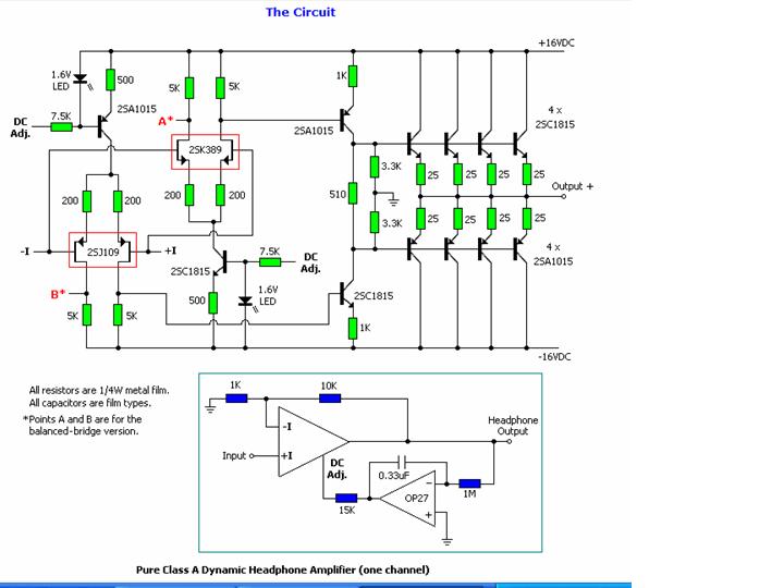

PWatts said:. I'm very busy lately but will try to experiment with DC servo's when I have the chance.
Hi PWatts,
I've attached the constant current source servo circuit from the Gilmore headphone amp. Some Krell Klone designers may want to Spice experiment on similar circuits. Some amp designers say they can hear a loss of dynamics with a traditional voltage summing servo, and a constant current souce servo would be sonically superior if a robust design can be worked out.
Perhaps Jacco thought Mark's spelling of Wiki was incorrect, or perhaps he thought PinkMouse had left too much pink slime on the past pages of this thread in locating a fast link to this Wiki.
I know earlier, I had to dig through the backpages to find it myself.
Now it is off to the barber. Mark knows I have an important date!
Hi PWatts,
I've attached the constant current source servo circuit from Steve. Some Krell Klone designers may want to Spice experiment on similar circuits. Some amp designers say they can hear a loss of dynamics with a traditional voltage summing servo, and a constant current souce servo would be sonically superior if a robust design can be worked out.

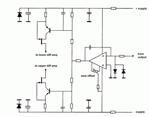

Hi all,
I've cobbled a servo together (in theory though) that simulates well with the KSA100. It's a normal lowpass summing one, but a dual-stage one that works a bit better. It's fairly simple with one dual opamp, four capacitors and five resistors per channel. This is excluding the opamp power supply, but can be downregulated with a standard zener and elementary decoupling.
The simulations are promising, and (as one would expect) it didn't do anything to the THD. It also allows one to leave out R17-R21, D3-D4 and VR2, and this reduces the distortion somewhat.
Since component quality isn't too important, this could be assembled on a very small PCB using SMD components, easily smaller than 40x40mm. Experimenting is also easy; it only needs two leads from the amp. If it works, R19 can be removed and if successful the rest of the original DC correction components too.
The Gilmore servo is an interesting one.. I've used it myself on a headphone amp design of my own a few years ago but never for power amps. I'll toy around a bit with some of the current-source servo's too sometime, but the moment it becomes complex it will be increasingly difficult to use as add-on for existing boards. However, since even they are simple to build and test there's no reason why people can't experiment with it by themselves.
