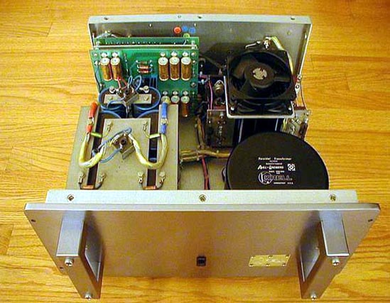

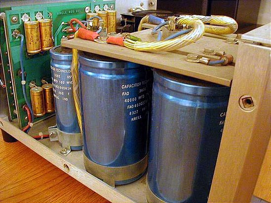

Interesting power supply
Hi Mark
Any idea for what reason Krell used a power supply regulator ?
Was its purpose to rise the efficiency of the output stage
(this could be done by having a 5-10V higher rails on the input/driver stage)
Or was the purpose to lowering power supply ripple noise/buzzing?
Maybe both.
A long time ago I built a Pass 40W Class-A and implemented a solution similar like the Krells (I think but Im not sure about that). I think I used a regulator for ± 7-8 volt higher/lower than for the power devices who was darlingtons).
The benefit for doing it for me was lowering power supply noise AND a rise in power output capability, thus rising the efficiency of the amp (also: rising the total audio quality )
Wandering if this implementation should be located together on the amps driver board ?
It could be done though its not a high power circuit. Or is it impractical?
(benefit: you only need to make one board, not two. drawback: a more complex board/circuit)
What do you think?

Take a look at Mr Macleans site and look at the actual KSA-80 manuals and also at JWB's thread. I believe that the KSA-80 used a similar supply. Take a look at JWB's thread and schematic starting in Post 12 of the KSA-80 regulated supply. It is probably very similar to the KMA-100's. Note that the power supply WAS part of the KSA-80 main board and its a relatively simple supply.
Andrew......
Unfortunately I let go of the KSA-80B about 6 years ago. I wish I had kept the thing. The manual states that the rails in the KSA-80 were +/= 75 volts and the bias was 325mv across the 1 ohm emitter resistors. On all versions of the KSA-100 the bias was set for 575mv across those 1 ohmers. Hopefully this will help you out......
Al, The fries are getting overdone
JWB did not thermally couple his together in his KMA-160 rebuild, they are quite small in size so it is probably not really necessary since they will change temp from the ambient quite rapidly. Other than these parts I think you are already familiar with everything else used.
Mark
