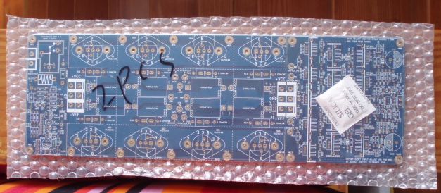

Good News! 6 Prototype boards are on the way. The last DFM was just about perfect and the couple of silkscreen problems that existed were automatically corrected by the PCB house's computer. I should have the boards next Friday, just about the time I should be getting back into town.
Attached is the final silkscreen as it will be made.
Mark

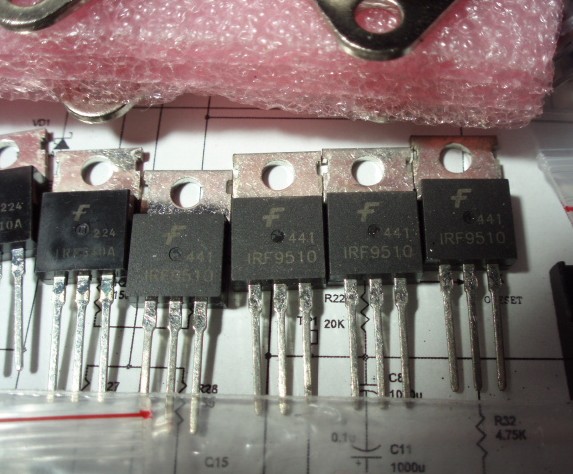

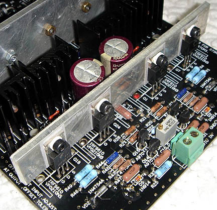

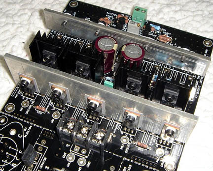

There are two dofferent Krell boards gong over there. Here is a picture I found of the Chinese copy of the Mk-2. They are using the IRF9610/610 in place of the obsolete semis...

It is a very well designed board. I also prefer to use that type of output device myself and used it in the KSA-50 amp that I built. PWatts made room for two different kinds of fets on our board... the IR TO-220 type as you used and also for the ZVP/ZVN 2210.

Before anybody ask, the blank area between the predrivers and the drivers are to accommodate heatsinks for the predrivers if needed.
Actually I made provision for three different FET's, but not the TO220 types after we saw that they're very inferior in this application. I provided for DIP-4 (IRFD110/9110) since they're superior to the 510/951 in this regard. The other was TO-92 for the ZV3310A and 2210A ones, and the third SOT-223 for the G types. I personally would prefer the latter, but without proper tools they'll be a b*tch to remove if something breaks. I doubt whether matching will bring any worthwhile improvement, but hey, they're cheap and matching is easy.
