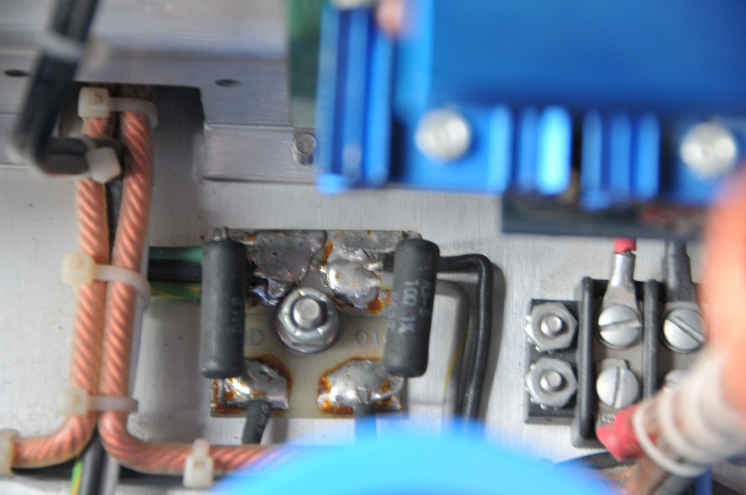

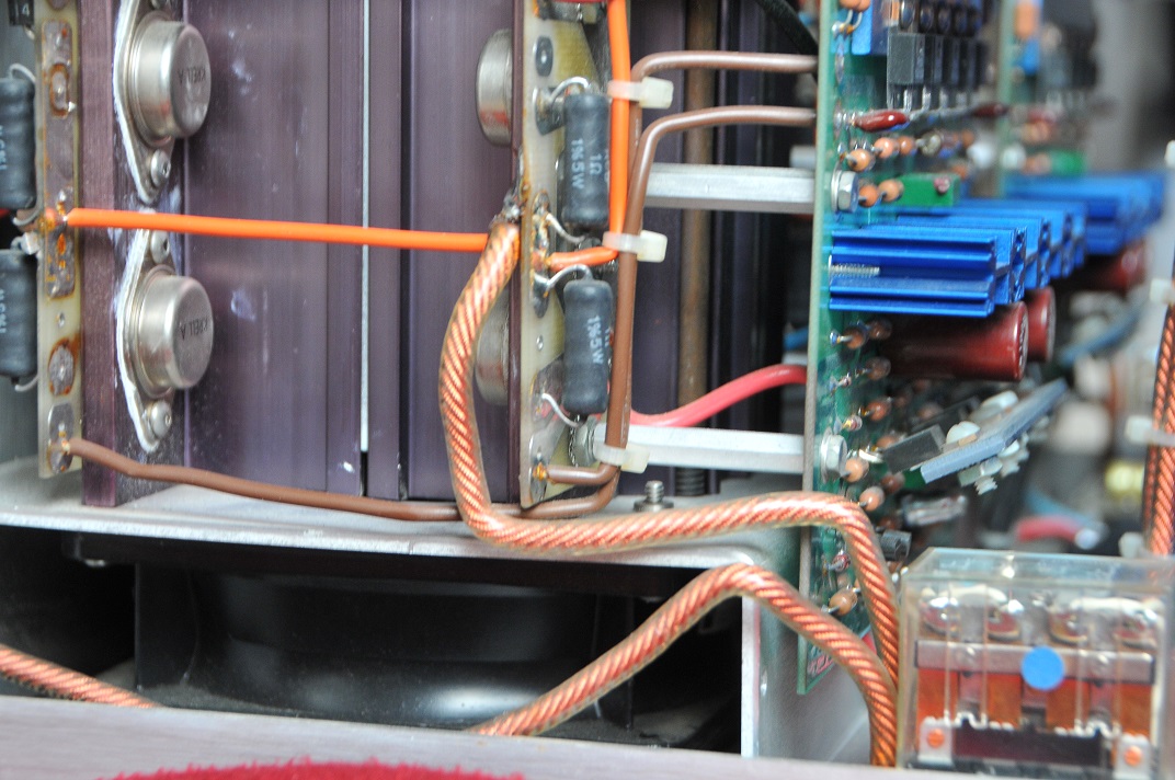

The 10 ohm on the bottom appears to be there to lift the main ground. I'm not sure if this was standard spec from Krell.

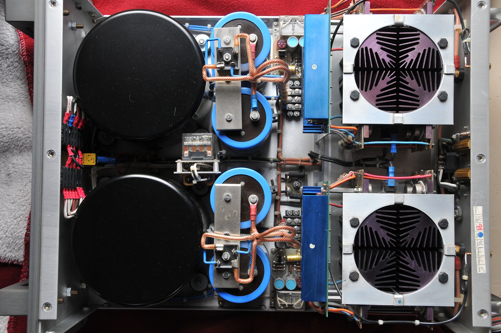

I will mainly use this KSA-100 Mk2 for powering the woofers of my speakers.
I measured the railvoltage @ 52 Volts isn't then good practice to go for the highest capacitance value?
I did not read any definitive choice for a G.B. in this thread (reached page 89 yesterday) regarding the powersupply components yet.
I'm inclined to choose a powersupply cap that has the same dimensions as the original Spragues. It's easy to swap then with those thick attached (looks like old Monstercable) cables to the DC side of the bridge.

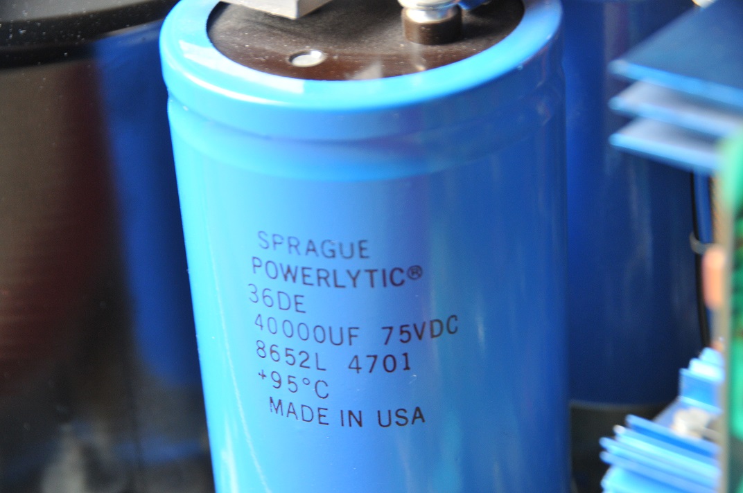

I already decided to replace the feedbackcaps on the mainboard the Roedersteins 1000uF/16V and I'm looking for replacements for the 30 years old Sprague 40mF/75V powerlytics.

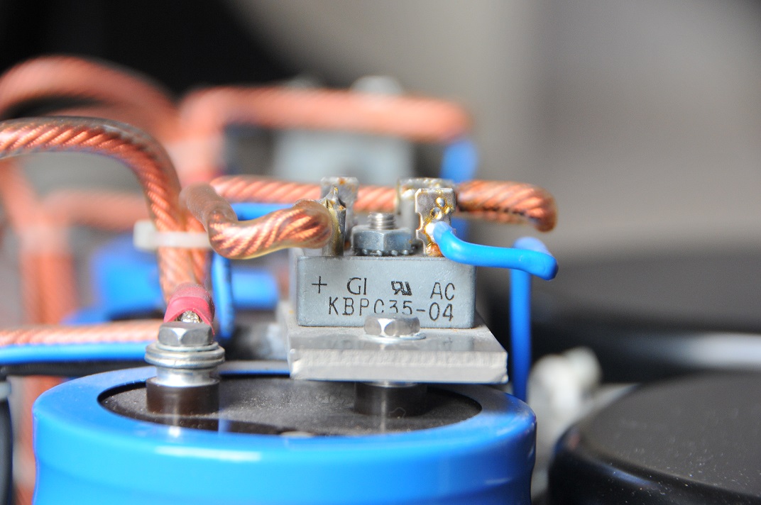

Does the bridgerectifier (KBP C3504, 35 amps) handle the greater capacitance of 40 vs 100mF?

Can anybody explain to me how this works?
Does anybody know what those heavely soldered 10Ohm powerresistors are doing on the bottom of the amp?
Thanks in advance!

I just delved into all the old pictures of MK2's I've worked with. Your model really does seem to be very original, which is rare at this age. The only possible difference I can note is the insulation of the power lugs at the front AC loom which is black in all the ones I've seen but red in yours, but as you note this is from a time when Krell was not exactly as consistent as nowadays and it may very well be what they happened to have in stock at the time. I've seen much worse variance between amps in e.g. Sunfire.
Anyhow, experimentation has helped a great deal to learn what helps and what not, and it's of course nice if you have a whole new board to experiment with so that if something goes wrong you can still drop in the original as backup. The Clone boards also have a number of improvements.
On yours, the improvements really are only to replace the feedback caps (Panasonic FC/FM/FR/FK are all good) and the main caps. The original Spragues are hellishly expensive but still sounded better than others I've tried, but I'm sure there are better options. Munforf's M-lytics were great but crazily expensive. Replacing the speaker wiring helped a bit, and if you're a little more adventurous, modifying the wiring a little so that the speaker output and the feedback to the amplifier board are a) symmetrical and b) at the same point helped too. The fans can also benefit from replacement if they're noisy or slowed down, but that depends on the operational hours and amount of dust in the environment.

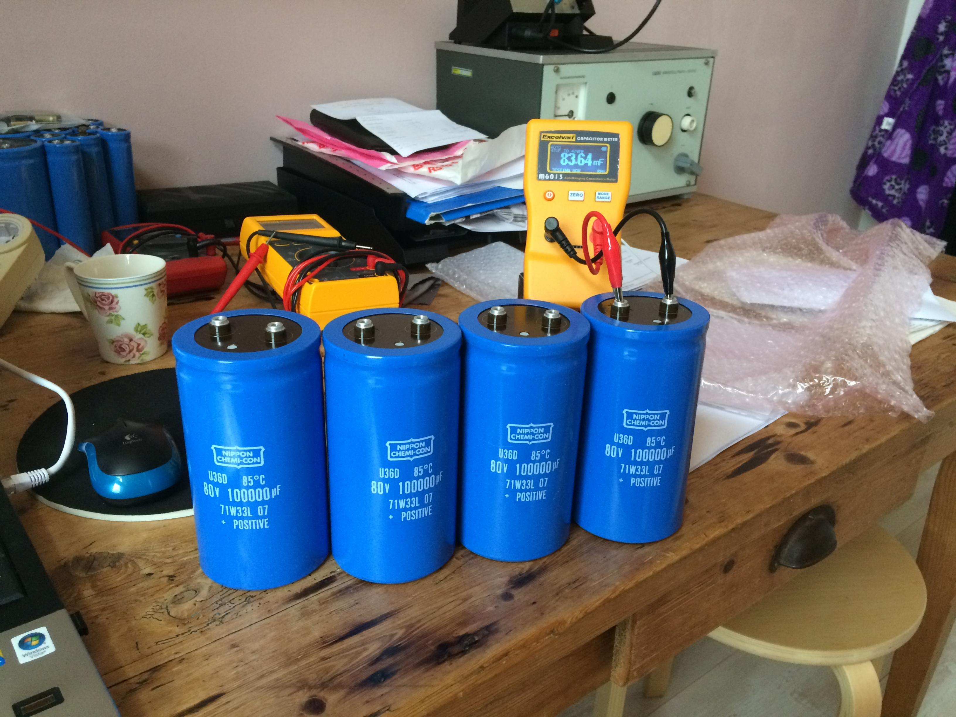

Today I got four Nippon Chemicons U36D Series from Digikey, 100mF 63V and all four them measured 83mF. They looked like pullouts with light dents and markings on their sleeves. I will send them back. I still have the old Spragues, 61mF, 50 V from my Levinson ML-2's and their date code is from 1978. When I measure them they all give 67mF after almost forty years.... Don't know about their ESR of course.

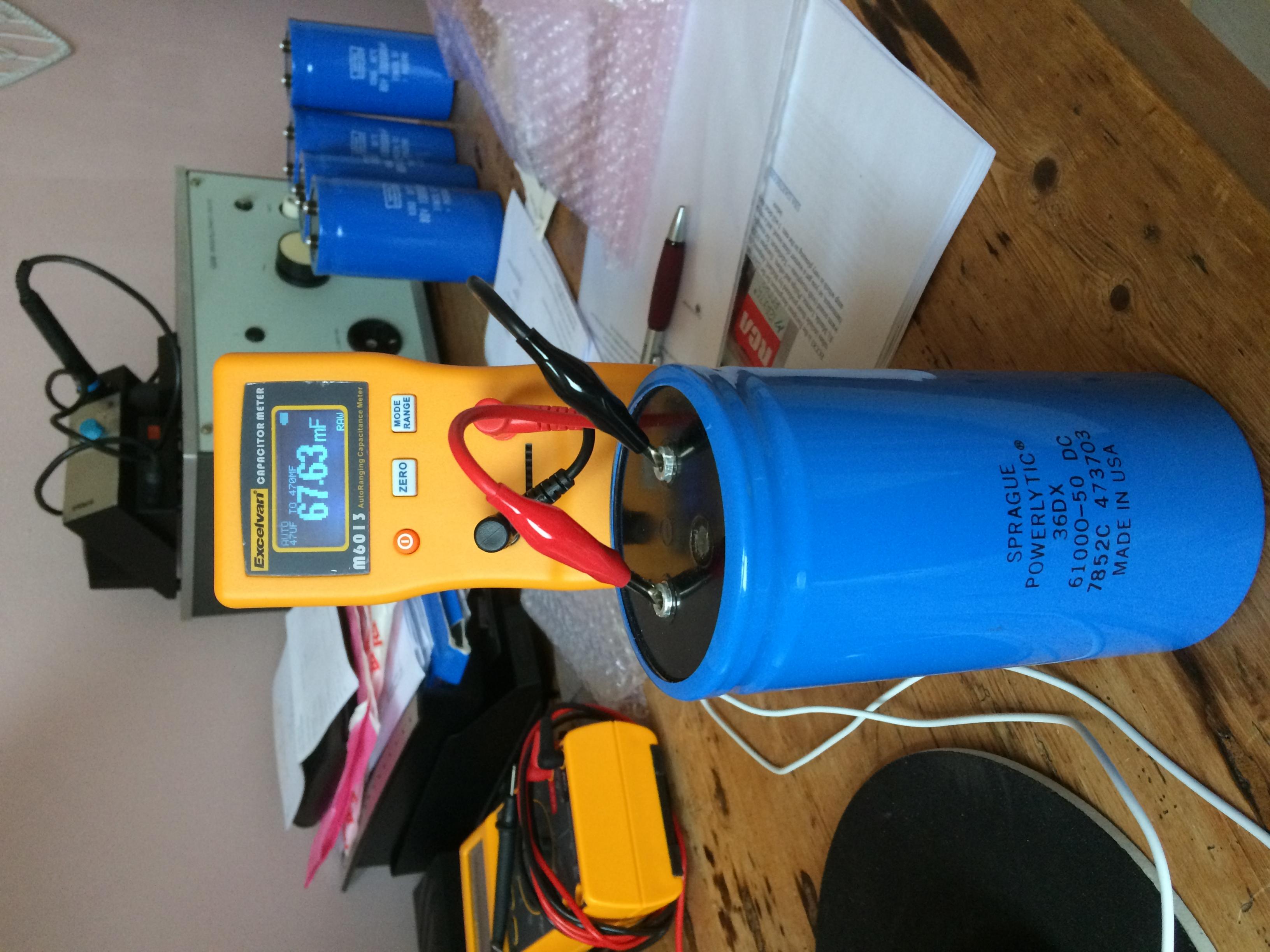

This is one of the four large Sprague 61mF, 50V out of my ML-2's.
It is still 6mF better (or more) than it's initial specified 61mF.

This is a "new" Nippon Chemicon U36D 100mF, 80V large can that "lost" already 17mF

Maybe the Nippon Chemicons were shelved for a decade or so....

The Sprague are rated at 50Vdc
That is too low for the ksa100 which at nominal mains voltage and fully loaded is already at 52Vdc.
When mains is high and/or the loading is reduced, the voltage on the smoothing capacitors will rise to way above 52Vdc.
You need to use 63Vdc, or higher, smoothing capacitors.

I've had Sprague's, Cornell Dubiliers and Mallory's and they were all 10 to 20% above their capratings. All four Nippon Chemicon U36D's were all 17% under their capratings so I think the whole inventory from Digikey is low on capacitance.Elcos are +-20% tolerance so it may be that they were a little low to begin with.
