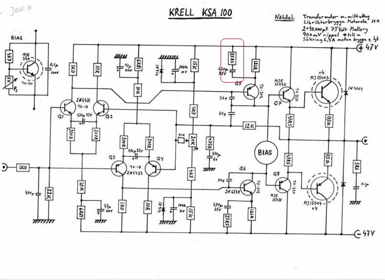

P primare Member Joined 2002 2003-04-15 3:05 am #1 2003-04-15 3:05 am #1 Can somebody explain what the purpose of the highlighted resistor and capacitor is in this amp? Thanks. Attachments ksax.jpg 55.6 KB · Views: 454 K kevin gilmore Member Joined 2002 2003-04-15 11:47 am #2 2003-04-15 11:47 am #2 It increases the voltage gain of the driver stage at frequencys > 20 hz. Status Not open for further replies.
