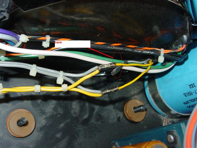

P-M,
did you also check the 4 rectifier diodes next to the red entrance socket ?
(the yellow Roederstein-EG do not live forever, wrong cap for such a hottie)
Hello Jwb
Have you to it diagram of the transformer? and of its internal wiring?
Already looked in lower part of the transformer?
Are all the wire in the resin?
Pierrot
Pierrot
Yeah, I do have a diagram of the transformer. Unfortunately I have no idea where it is. I am looking for it, and when I find it, I will post it here.
