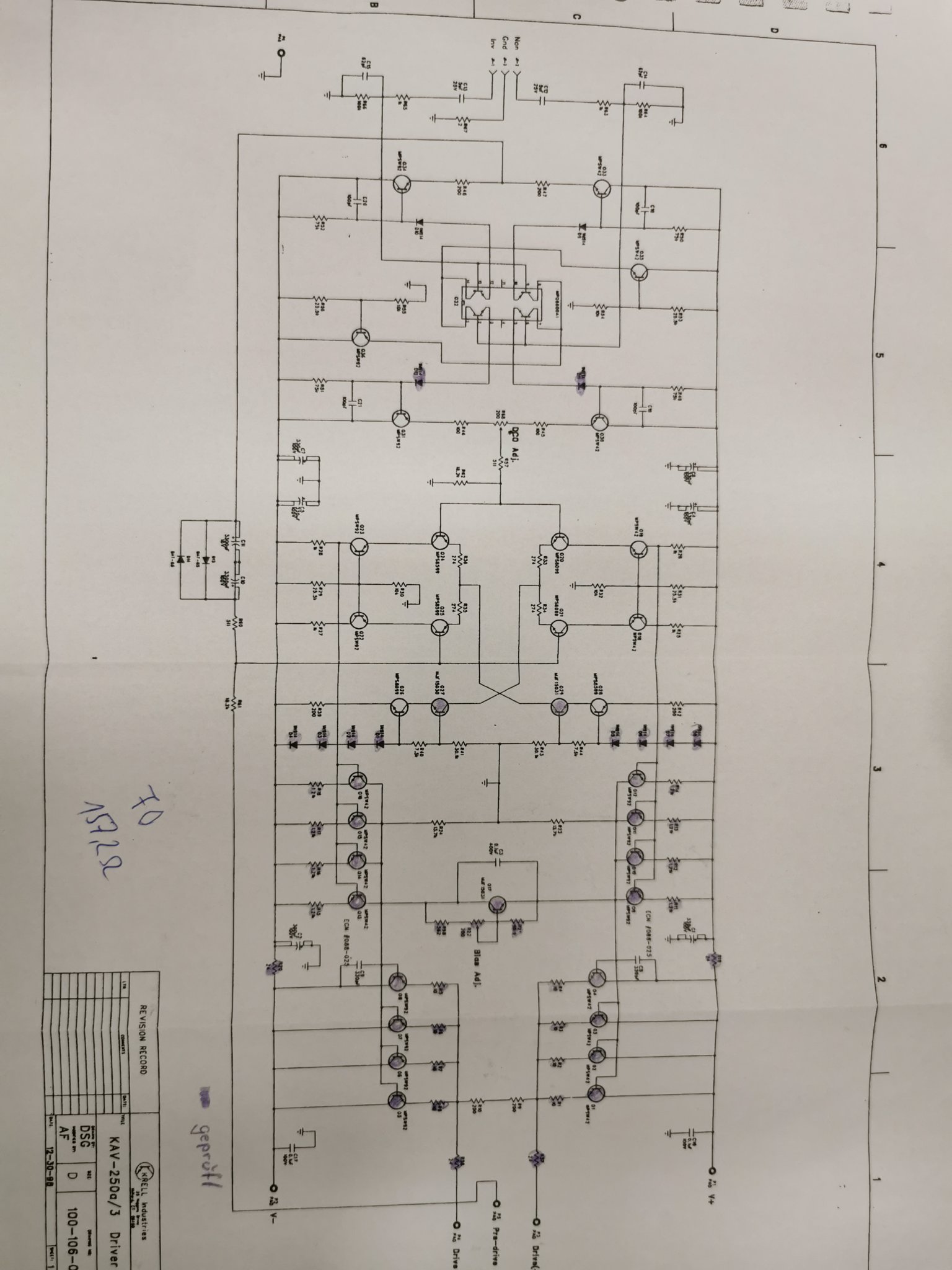

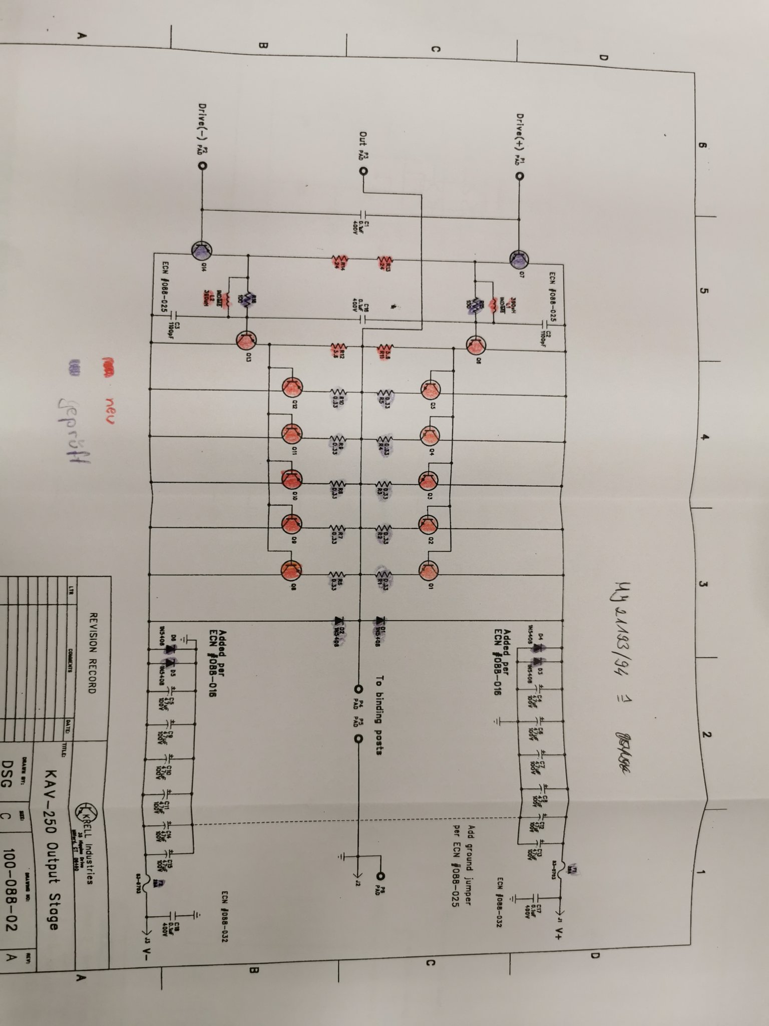

I have an unfortunately defective Krell KAV500i. All transistors in the output of one channel were broken. I have now replaced it, but it plays totally distorted at low volume.
Strangely enough, I have this distortion on both channels. When I turn up the volume the distortion disappears.
I can't even imagine that now.
Attached are the two circuit diagrams that I found.

You should be able to develop a few mV across each of the 0.33 ohm resistors. What voltage are you able to develop across C3 (i.e. collector to emitter at Q17) ? Be very careful to avoid massive over-current. R22 set for minimum corresponds corresponds minimum spreader voltage.
I assume that Q17 is mounted on the same heatsink as the output power transistors so that Q17 can sense the temperature of the transistors and adjust the spreader voltage.
R21, R22, and R58 (?) controll the spreader gain. The spreader voltage is about Vbe*[1+(R22+R58)/R21]. R22 of course can vary from 0 to 200 ohm. So gain from 1+562/90.9 minimum, and 1+762/90.9 maximum; so spreader voltage adjustable from Vbe*7.18 to Vbe*9.38. Taking Vbe=0.6V, voltage would be adjustable from 4.31V to 5.63V.
The output stage is a cascade of 4 NPN emitter followers for positive swing and 4 PNP emitter followers for negative, or a total of 8*Vbe, roughly 4.8V. So the spreader design looks reasonable.
But you observe only 2.7V. I believe the spreader is misbehaving or there is a shorted output transistor(s). You should probably use a Dim Bulb Tester to minimize risk to the output stages.

What is history of this amp? Did you acquire in broken condition? Has it been worked on before?
Try to find why bias spreader isn’t woking. Why doesn’t spreader voltage rise with changing pot rotation? Look at base emitter drops across all 8 emitter-follower chain.

I suggest disconnecting the output stages from the front end. This will allow you to troubleshoot the bias spreader and front end independently from any problems in the output stages.
Isolate the output section by disconnecting the wires at “Drive(+) P1 PAD”, “Drive(-) P2 PAD”, and “Out P3 PAD”. Let the output section float. From the “Out P3 PAD” on the PCB, run a jumper to the junction of R9 and R10. This connects feedback and when you apply power, the “Out P3 PAD” should bias to about 0V. You should be able to exercise the bias pot and generate the range of spreader voltages estimated earlier. Or troubleshoot if necessary.
If this proceeds as hoped, we can then do some checks of the output section. When all seems correct, we’ll reconnect everything.
