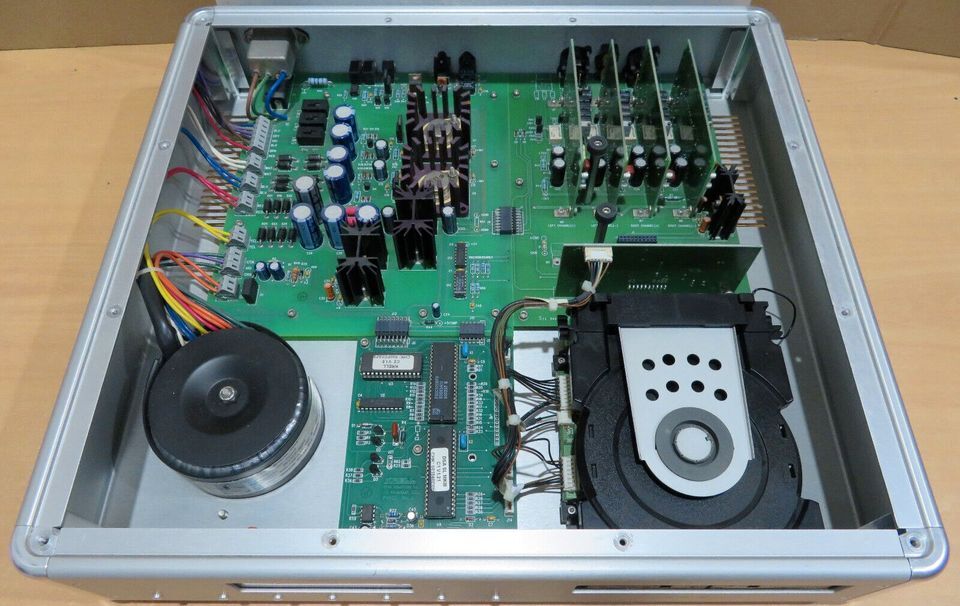

Hello,
My KRELL KAV280cd is faulty !
The problem :
- digital outputs, coax & optics are OK,
- analog outputs, coax & XLR, left & right are wholly
dead.
Power supply is OK : +/-18v +/-5v ...
Then, I suspect one issue on :
- digital filter board,
- or on DAC board
My problem, for understanding and repair :
- I have no schematics, no sm
Truly, I would appreciate if you could help me
Raymond
( pardon my English ! )

First step is to check all supplies at their destinations as this player is sure to have multiple rails. Check the supplies on those stand up boards.
Are those relays operating (the relays could be for muting) ? Use a scope and see if there is audio on one side of the relay.
If not, then locate the DAC, ID the chip used, get the data sheet and see if audio is emerging from the DAC. If the DAC feeds an I/V convertor (typically an opamp) then look for audio on the output of that opamp.

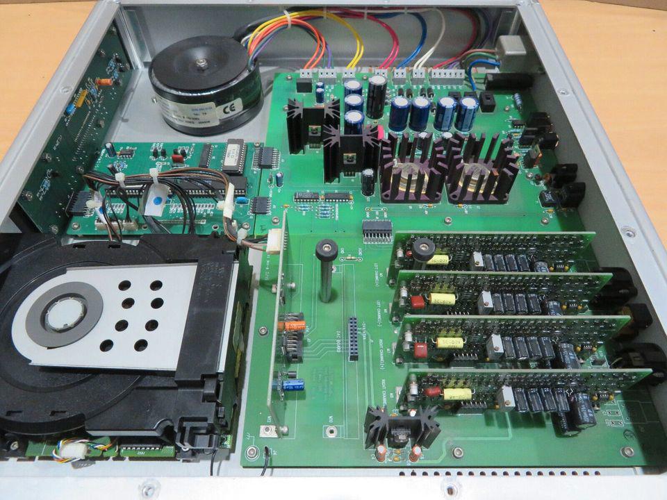

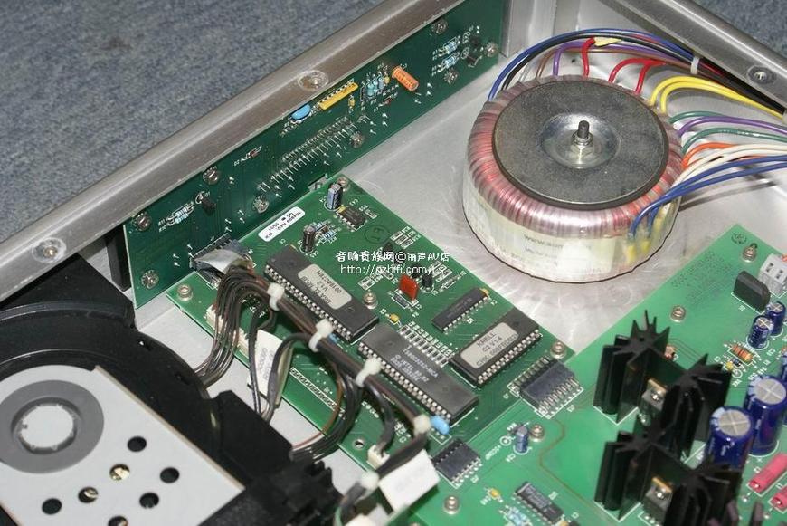

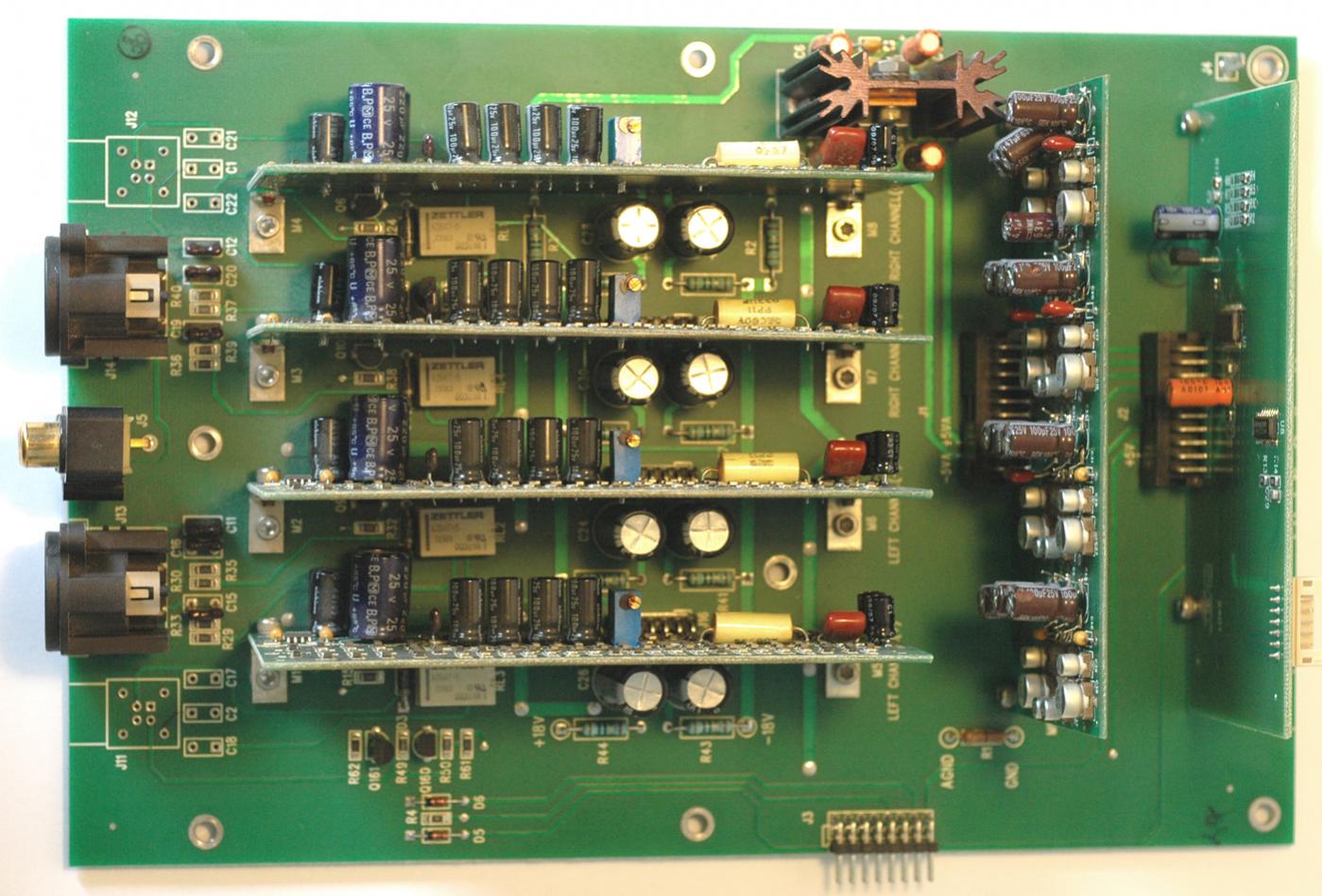

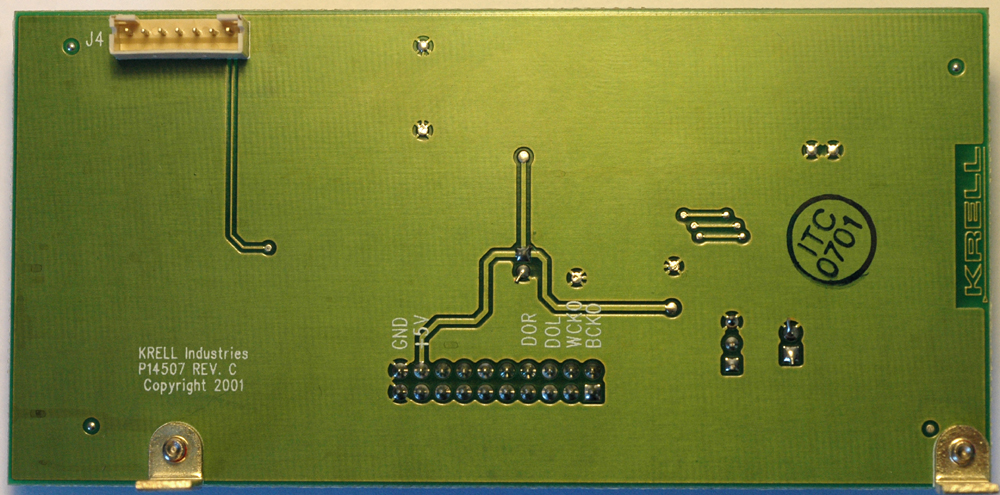

Hello MOOLY,
Thanks again for your help !!
Because :
- digital Outputs is OK,
- Analog Outputs L&R are dead,
- supplies are OK
Fault can only located on :
- Digital Filter board,
- DAC board,
- or 4 relays are no activated.

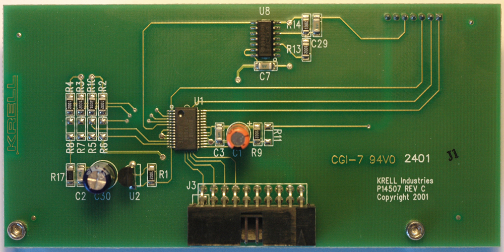

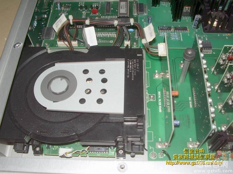

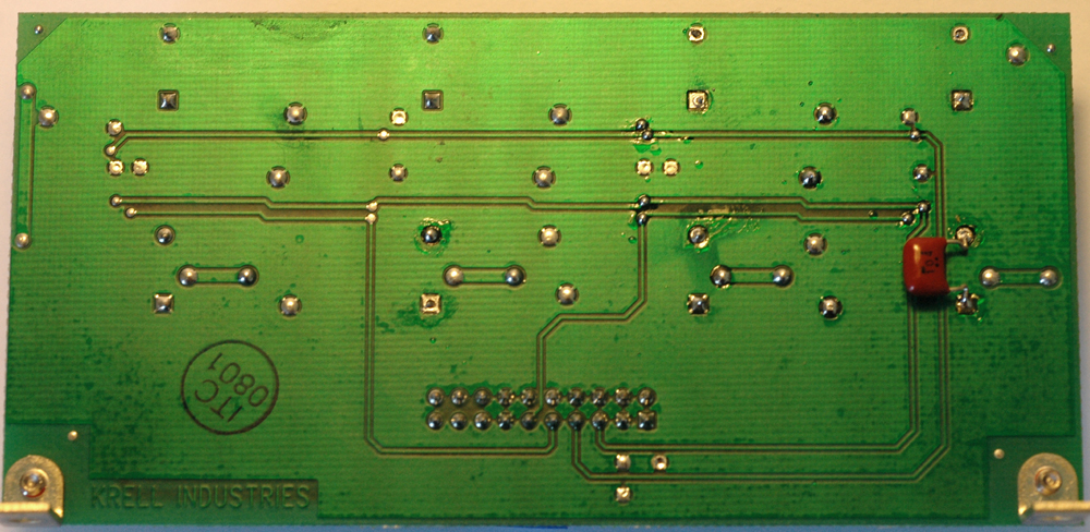

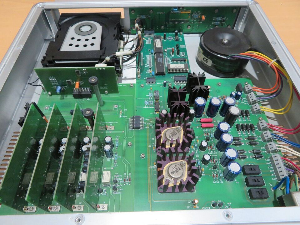

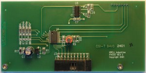

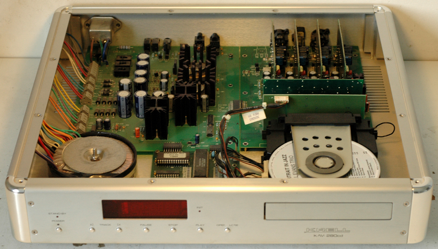

On Digital Filter board, there is :
- U1 = BB DF1704E
- U8 = TI 99ADORM HC04 ( I don't know what it is ! )
- U2 = MC34064P
On DAC board, there is :
- U1 to U4 = BB PCM1704
Below some pics for You :
- Digital filter board face & reverse,
- DAC board face &reverse
Yours,
Raymond
Because :
- supplies are OK
- DAC board,
- U1 = BB DF1704E
- U2 = MC34064P
Yours,
Raymond

U8 could possibly be a 74HC04 general purpose logic chip.

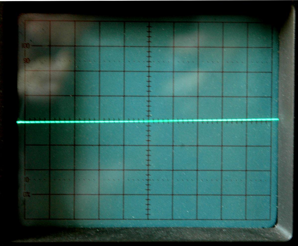

Hello MOOLY,
I am coming back after this long time.
And I wish you could be right !!
Then ... :
- Supplies are OK ( +/-5v for digital, +/-18v for audio )
- No problem with capacitors, semiconductors ( BC547, ... ), resistors, soldering, ...,
- if digital outputs are OK, that means Philips VAM1201 is nice working,
- The four Audio PCB must be removed from the list of culprits ( impossible that the four might have a fault simultaneously ),
- It remains Digital Filter Board and DAC Board, to the attention.
Digital Filter Board has 4 outputs to ---> DAC Board
Marked BCKO, WCKO, DOL ( I think "L"= left ) and DOR ( "R" = right )

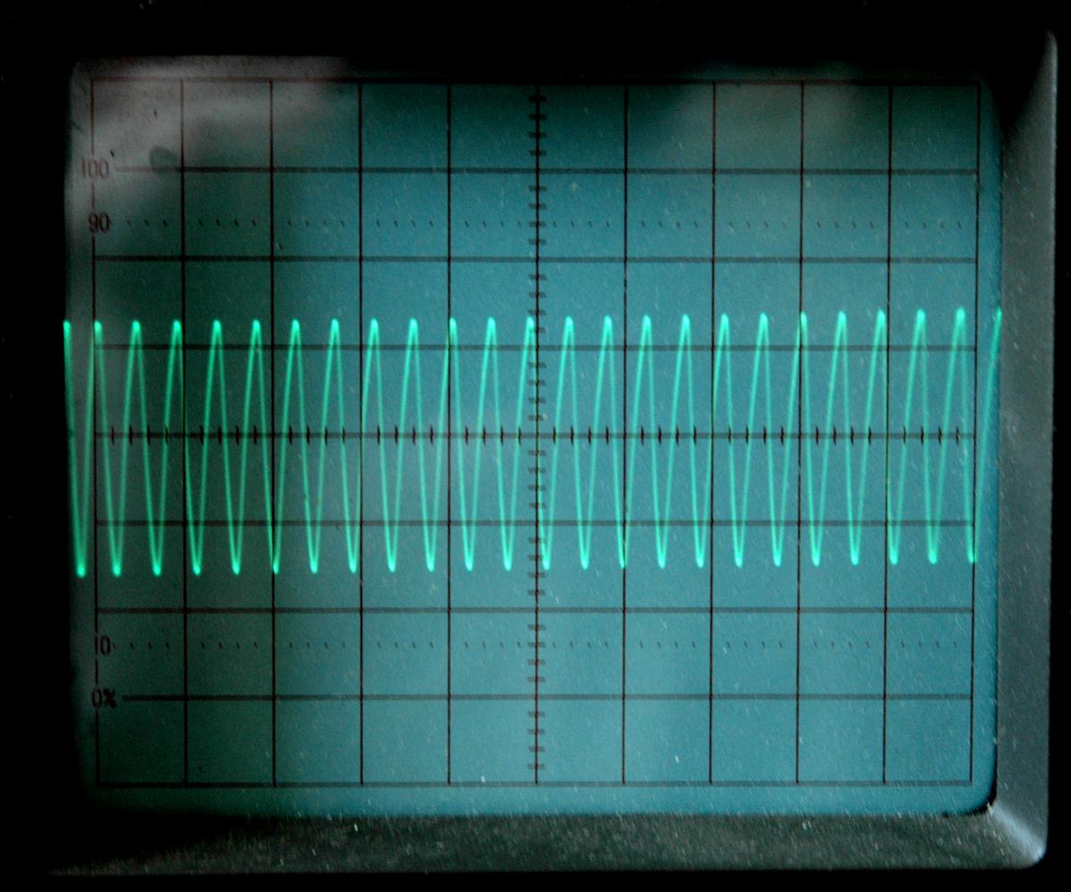

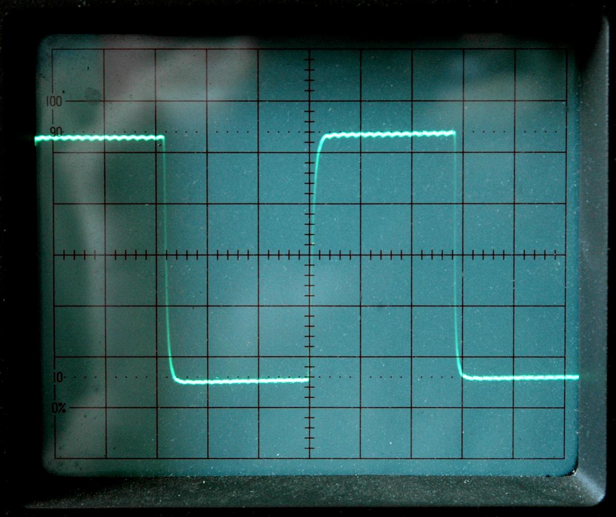

BCKO oscillogram ( does not vary on pause or play ) :
VCKO oscillogram ( does not vary on Pause or Play ) :

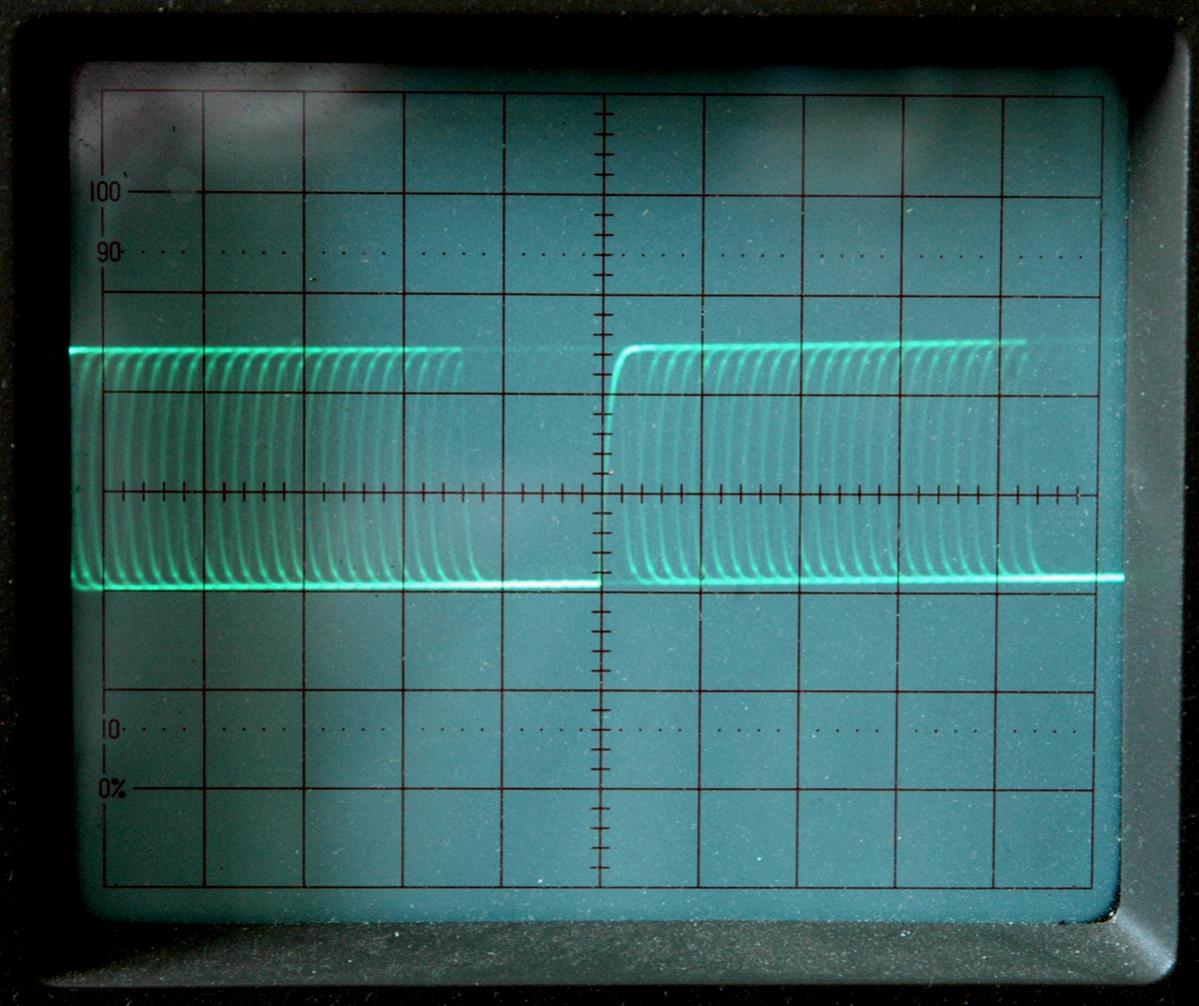

DOL or DOR oscillogram ( on Pause) :
DOL or DOR oscillogram ( on Play ) :
Although I am not a great technician ( what VCKO and BCKO mean !!), I think that reading the DOL and DOR waveforms, the Digital Filter Board should be considered as OK
So, remains the DAC PCB ! More so as, from it, nothing comes out
Please, what do you think ?
Raymond

Digital filter board outputs - pins DOR or DOL ( pause condition ) R.jpg112.5 KB · Views: 650
Digital filter board outputs - pins DOR or DOL ( play condition ) R.jpg137.6 KB · Views: 669
Some of the terminology can be a bit hard to decipher but it looks like BCKO (maximum bit clock) will be the main master clock input to the DAC's, the other waveform (the much lower frequency squarewave) looks more like the word or frame clock.
Without a circuit its tough going...
I would look at the data sheet for DAC that I linked to earlier and make sure these signals are arriving. Look at figure 3 in the data sheet. You need those three signals to be present (top left of fig 3). If that's OK then look where 'Iout' from the DAC goes. Its probably an opamp used as an I/V convertor. See if you can pick up audio on the output of that opamp.
Without a detailed circuit its all guesswork though.

Hi MOOLY,
I will do as you said.
Sure now :
- no problem with continuity ( from Digital Filter Board outs ) for BCKO, WCKO, DOL & DOR ; 3 signals are present on the DAC Board at the entry of the 4 PCM1704 ( pins 2, 7 & 1 ),
- but only with one of the 4 PCM1704 ( ic U1 ) I find "Iout" OK ( pin 14 ),
- for U2, U3 & U4, no signal "Iout".
- there is no opamp after these 4 DAC. Only the four Audio Boards.
Hence, the most probable conclusion :
- 3 dac BB PCM1704 ( U2, U3 & U4 ) are out,
- unless ( possible ? ) a control circuit ( pins 9 & 10, marked " digital controls ") inhibits the operation of PCM1704 ?
- in the lack of schematic, impossible to be sure.
I think I have better to go for a swim in my pool !!
Thanks again for your help.
Raymond

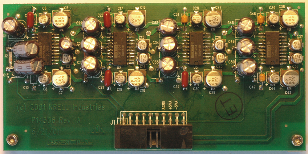

Hello MOOLY
I picked up signal 'Iout' ( from DAC PCM1704 pin14 ) on the AUDIO BOARD, at their inputs
And only one dac ( U1 ) of the four gives something.
I think U2 U3 & U4 are dead !
For what reason ?
Because it seems very strange that 3 ics dac can fail !!
Without Krell detailled circuit, impossible to go further !!!

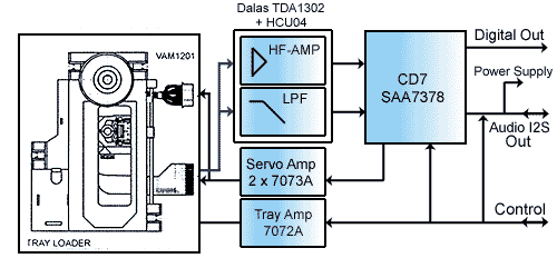

The used loader model is "Short Loader" (ECO-SL), probably MK-3 - also in use in the Philips Model CD753 - go to service manual under
https://archives.doctsf.com/bibliotheque/schemas_par_marque/Philips/CD753_compressed.pdf and the attached pdf files.
from an old brochure (from 2001) of Digital Audio Industrial Supply (DAISY) I have found and copied this description:
Technical information on the Short Loader MK3 from DAISY Laser:
The Short Loader module MK3 consists of a compact tray loader and an electronic board attached under it. A mechanism VAM1201 is enclosed in the loader. The VAM1201 is a modular CD-mechanism, using 2-stage, 3-spot system, and mostly intended for the audio domain.
The application includes the CD decoder and digital servo IC ‘CD7’ (SAA7378, derived from SAA7372) which ensures integrity of audio data retrieved from a disc. This can be achieved because of excellent decoding performances (66MHz data slicer !) and unique error correction system which allows to play back slightly damaged discs (black dots, scratch,…) and compensate for external shocks. The module has successfully passed many playability tests, particularly with low and high reflection discs and test dics with blacks dots and fingerprints.
The Short Loader MK3 can now read CD-ReWritable discs, besides the usual CD-DA (audio) and CD-R discs. CD-R and CD-RW have to be finalised, which means that the TOC (Table Of Content) has been written onto the disc. For this purpose, the Short Loader MK3 has been equipped with the Dalas TDA1302 diode amplifier which has been added to the usual HF amplifier based so far on a HCU04, in order to amplify the reflected signals from the disc (CD-RW discs have indeed a reflectance range of 5 to 20% only). Please, refer to the first issue of the technical bulletin ‘Laser’ for more information on CD-ReWritable technology.
For a superior audio performance, the I²S (or EIAJ) signals (bit clock, word clock and data) are available on a connector and can be used with an external D/A converter. A crystal is now on board in order to ensure an accuracy of +/- 150 ppm minimum (up to +/- 50 ppm) instead of 2000 ppm for the previous ceramic resonator. Such an accuracy allows to use nearly all D/A converters or DA-I/O with optimal performances. Besides, the transmission of the audio data can match the requirements of the external DAC by changing the number of bits, the sample frequency or the audio format by sending a simple software command.
The control interface is based on the DSA standard which allows to easily develop a customised user section, since high-level commands can be used (like play, stop, search…) while all the servo decoding functions are already optimised in a DSA microcontroller. The DSA microcontroller is delivered with the Short Loader MK3 but has to be implemented on the user board. The DSA standard also means that previous user software based on this interface (and consequently the complete user display section) can be used with the Short Loader module MK3. A good solution for evolution of CD systems. More information on the DSA interface can be found in the first issue of the technical bulletin ‘Laser’.
Beside the I²S signals, a digital output is also available on a specific connector. The output format is according IEC958. The crystal accuracy allows a very good transmission. In case of a coaxial output, a digital transformer can be used on the user board.
Since the Short Loader MK3 CD module is based on the standard DSA bus, it can be used with the CD Evaluation Board 2, which can drive any module based on this interface (CD-Pro, Premium 7050, Premium 7051, SL MK2, SL MK3,…).
