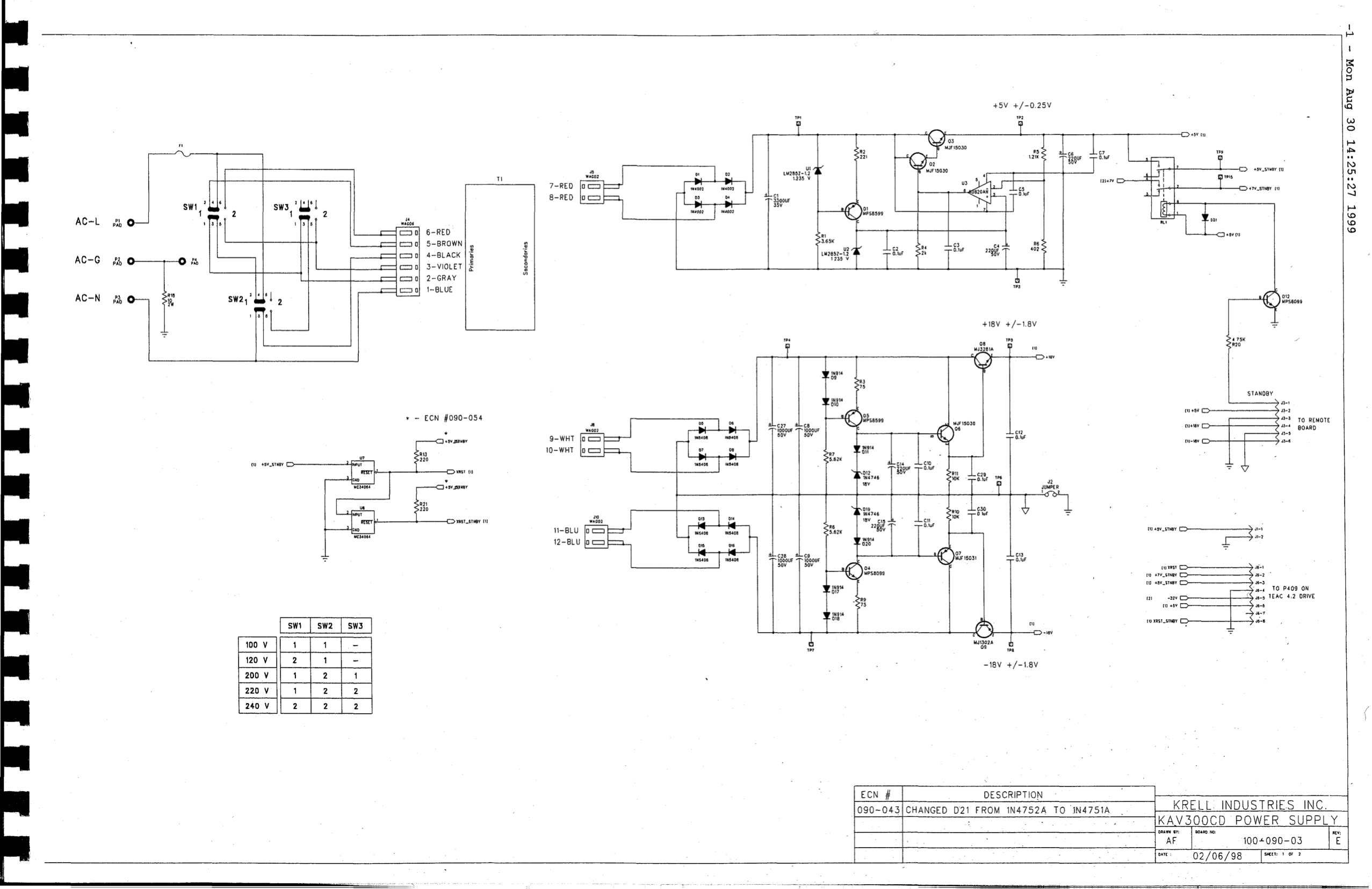

Ive managed to get a copy of the Service Manual which i have attached
On looking at these diagrams they are all paired off except for 16 purple do you know what this does and voltage? 30v?
16 Violet do you mean ? That is tied to the negative 30 volt rail (which will be for the display) via a zener to 'float' it. Fairly typical practice.

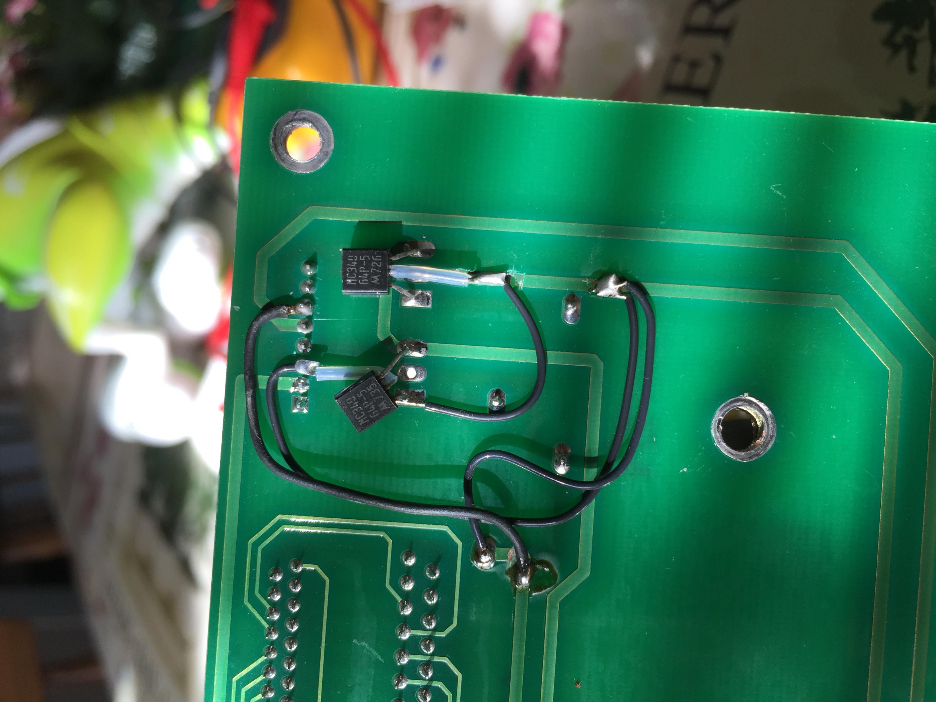

The 'repairs' actually look like production modifications tbh. Its not uncommon at all to see things like that.
