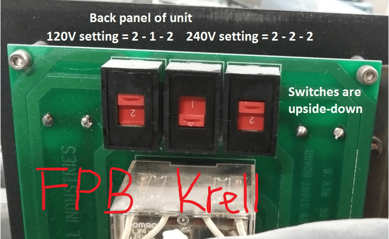

I would like to ask how to adjust the voltage of Krell FPB and KAV 250A to 110V
I probably wouldn't use 110V as the FPB requires 4000-6000W to reach its capabilities.
But I need to know it.
If you have these two machines (110V), can you turn them on and take a look?
Many thanks!
What I can do is give the original factory information to those in need.
