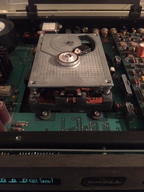

Any suggestions on what might cause this cdp to not be able to read a disc until it has warmed up for like an hour? The case must be warm to the touch before it will return something other than disc error. I've checked all the board and transport connections and have gone over the PCB's looking for cold solder joints. This thing must be built to MIL-SPEC, very impressive indeed.

Just registered to say thank you
Mine had the exact same symptoms and the 33uF cap was the culprit (only measured 19uF). My friend suffered with this problem since he bought it used in 2008!
In the other CDM thread people were talking about adjusting the pots (one guy said 750, another 243 which is a huge difference). Not sure I needed to go there. The cap was the real fix but I did mess with the pots a bit.

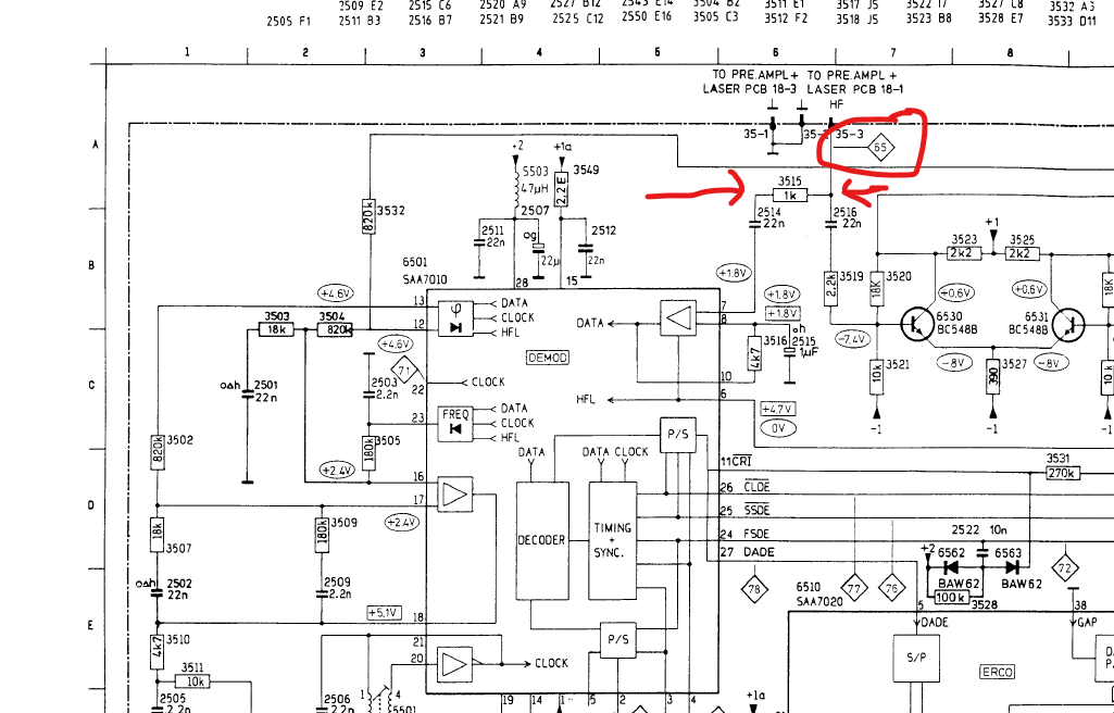

Philips were always convoluted in their adjustment procedures and a quick and easy check is just to look at the RF on an oscilloscope and confirm it is within the normally accepted 1.2 to 1.5 volts peak to peak.
Krell put stickers on all the chips but I can see TDA5709 on the bottom of the optical reader so I assume it’s a 5708 on the same circuit. Unfortunately all the parts are buried underneath and they are surface mount so it will not be possible to measure any voltages while it is playing, unless it’s on the DAC side.

In practice you should be able to pick the RF up 'by just poking around' with the probe, even if you can't identify specific points... and always use a proper divider probe that is properly compensated. A standard x1 probe has quite a lot of capacitance that can skew the result.
You might also be able to tag a short wire to the point of interest and so connect the probe there.
