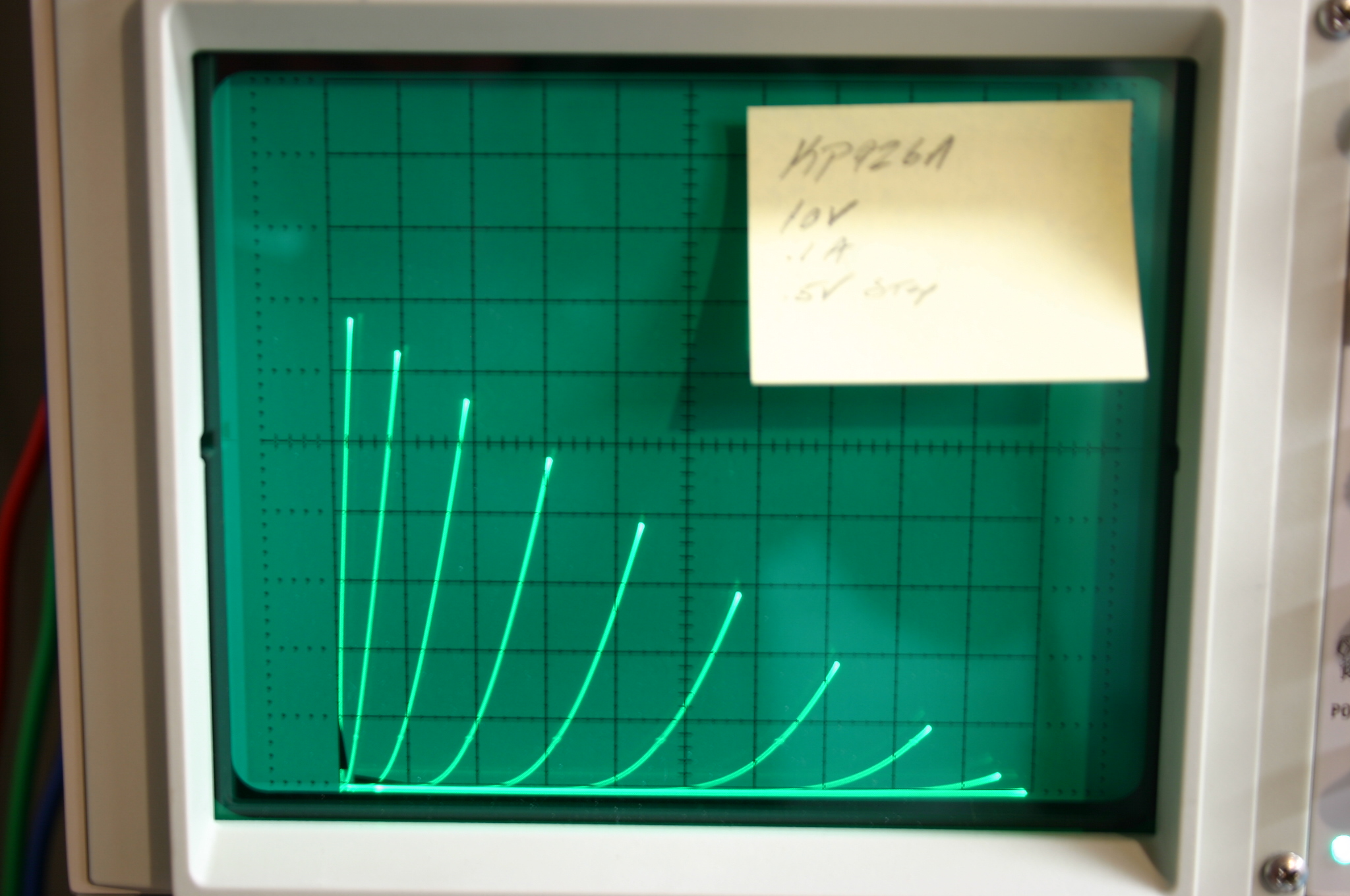

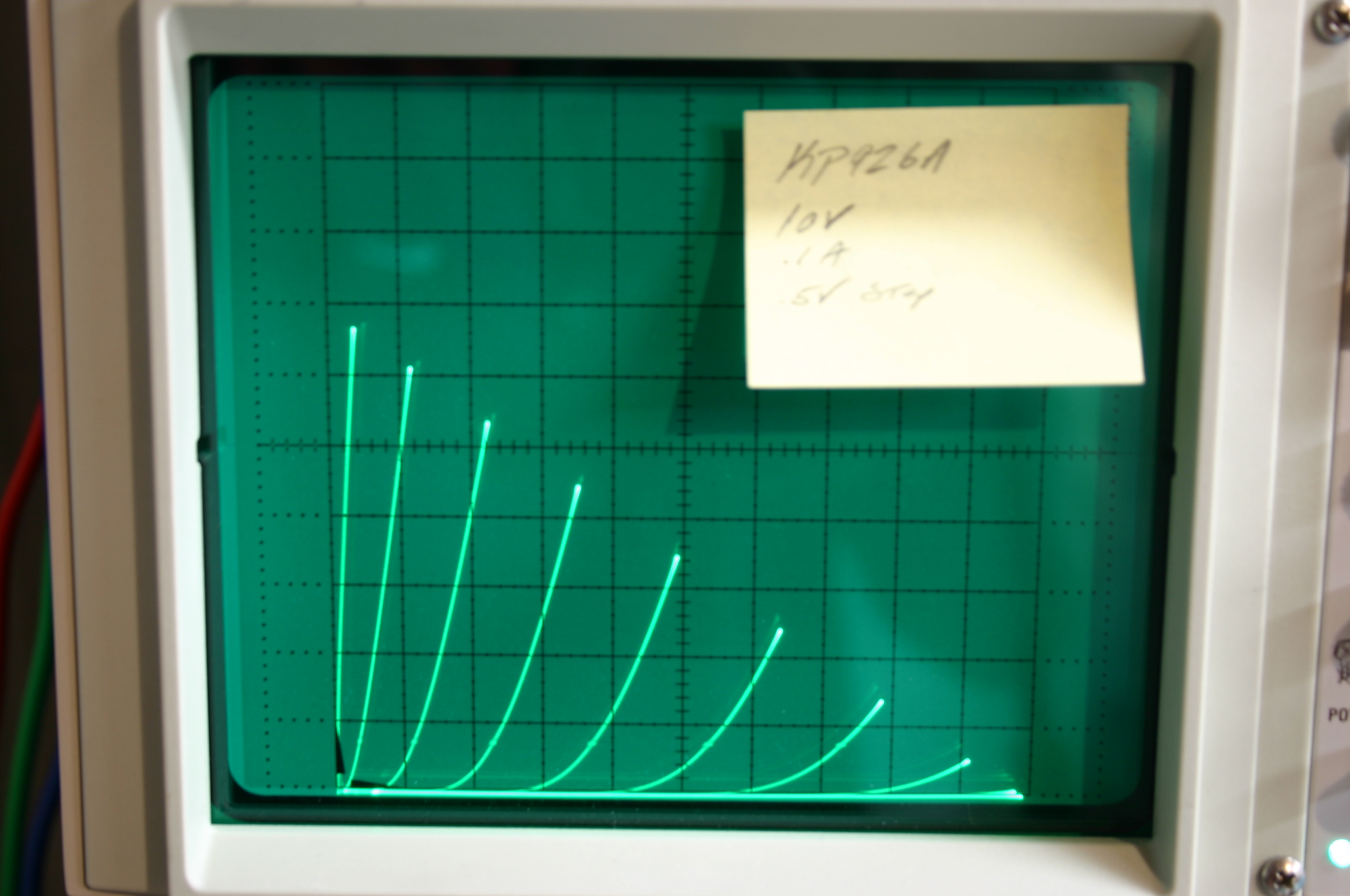

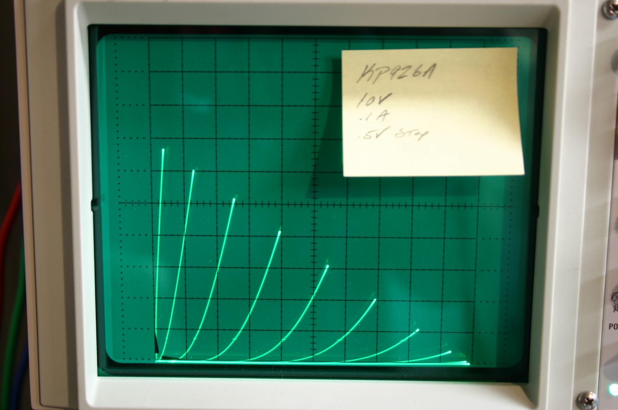

I recently purchased and received parts from a Russian seller of KP926B. The curve tracer says that they are all genuine SITs.
The reason I am interested in these parts is for the 400V Vce. They may serve well for an electrostatic headphone amplifier.
They devices are widely different from each other. You would need a large population to obtain a matched quad. Even one matched pair will require quite a few devices.

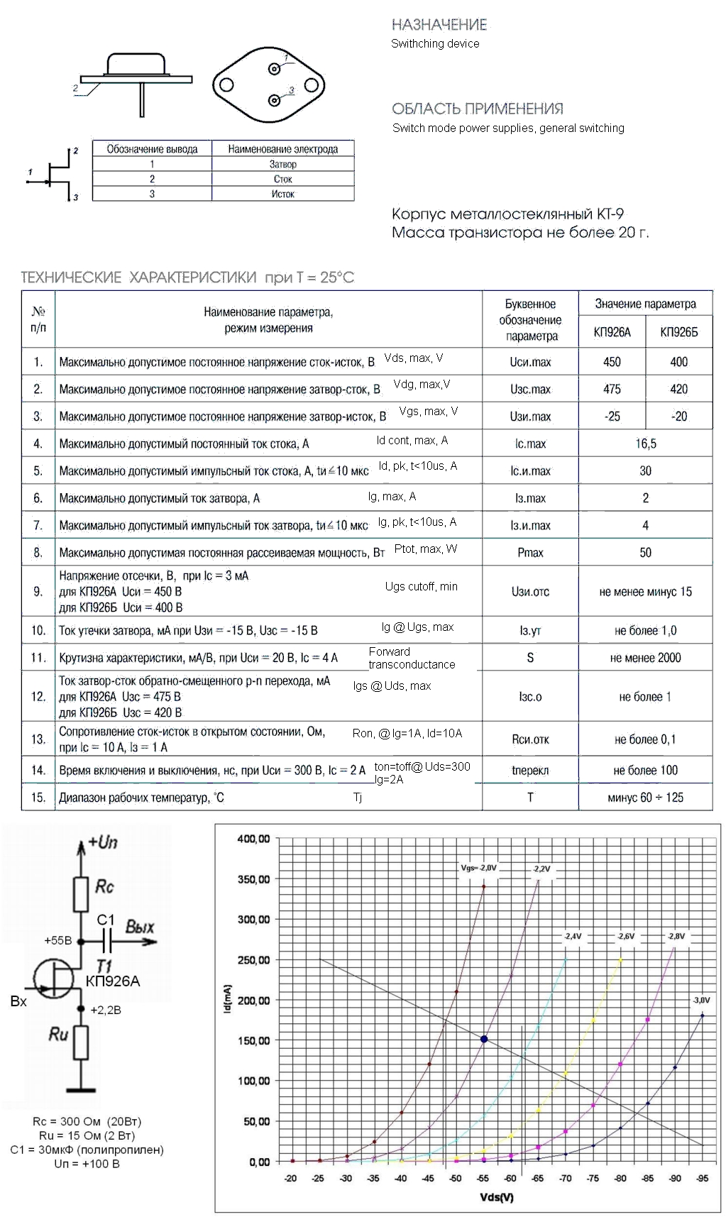

I spoted those too and found the data sheet on them but it's in Rusian. Did you measure the MU or can you read this data sheet ? And what seller did you get them from.

They report transconductance at 20V 4A on their datasheet. Mu would be the transconductance times the drain resistance. However, this figure is of dubious merit since, as you observed, there is some variation from part to part and ultimately you would want to figure the mu in the area of interest for your particular sample. 🙂

Look, I used to work with those back then.
With all do respect you can't use RdsON in DS cause it's measured with sic! gate current.
So one need to measure resistance at operating point by varying drain voltage a bit, for instance.
