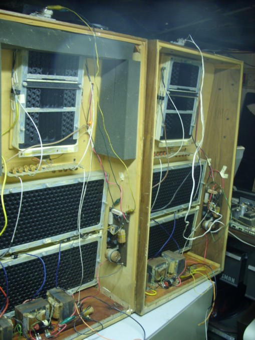

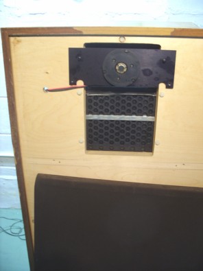

I've found them to be high manufacturing quality - no problems with diaphragms either - but a deeply flawed overall concept/design.
They were sold as an (expensive) Electrostatic but had a hidden (grille attached w/ rear screws) Philips dome tweeter to take over from the E/S HF module that rolled off above 3khz !

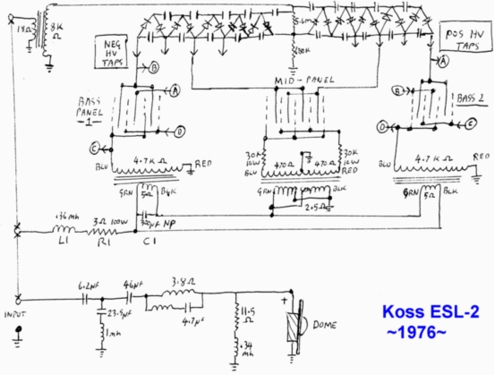

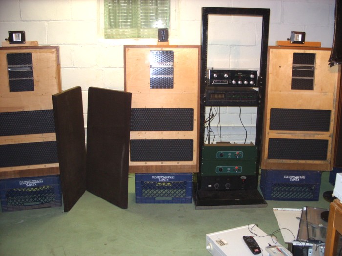

Even tho the Koss factory is near me, they would not give me any info on the 3 old speakers I found, so I traced out the schematic myself.
Does anyone know what the bias voltages were? I found a 1975 BAS meeting report that says it was only 7.5 kV for the bass panels, whereas about 18kV would be optimal for their very wide air gaps (about 0.3" stator-to-diaphragm), so this would seem to have more than wasted the gain from using multiple diaphragms. The same report also indicated that the diaphragms were of polyethylene, which seems unlikely and contributes to my doubt about the reported voltage.
As you can see from the schematic I posted, they used a step-up xformer & a 10X voltage multiplier to supply bias from the speaker drive signal. I found this to be inadequate as the 3 sample speakers I tested had weak output from the bass & MF panels making the speakers sound ridiculously bright from the dynamic tweeter. The bias generated peaked at less than 600v. This, coupled with the HF roll-off of multiple-layer panels made for a 'perfect storm' of failed performance.

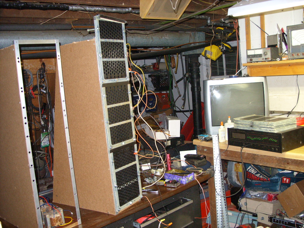

When I separated the layered panels and applied 2.5kv bias from external PS, I got normal output and hi freq response as can be seen from my homemade version. Note additional dismantled HF panel elements next to TV set.
