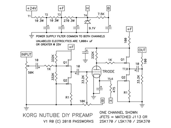

What would be the effects of using a 100k pot instead of the 50k pot for the vol control.
Source impedance is only around 600r
In principle, no big deal.
For a better image, we need the load impedance, what is its wiper driving.
Remember to use same taper as original one, which I suppose is Audio/Log
If you look at the early part of this thread, there is lots of discussion about the effects of the volume pot and impedance loading in general:
https://www.diyaudio.com/community/threads/b1-buffer-preamp.124889/page-46
cant seem to find, reason for asking is i have a DACT CT2 100k lying around any reason i cant use it
