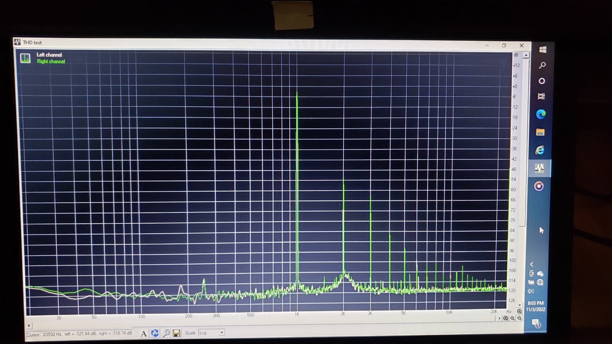

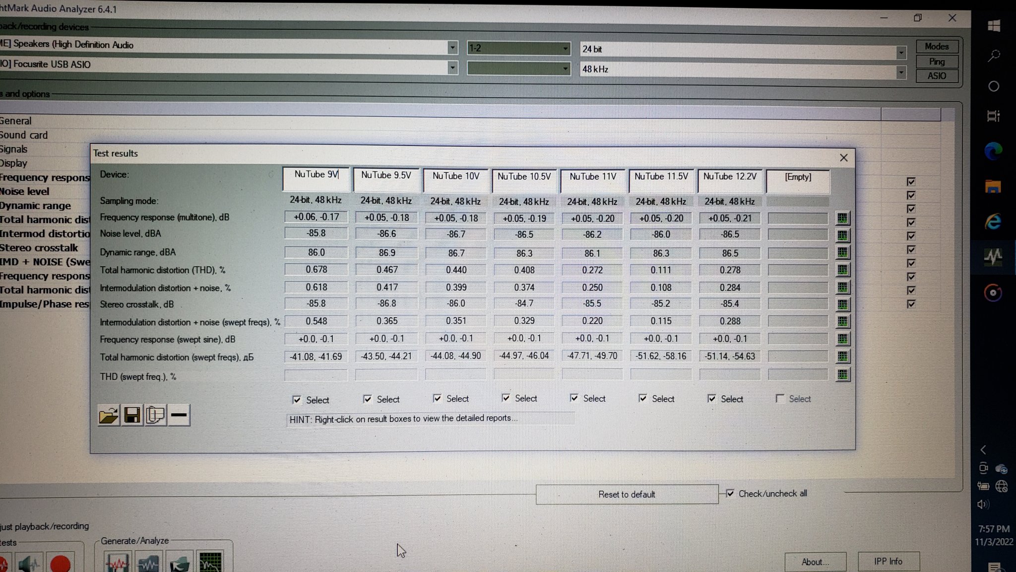

I measured distortion from 9 volt to 12 volt in half volt increments. Distortion is decreasing with increasing voltage.
I can measure spectra for harmonics, but i am not setup to measure weather 2nd is positive or negative.

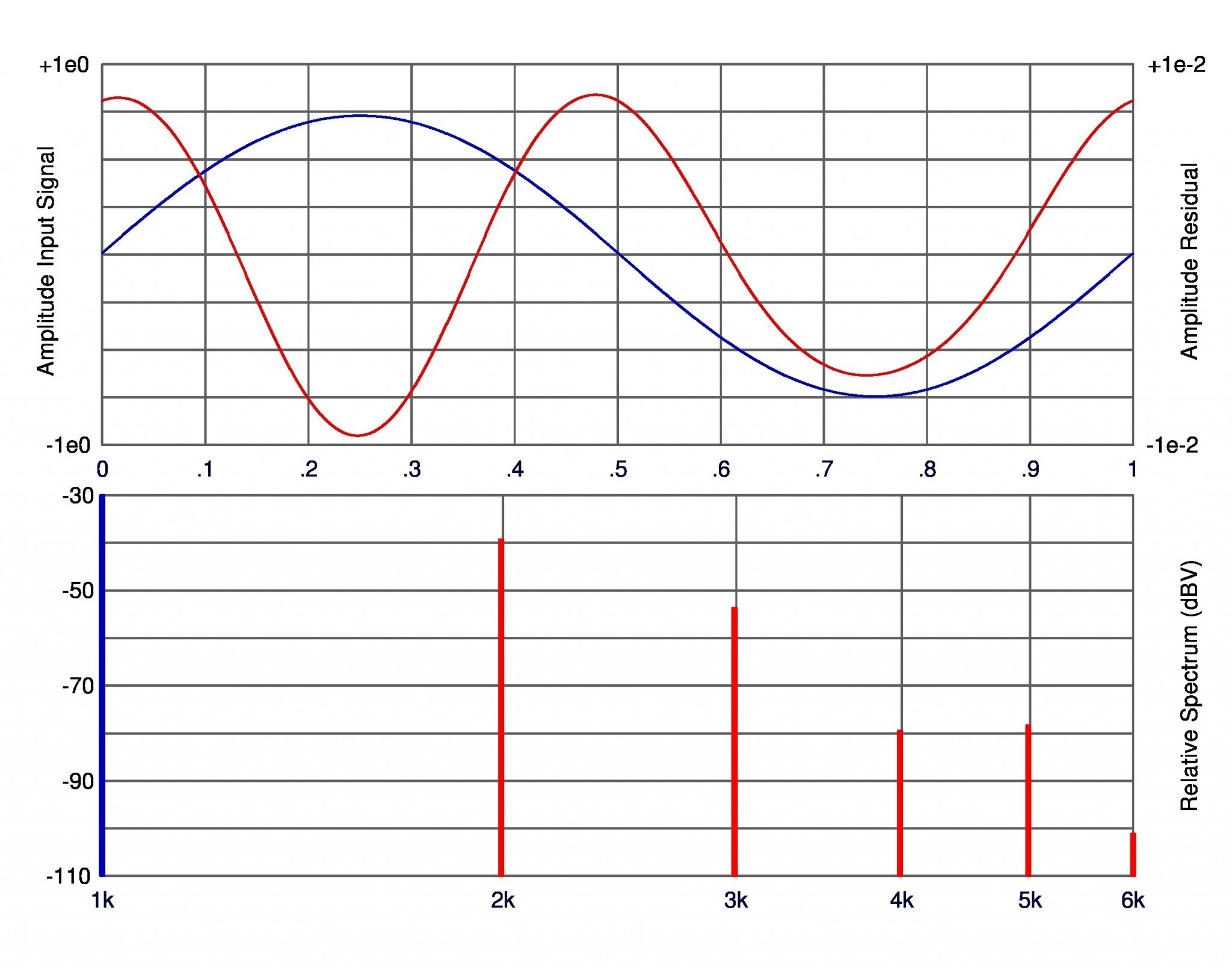

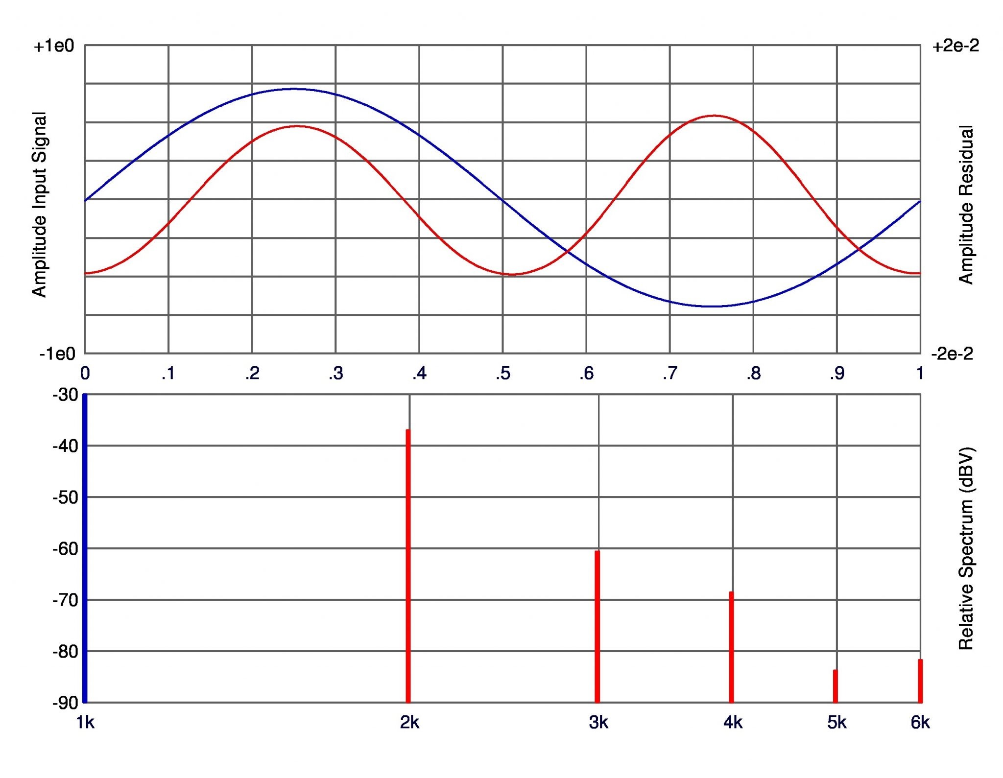

With 9.5V @ 1Vout (first photo) the second harmonic is 37 dB below the fundamental (1.41%) and 24 dB above the third. If you look at the two positive peaks of the red residue, you see that they are aligned with the positive and negative peaks of the blue fundamental. This indicates that the residue is mainly due to the second harmonic and that the latter has a positive phase. The graph then shows a 2H +. At 12.6V @ 1Vout (second photo) are now the two negative peaks of the red residue which align with the positive and negative peaks of the blue fundamental. The residual indicates a second negative harmonic. Hence 2-. Note that with the last operating point the distribution of harmonics is a little different. If we continue to move it along the load line, with always greater Va, the spectrum worsens rapidly. A sign that 12.6 V is close to triode saturation. Perhaps it is for this reason that Pass indicates 9.5 V as the reference setting of the project and to reverse also the polarity of the speaker to test the negative phase. In this way the positive polarity at the preamp output becomes negative on the speakers.
