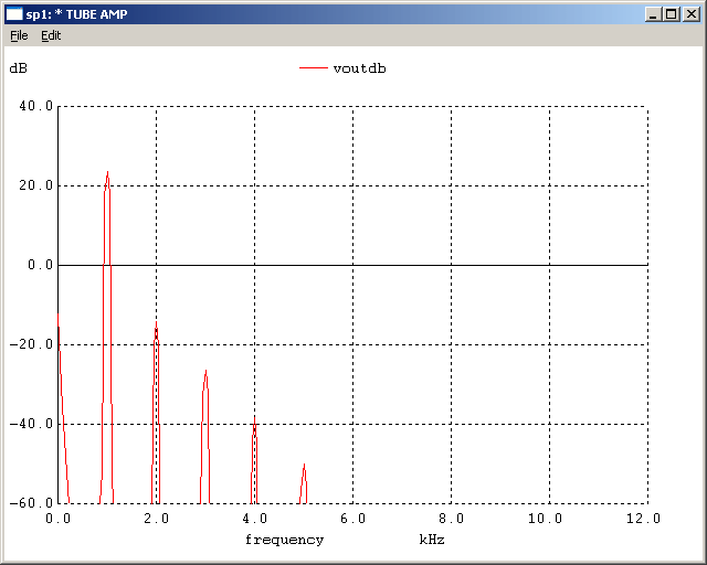

Sorry, fscarpa but this does not work on WinSpice
Code:
* WinSPICE Auto run
*#destroy all
*#run
*#fourier 1000 v(5)
*#linearize
*#spec 0 20000 50 v(5)
*#let voutdb=db(v(5))
*#plot voutdb
*#setplot op1
*#print v(5)*va2#branch
*#print (v(9)-v(5))*va2#branch
*#print (v(8)-v(3))*va1#branch
*#print (v(3)-v(4))*va1#branch
*#rusage everything
c1 in g1 3.3uF
x1 a1 g1 k1 k845rca
rk k1 0 1
rg g1 b1 20k
x2 p1 a1 ou 0 LL1620_90mA
va p1 0 1100v
vp b1 0 -130v
vin in 0 dc 0 ac 100 sin(0 100 1000)
*vin 1 0 dc 0 ac 0.5 sin(0 1.0 10000)
* vin 1 0 dc 0 ac 0
rl ou 0 8
*vout 10 0 dc 0 ac 1
.op
*.print dc V(3) v(5)
*.print dc I(rk)
*.print dc I(rs)
.ac dec 10 5 1E6
*.PLOT AC v(2) v(3)
.tran 5000NS 20000US 0uS
*.tran .2n 2000n 0
*.FOUR 10000 v(3) v(5)
.SUBCKT LL1620_90mA 1 2 3 4
ra1 1 5 308
la1 5 2 40H
ka1 la1 la2 1
la2 6 4 0.0277H
ra2 3 6 0.2
.ENDS
.SUBCKT k845rca A G K
+PARAMS: MU=5.355 ERP=1.5
+ KK1=6323 KP=85.64 KVB=65.8 vg0=3 va0=0
+ CGA=13.5E-12 CGK=6E-12 CAK=6.5E-12 RGI=1000;
E6 6 0 VALUE={KP*( (1/MU)+((V(G,K)-vg0)/sqrt(V(A,K)**2+KVB**2)) )}
E8 8 0 VALUE={(V(A,K))/KP*LN(1+EXP(V(6)))}
*.param V_6={KP*( (1/MU)+((V(G,K)-vg0)/sqrt(V(A,K)**2+KVB**2)) )}
* E8 8 0 VALUE={(V(A,K)-va0)/KP*LN(1+EXP(V_6))}
Eam am 0 VALUE= {2*Pow(V(8),ERP)/KK1}
GA A K VALUE={V(am)}
D3 5 k DX ; FOR GRID CURRENT
R1 g 5 {RGI} ; FOR GRID CURRENT
Rak A K 1G
Rgk G K 1G
C1 G K {CGK}
C2 G A {CGA}
C3 A K {CAK}
.MODEL DX D(IS=1N RS=1)
.ENDS
ERROR: File 'final.cir' line 64:-
B:x1:B_E6 x1:6 0 V=8.5640000000e+01*( (1/5.3550000000e+00)+((v(g1,k1)-3.0000000000e+00)/sqrt(v(a1,k1)**2+6.5800000000
e+01**2)) )
=> Node 'x1:6' has only one component connected
ERROR: File 'final.cir' line 65:-
B:x1:B_E8 x1:8 0 V=(v(a1,k1))/8.5640000000e+01*ln(1+exp(v(x1:6)))
=> Node 'x1:8' has only one component connected
Probably I have found the error because now it run, please check
Code:
* TUBE AMP
* WinSPICE Auto run
*#destroy all
*#run
*#plot v(ou)
*#fourier 1000 v(ou)
*#linearize
*#spec 0 20000 50 v(ou)
*#let voutdb=db(v(ou))
*#plot voutdb
*#setplot op1
*#print va#branch
*#print v(a1)*va#branch
*#rusage everything
c1 in g1 3.3uF
x1 a1 g1 k1 GM70
rk k1 0 1
rg g1 b1 20k
va p1 0 900v
vp b1 0 -80v
vin in 0 dc 0 ac 90 sin(0 90 1000)
rl ou 0 8
.op
.ac dec 10 5 1E6
.tran 5000NS 20200US 200uS
ra1 1 5 308
la1 5 2 40H
ka1 la1 la2 1
la2 6 4 0.0277H
ra2 3 6 0.2
.ENDS
E1 7 0 Value = {(V(A,K)/KP)*LN((1+ EXP((KP/MU) + ((KP*(V(G,K)+.5))/(SQRT(KVB+V(A,K)*V(A,K)))))))}
G1 A K VALUE = {(((V(7))^ERP)/KK1)*(1+SGN(V(7)))}
RE1 7 0 1e12
Rak A K 1G
Rgk G K 1G
C1 G K {CGK}
C2 G A {CGA}
C3 A K {CAK}
.ENDS
.SUBCKT GM70 A G K
+PARAMS: MU=8.037 ERP=1.5
+ KK1=4121 KP=182.25 KVB=34 vg0=-5.7
+ CGA=12.p CGK=8.p CAK=4.p RGI=1000
RE1 7 0 1e12
Rak A K 1G
Rgk G K 1G
C1 G K {CGK}
C2 G A {CGA}
C3 A K {CAK}
.ENDS
