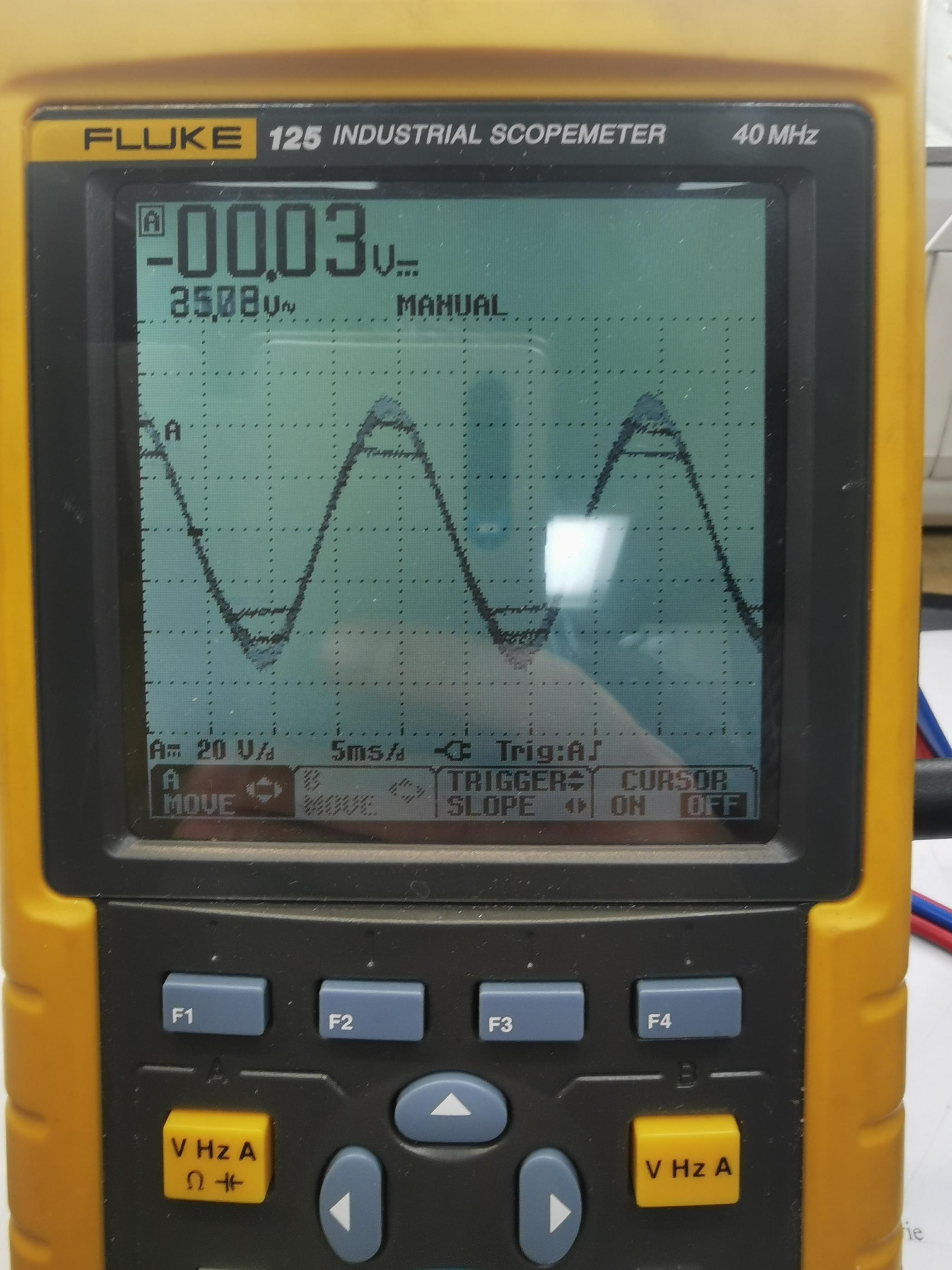

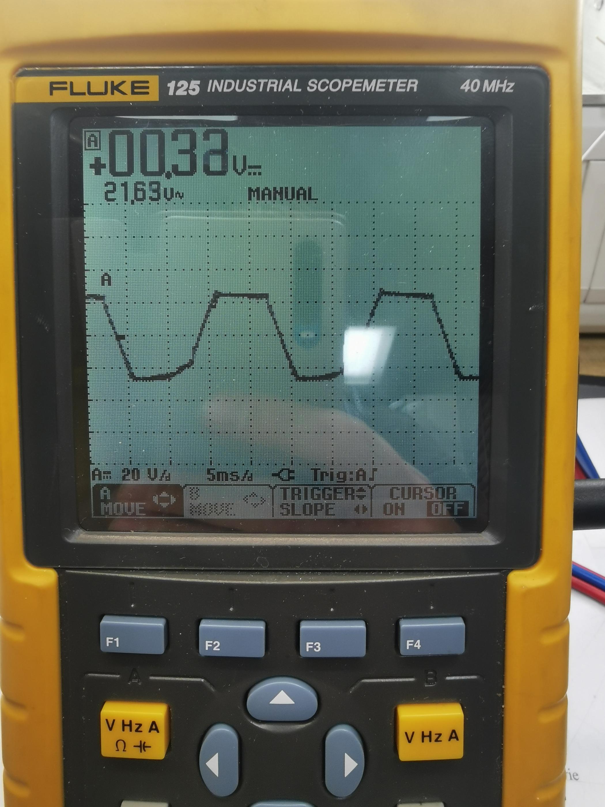

I have this 2k zenon amp here. It seems, it works fine..i have on each mosfets audio and ps a good signal. The amp needs about 7 amps to start,
then it idle at 3.3 amps.. If I use a power supply with only 5 amps, it won't power up fully, but all signals are there. Voltage drops at my bench supply to 7v..
With a bigger supply no problem. If I use a resistive load 4 ohm and inject 50hz,also everything looks fine. If I increase to clipping, or better to the fully 30amps from my bench supply,
The rail voltage breaks massive down. Even if I just touch the limit of my bench supply, the rail drops more then the half of voltage.. What could cause this?

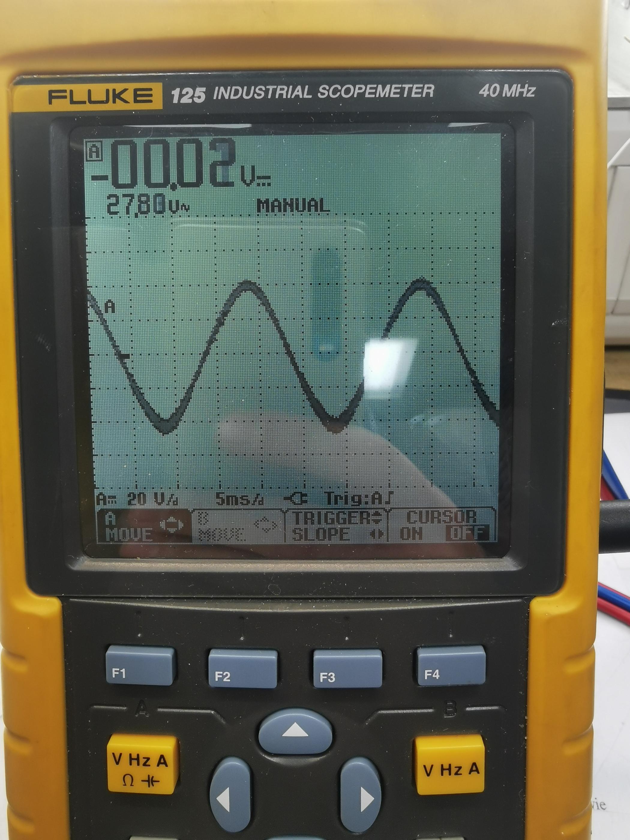

Here are some pictures.. It's a slightly move on the gain, the current increase just to the limit of the supply, than the rail drops.

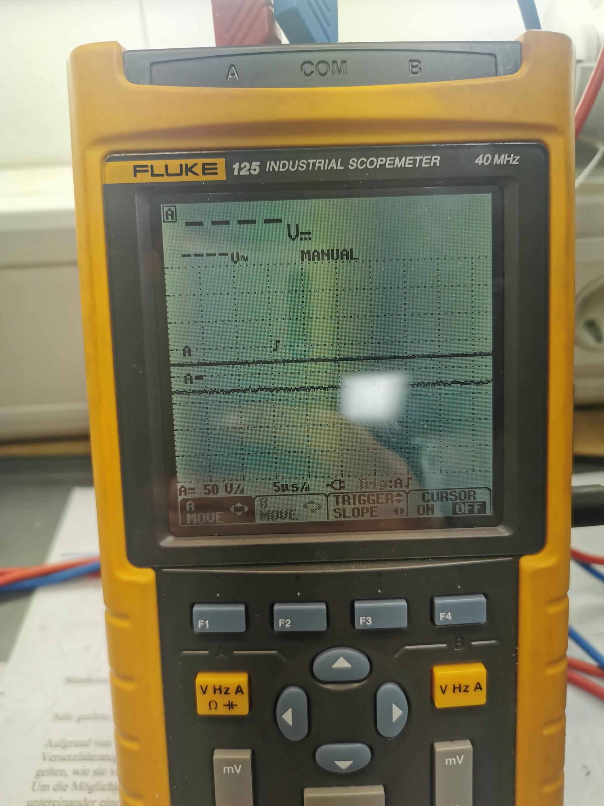

The voltage drops from 14.4 to 10v..i checked each output mosfet, signal is there. I checked on each output inductor..
Signal is good. If I go beyond the limits of my supply, it seems that the amplitude of the output is gone..
The measure is taken from one output inductor, input voltage down to 10v.
