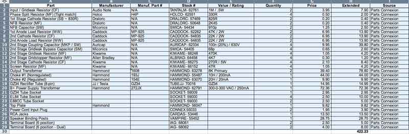

Cool! Attached is a tentative parts list. Any major flaws?
Kofi
Kofi,
I would suggest 2W resistors for the 47R Screen Resistors.
Did'nt see ECC88 or EL84 Tubes listed - JJ Electronics perfectly OK for these too.
Ian
The 47Rs are actually 2W jobs-- should have detailed that. Also, I already have the EL84s and the ECC88s-- they're all JJs.
Any other issues? I know there's a catastrophic one in there somewhere. Its me, after all.
Kofi
