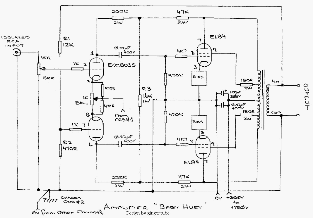

Hey!
So, after much deliberation and dumbassedry here (http://www.diyaudio.com/forums/tubes-valves/165359-kofi-annan-pushed-pulled-back.html), Kofi has decided on the Baby Huey design for a friend's amp.
Attached is my current BOM. I know I've included some parts that many would consider "boutique" or perhaps "audiophool", but I'm still pretty stupid these days and since I've used these parts before with success, I'm reluctant to change.
So... more posts to come, but any feedback on the current BOM would be helpful.

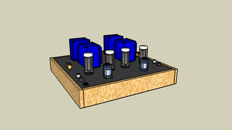

Google Sketchup-designed top plate and layout to follow.

I'm not sure if you are aware that there was a later schematic with mosfet source followers to drive the output tubes, and fixed bias on the output tubes. The Baby Huey (and it's predecessor by Yves) has intrigued me ever since I first read about it, I am so curious I really must do myself a favour and build one at some time.
Ian.
Ian.
Kofi,
I second Ian444's advice to check out the later BabyHuey variant with fixed
bias and mosfet followers. I checked this version out in a test-bed and found it
to be more effortless & dynamic in the bass. Hence i'm building my 2nd BabyHuey according to the fixed bias version.
The original BabyHuey is my "daily-driver", it's an excellent choice too, it's
a bit simpler to build.
You won't be disappointed with any of the BabyHuey variants, as Gingertube said: It's simple to build but hard to match.

another huey, marvellous.
My huey constantly impresses those who get a listen.
when picking parts, i found that the sound is senstive to the bypass caps in the el84 cathodes. do spend here.
I would also say, the 6p14p-ev (ev is important) are the best output tubes you can buy under £20. Bloody marvellous.
Also, any reason (other than cost) not to go for choke in the PS. IT makes it so much easier to tweak the B+ and leads to a lovely silent supply (with fostex 95db/w i have zero hum with a choke input).

Yes!
Well, I can't really explore fixed bias at this time as I'm making this for a friend who wants a no-fiddle amp and would like to tube roll at some point...

40ma or so for each el84 + not a lot at all for the rest, so yes, 200ma is about right for the whole amp.
I used a 15h hammond choke. pros and cons to both methods. You dual mono design would theoretically provide better channel seperation.

hammond 370hx (275-0-275 @2ooma) > full wave recitified but stealth diodes > 8.4u obbligato film cap > 15h hammond choke > 220uf > 20r per channel > 220uf per channel (bypassed by obbligato 0.22uf film).
it simulates as slightly overshooting on turn on, but in reality i dont see that, and it looks good on the scope. Its probably overkill, the old mullard PP amps had no where near the capacitance shown here and a smaller choke, but it doesnt hum at all.
layout shown here, choke at the front right, excuse the wonky tubes, that was an old pic and they are now straight. also please excuse the sex in the city boxset, thats the wife's.
my thoughts on the input valves. The ecc803s are ok, but from experience the triode sections can be very mismatched. If you can get hold of a pair, the techtube 12ax7 are superb but out of production now. The tjfullmusic 12ax7's also sound very good and wont break the bank.

Sounds like an excellent PSU, but unfortunately its out of my range for the project. I'd like to get a choke in there, but I could only realistically afford an 8H / 100mA Hammond for each side. Would I be able to add that to the original Gingertube supply? If so, would I need to add this between the 220uF and the 47R?
The $95 per pair 12AX7s from TJ are out of reach as well, unfortunately. I think these ideas will all work as upgrades, however...
Also, what are you using for OPTs?
