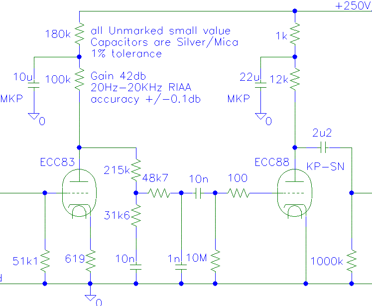

OK-- so I've been living with the hum for a while and I JUST CAN'T STANDS IT NO MORE!!!. I need to do a complete rewire of the project including proper grounding and an off-board power supply but, as usual, I need some advice.
Question 1:
When I move the PSU off board, how should I connect the rectified power to the chassis with the phono circuit? Should I use an XLR connector? If so, what connector would you recommend? Any ideas on the best source for such a connector?
Question 2:
Should I also connect the ground from the power supply to the ground for the phono circuit? In other words, should the power ground be one of the lines that is connected passed through the proposed XLR connector to the chassis with the phono circuit?
Question 3:
Can the power ground (for B+ droppers, anode load and related caps) and the signal ground (everything else) in chassis with the phono circuit BOTH be attached to the chassis or do I need to find a gound for them independently and then connect THOSE grounds together?
Question 4:
Since I'm using the center tap on the transformer to power the circuit, I have not grounded the PSU independently, i.e., there is no wire coming off the transformer that goes directly to ground. Is this wrong?

Konnichiwa,
Considering the voltages involved, do not use XLR. I use the Neutrik Speakon connectors in similar applications.
Usually - yes. It may be worthwhile to connect the earth to PSU ground using a few antiparallel diodes to "virtually disconnect" the earth unless fault conditions arise. Note that this is not fully compliant with electrical code in the letter, though it is in spirit.
Connect power ground to signal-star ground and the chassis to the input starground.

Kuei Yang Wang said:Considering the voltages involved, do not use XLR. I use the Neutrik Speakon connectors in similar applications.
Sounds good. So I will need three Speakons, right? One for B+, regulated filament supply and PSU ground?
Kuei Yang Wang said:Connect power ground to signal-star ground and the chassis to the input starground.
What is the input star ground? I'm thinking there will be two star grounds in the phono circuit box-- one for power (grounded here: the B+ dropper and anode load will ground through the final smoothing cap; the PSU ground from the PSU box, the filament and tube pin 9 ground) and one for signal (everything else).
The question is, since I'm grounding to the chassis, should each individual star ground be grounded to the chassis and then connected together by a ground wire, or should they be insulated from the chassis, then tied together at the chassis?

Konnichiwa,
Speakon is 4-pole, rated at 500V and many Amp's, so one connector is enough.
Not quiet. As I wrote a little further up, you should have a single point ground PER STAGE, build the PSU using a bus-ground system and finally tie all these grounds together at the output stage signle point gtound.
Yes, everything should be insulated from the chassis except for one wire connection.
You mean you use a full bridge rectifier? In that case you are fine with no direct connection of ground to transformer.
OKOKOKOK!! Got it, I think. So, to clarify, the 10u and 22u caps will ground to the PSU star ground along with the incoming PSU ground from the outboard power box. The 51K1 and 619 will be tied together in the 1st STAGE ground and the 10n, 1n, 10M and 1000K will be tied together in the 2nd STAGE ground.
These three independent star points that are shielded from the chassis will then be tied together and then tied to the chassis at a single point, probably an RCA jack ground.

Konnichiwa,
No, each of these capaictors connect locally at the cathode/cathode resistor of the respective stage they decoupled.
Nope.
10uF, 51K1, 619R, 10n & 1n and input RCA jack ground get tied to the first stage SPG (one SPG for both channels!!!).
ECC88 cathode, 22uF, 10M & 1M (1000K) and output RCA jack ground get tied to the second stage SPG (one SPG for both channels!!!).
PSU ground from external PSU gets tied to 2nd stage SPG.
Chassis gets tied to 1st stage SPG.
1st stage SPG gets tied to 2nd stage SPG preferably with a piece of flat silver or laquered copper.
Heater supply negative line (which should be DC and well filtered) gets tied to the 2nd stage SPG.
All signal/heater/psu circuit section parts are completely insulated from the chassis except for the connection of the Phonostage Chassis to the 1st stage SPG and the connection of the PSU Chassis to Earth and to PSU (+B) Ground via a pair of anti-parallel diodes.
The anti-parallel diodes (need to be high current!!!) normally break the connection between chassi and earth, UNLESS the potential between chassis and earth becomes > 0.5V, in which case they clamp the fault voltage to < 2V untill they short out from overcurrent.

Kuei Yang Wang said:No, each of these capaictors connect locally at the cathode/cathode resistor of the respective stage they decoupled.
Uh... yeah... that's what I meant.
Originally posted by Kuei Yang Wang
Nope.
Steeeee-rike two!
OK. Got it.
Makin' sense!
Time!! Here's the deal-- I have a regulated DC supply for the filaments with a trimpot sos I can set the voltage wheres I wants to. When you you say the "negative supply", I'm thinking "ground", which I'm sure you're going to say is really the negative supply, right?
That would make sense to me, but I just wanted to confirm it.
OK. Getting blown away here with the anti-parallel diodes thingee. On the one hand, I'm thinking I could do without these and still have a perfectly acceptable grounding scheme. On the other hand, "anti-parallel diodes" sounds really Star Trekky and it would be cool to insert them into a conversation:
"Yeah: just your standard grounding scheme using anti-parallel diodes. Huh? Yeah anti-parallel diodes are pretty cool... Huh? Yeah... sure you can touch me where my bathing suit covers..."
So, in an attempt to keep this simple, are these diodes a requirement or can I make this work OK without them. Sorry to seem lazy, but I'm working on a pretty steep learning curve as it is, as you are aware...
Also, should the decoupling caps / anode load / B+ dropper be some distance away from the tube socket as they are carrying some high voltage or is closer to the socket the way to go?
One more thing-- will these work for power speakon interconnects? They seem relatively cheap and I wonder if their performance will suck or be unsafe for a power application.

Konnichiwa,
Yup, I tend to avoid the term "ground" it is a convenient fiction but in reality there is no "ground".
Sweet and simple. The earth connection is needed for safety, but is the chief source of hum-loops (often called "Earth Loops"). So ideally you have no connection at all between the signal circuit and mains earth.
By connecting a pair of diodes (which require at least 0.5V to conduct any current) you more or less disconnect signal ground and earth, except when a fault condition exists, which is what the earth connection is intended to protect against.
Allways consider the loop in which the signal current will flow. You want these loops as tight (short) as possible.
They will be fine. Speakon connectors have a inherent design that is safe, making all metal parts carying voltage tough proof and they are locking, so various little house pests cannot dislodge them easily. The cable used to carry the voltages of course also needs siutable insulation.

Kofi Annan said:Time!! Here's the deal-- I have a regulated DC supply for the filaments with a trimpot sos I can set the voltage wheres I wants to. When you you say the "negative supply", I'm thinking "ground", which I'm sure you're going to say is really the negative supply, right?
Kofi Annan said:OK. Getting blown away here with the anti-parallel diodes thingee.
Kofi Annan said:Also, should the decoupling caps / anode load / B+ dropper be some distance away from the tube socket as they are carrying some high voltage or is closer to the socket the way to go?
Kofi Annan said:One more thing-- will these work for power speakon interconnects? They seem relatively cheap and I wonder if their performance will suck or be unsafe for a power application.

Seems like a nice solution to isolation. You mentioned earlier in the thread about it not meeting the letter of safety regs. It would seem that the only way to have an unsafe situation would be for a diode to fail open. I would guess that's rare?
Sheldon

Konnichiwa,
Yes, it is rare. In many years I have yet to see to se a semiconductor diode or the like fail open. They invariably fail by shortcircuiting. Using a diode bridge rated at 10A+ should not fail at all untill the mains fuse blows out.
So, while the UL (Underwriter Laboratories) would not certify such a solution, in practice it is perfectly safe.

Thanks,
I figured as much. I actually tried it on a chip amp I have been using for testing some multi amp speaker designs. The amp was giving an extra mv or so of hum with certain sources. The diode trick eliminated that.

So, is there such a thing as an "antiparallel diode" or do you mean that any high-current Schottky diode will do, but connected in a certain magical way? Like:
PSU SPG ==> K - A ==> A - K ==> Chassis
There's probably about nine things wrong with the above statements, but hey-- I'm going for a record. Please correct and admonish as required.

Schottky diodes are a poor choice in that particular application. Normal "slow" diodes are better. And the connection is not magical, simply Anode of one Diode to cathode of the other on both ends, thus the diodes are in parallel but in opposite directions.
If I interpret this right, yes.
BTW, consider just buying one speakon plug and socket and attach the cable fixed on the powersupply, this may be still cheaper.

I would think something like the common-as-dirt 1n400x should do fine. If you're passing more than 1 amp to ground, the rectifier will short, so it's just a wire then and your mains fuse will burn. Your chassis should be connected directly to the mains earth.
Looks like what you've drawn is series. You want parallel:
electronics star: anode cathode :chassis ground
: cathode anode :
Sheldon
