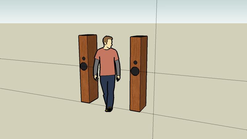

Have some better domestic dimensions for the FF225K BIB:
10" wide, 18" deep. Use the original 70" height with driver 39" from the base or it'll be too high to be at all sensible. Baffle terminates in the internal middle of the cabinet 7 12/16" from the floor and the inner rear and front baffle walls. I completed a pair like this a few days ago for a friend -just the thing for orchestras. I didn't add a tweeter -he's mounting one of those Fostex T90s I think (the ones in the neat pod) on a little extension on the side, firing forward. 24AWG wire at least, preferably 30AWG to get the response down into line. Hyper-neutral? Nope. Did it make my hair stand on end in the recent Naxos recording of The Planets? Oh yes. K.T. Tunstall wasn't bad either (control yourselves, I know what your minds are thinking... ;-)

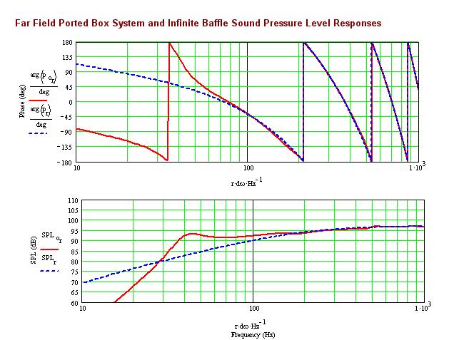

And this is the in-room response, with a BSC circuit in place. The anechoic response is deliberately sloping downward to account for room-gain, with a slight peak to add a touch of warmth or weight to the sound. It assumes a carpeted floor, with you sitting in the nearfield, on-axis with the drivers, the front baffle of the speaker cabinet (and therefore the speaker) 32" from the rear wall. As you can see -I'm still playing with Martin's new sheet... ;-)
The dip at circa 230Hz I assume (unless someone tells me otherwise) is floor-reflection, and should decrease in severity the further away you sit from the speaker, and also increase in frequency.
The BSC values for the cabinet as-is, calculated by MathCad, are pretty fierce: 2.5mH inductor, 10ohm resistor -I don't believe it needs that as most of use do not sit in the nearfield, on axis with the drivers. I would suggest a 2.5mH inductor, with perhaps a 4 to 6 ohm resistor as a good starting point as going through every combination would be a bit of a lengthy and pointless exercise. Also, note that you'd probably need smaller values if the speaker was closer to a rear wall.

I'll try to post a picture of the 225K BIB boxes soon. Two problems with that at the moment: 1) Scott doesn't even own a box-brownie, let a lone a digital camera (photography is not my forte I fear), and 2) they are now 60 miles away in Sheffield with the bloke I built them for. However, so you know, Simon is painting them white. They're at the sides of a wide bay window, in the corners, so they look like pillars. His wife's idea. Sounds mad, but she could have a point, and who am I to dispute interior decor with a young female? ;-)

Two and a half years later, Kofi found himself interested again in the Fostex 225K with the 17H tweeter. This, of course, after feeling the weakness of the US Dollar in his quest for the Supravox Signature Bicone here.
So, I'm thinking about picking this one up again with the idea that I'd go with Scottmoose's BIB recomendation:
The amp will be Thorsten's version of the 300b DRD in monoblock form. Given that I have a sizable living area, I need the bass, so I'm hoping the BIB will provide it, although the xmax of the 225K may be a limitation. The DRD will supply about 8 clean watts in theory, but in practice when sourced with a low output MC cartridge and a phono pre with gain on the lowish end, maybe a bit less.
