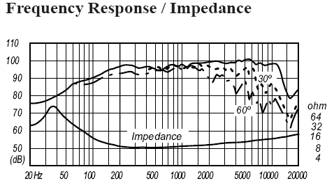

I think that the biggest problem with this driver is that it has xmax of 0.3mm so you can't expect much bass comming out of it.

Looking at the PDF, 9k is just under where the driver response drops off the chart. Not a completely bad place to hand-off to a tweeter! It is a good place to start, anyway.

HWV said:Looking at the PDF, 9k is just under where the driver response drops off the chart.
I'd say it's around 12k.

I've been tormented byt the 225 too in my past. As mentioned, the highs roll off about right for a tweet, which I was planning on using anyway. I posted various tormented questions asking if anyone had hear one-nope..
Ended up getting the FE208 Sigma, because it was new, looked cool, and they dropped the whizzer cone so it also made sense to use with a tweeter. But I was THIS close to getting the 225.
The x-max is what put me off, but as you say, the response curve is exemplary. In my open baffles which cross over on the low end at about 180 hz, the 208 doesn't appear to move much at all, so the 225 might have worked also...

2) Ditto the Fostex factory enclosure for the FE208ESigma should be another option, albeit with some dimensional modifications.
3) Wild card: not everyone likes them, but I do! A large version of Terry Cain's Bigger Is Better TQWT we've been discussing here over the last few days. Try these dimensions: (external, assuming 3/4" material): Total Line length: 178". Cabinet height: 89". Cabinet Width: 8 1/2". Cabinet Depth: 14 3/4". End the internal baffle 6 1/4" from the floor of the cabinet and 6 1/4" from the internal front and rear walls. Driver height from base: 45" (actually, 49" would be better, but this would be too far above the normal listening height. 45" shouldn't be too far off-axis -just enough to counter the fractional rise in the response) Stuff to taste. This is just the original box, which works quite well with the 225Ks smaller brother, the 165K, scaled up for the larger driver. Increasing the cabinet depth a bit to dive the driver a little more breathing space could bring rewards; taking it out to around 16 1/4" (external) and ending the internal baffle 7" from the floor and 7" from the front and rear walls might work. I wouldn't take it further though -I doubt the driver could shift much more air with safety.
Cheers
Scott
Hmm. Bass per se shouldn't be a problem from these drivers. They certainly go low enough in themselves. What is more of a problem is excursion -what you won't be able to do is go for massive decibel figures, their Xmax is too limited.
That's good news. I'm not looking for massive decibel figures either. Well, not that massive, anyway. These aren't going to wind up at Carnegie Hall or anything, just Kofi's living room.
Now we're getting closer! Could this be modeled in Martin King's brilliant MathCad worksheets? I dunno how ta uze dem, but maybe i cud lern.
Thanks so much for the advice and, as always, I'll need a bigger push in the right direction here. Actually, I need for someone to bring me to the exact spot and rub my face in it for hours until a psycho-physical osmosis is created that translates the physical world into psychological sublimations that will then penetrate the cerebrum and stimulate the hippocampus as to evoke the physical concept into an abstract codification that we'll call "Psycho-Osmotics" which will then yield in the abstract, logical confines of the mind a complete representation of the design along with all related theora and principles related to its electrical and acoustical behavior.
Or, a drawing would help. Actually, a drawing might be better, now that I think about it.
