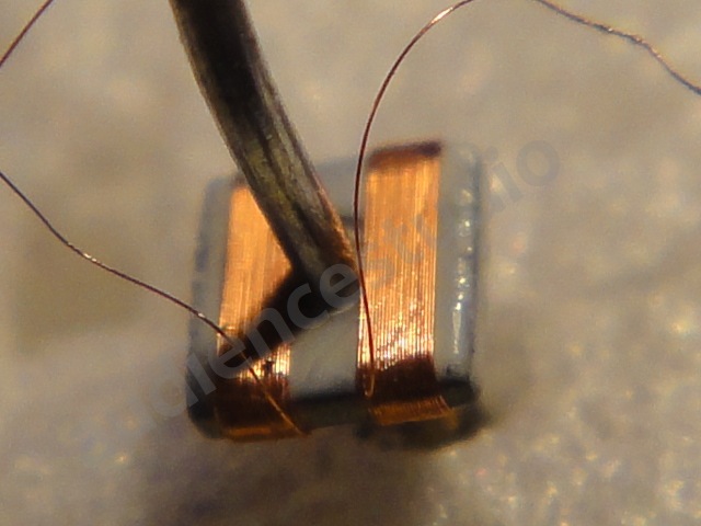

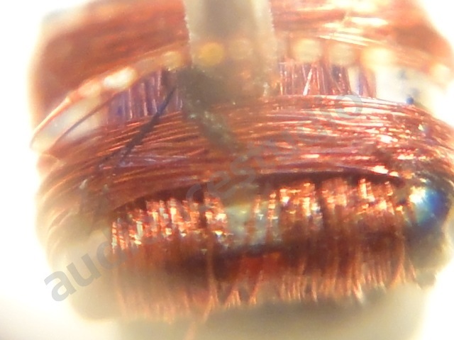

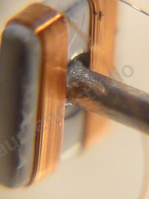

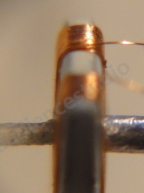

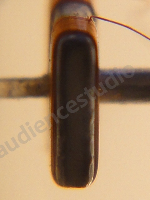

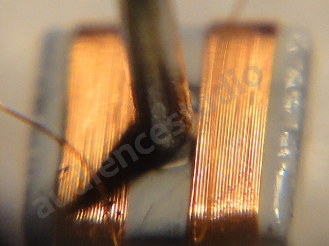

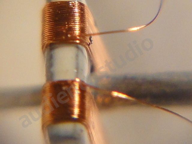

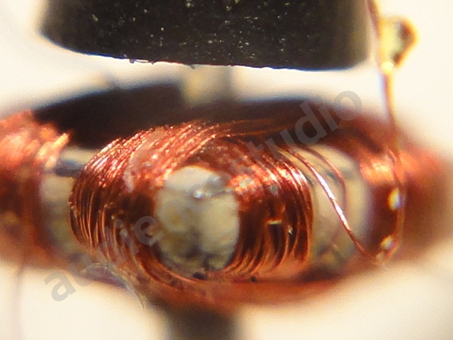

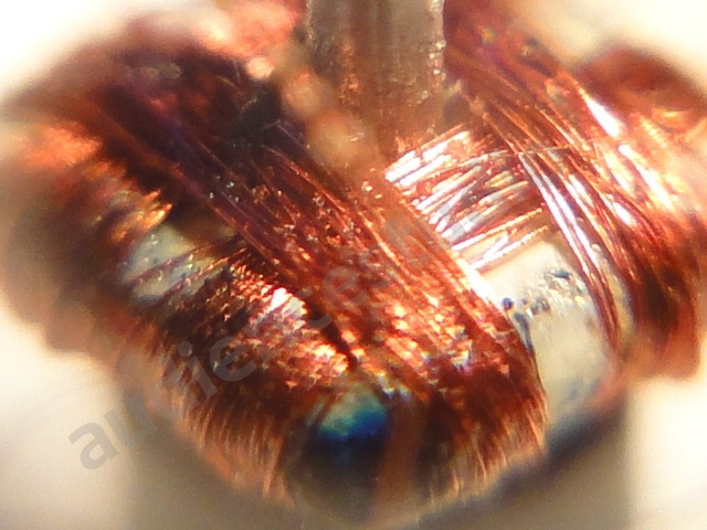

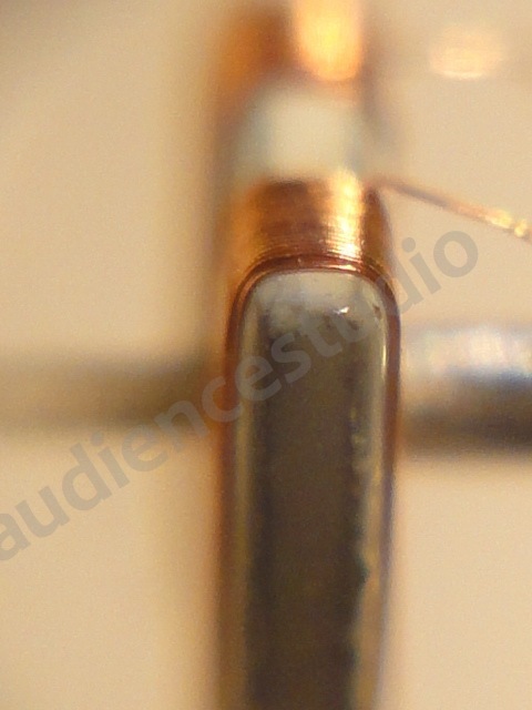

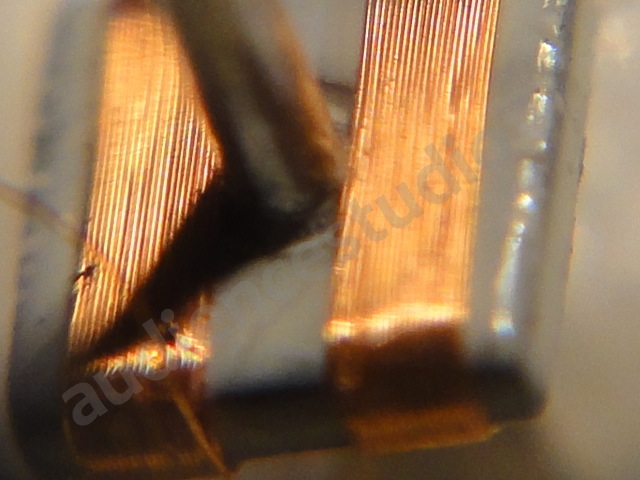

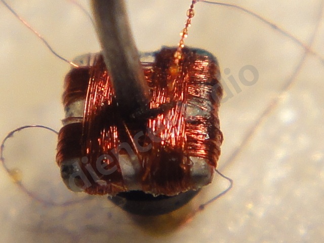

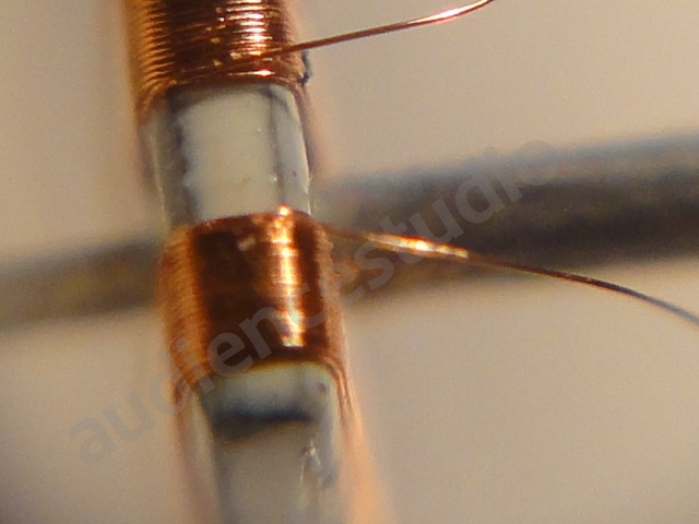

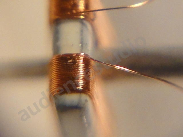

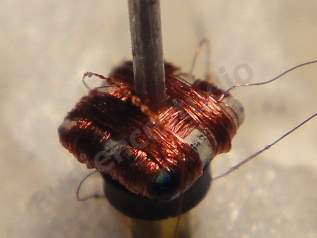

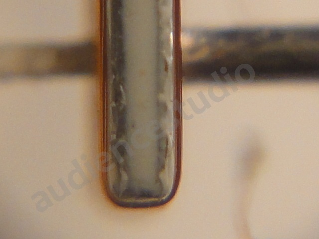

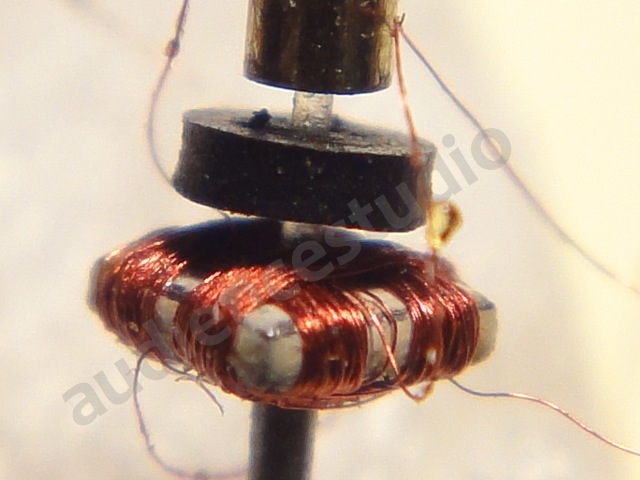

Hello vinyl lovers,
I thought to share some photos of Koetsu Onyx rebuild with you.
A short summary about the cartridge: I don't remember what caused the damage of the cartridge but it needed a new diamond tip, rewinding the coil and new suspension.
Once it was taken apart it was also cleaned, so this is a kind of total restoration.
I think the photos will speak for themselves.
Enjoy them :)
Who did the rebuild and do you know what kind of rubber and glue used to bond the coil plate to it?

I am in the learning phase of cartridge repair and unfortunately it is not me, who did this rebuild. It was done by my friend, who is an audio engineer and has been repairing cartridges for around 30 years. He mainly did this service for friends in his spare time.
I will post more photos of other carts as well.

Whoa!
How the heck did you manage to do this?
I'm thinking, parts? Where do you go for parts??
And also, it's difficult to tell, but the rewound coils look to maybe have heavier wire, and fewer turns?
Regardless, way cool.
Tell us more!!

It was not me, but I hope that I will also be able to do a similar work in couple of years. Getting parts is a good question. My friend has a stock of parts but we are in contact with companies who could supply us different materials for the service.
Sorry, I cannot comment on the heavier wire and the number of turns but I am happy to upload additional photos of other cartridge repairs. Other companies are not really willing to share such photos with the audio community however I feel that they should. It should be a proof of their professionality. As you can see my friend does a very professional work so we are proud to present these photos.

Tricky stuff this cartridge rebuilding... I for one would NOT want to have to wind such thin thin wire!!! The only good part is that the wire itself ought to be fairly inexpensive since wire is often sold based upon weight more than anything else. Of course wire this thin is a 'specialty" item, so may cost a bit more...
yes, please post any other pix that you can. I am sure that everyone who is interested in vinyl will be interested.
IF you have photos of other coils wound by other *companies* (not small individuals) that you can share (with or without stating exactly which company did the work) that would be interesting.
I presume that the larger cartridge makers have machines, jewelers precision, to do the winding work, since they seem very very even and consistent.
Thanks!!

and this is how it should be done. The photos show the same piece recoiled correctly.

How are the coils connected..?? I suspect the two coils with the same orientation are in series..
The brick is in soft iron, for best performance i guess silicon-strip-steet (transformer-core iron) or maybe Permadur would be the best choice. The iron core gives the B-field direction and higher Flux.
