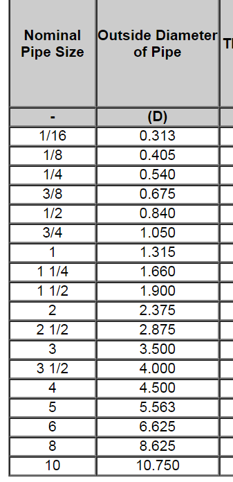

I found a local place that will rent me a Greenlee hyrdaulic knockout punch kit.
The dies rent separately so I wanted to rent as few dies as possible to keep costs contained.
The tube sockets will sit below the aluminum surface of the chassis so I need to accommodate not for socket diameter size but for maximum tube glass diameter.
If I'm building the Tubelab SSE I would think that I would need the following punch sizes for my aluminum chassis:
1. 2 1/2" to accommodate the KT66 (largerst power tube): max diameter is 53mm or 2.08 inches
2. 1 1/4" to accommodate the nine pin 12at7: max diameter is 7/8"
3. 2" to accommodate the GZ-34 or 5AR4: max diameter is 1.5"
Am I accurate? I was concerned about going any smaller because it could make rolling/twisting tubes on exit difficult.
Thanks in advance for any insight!

Don't forget, knock-outs are sized as NPT sizes which are not the same as actual inch measurements.
