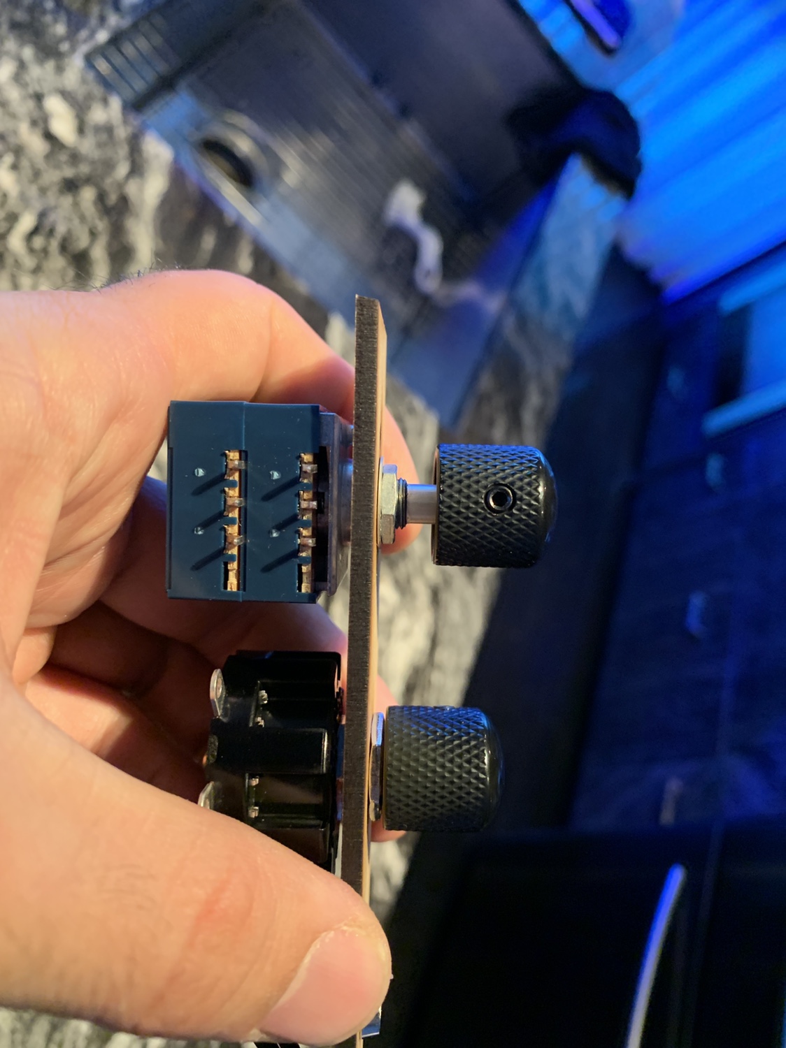

I'm looking for a knob that will fit both of these parts. I have..
An ALPS 10k POT
ALPS 10KAX2 10K Ohm Audio Taper Stereo Potentiometer 6mm Shaft
And an NKK Selector Switch: HS13X NKK Switches | Mouser
I'm looking for a knob that can fit both. They are both 1/4 shaft diameter and require a set screw. The issue is that the NKK shaft is shorter than the ALPS pot and I want the two switches to match. Also, they need to be 1.25" in diameter around, but no larger.
Any help is much appreciated.
I'm posting a picture in the next comment of the height issue.

Those are nice, only one is tall enough but inside it’s still 0.510” deep and that will cause the issue as above. I’ll keep looking.
I usually break out the hacksaw to resolve height issues with my pots...
Oh yeah? Any issues with doing so? How do you hold the pot steady do you put it in a vice?
Yep, I just put them in a vice with soft jaws and just a gentle touch to hold (too much and you'll crush the case).
I tape the shaft, mark it for length then cut it to dimension with either a junior hacksaw or a dremel with a cut off wheel. I file the end of the shaft with a chamfer to make it easy to get the pot on, but it doesn't need to look good - it gets covered up anyway.
The only issue might come if you try to use the pot for a different project with a different knob - it might not be long enough any more.

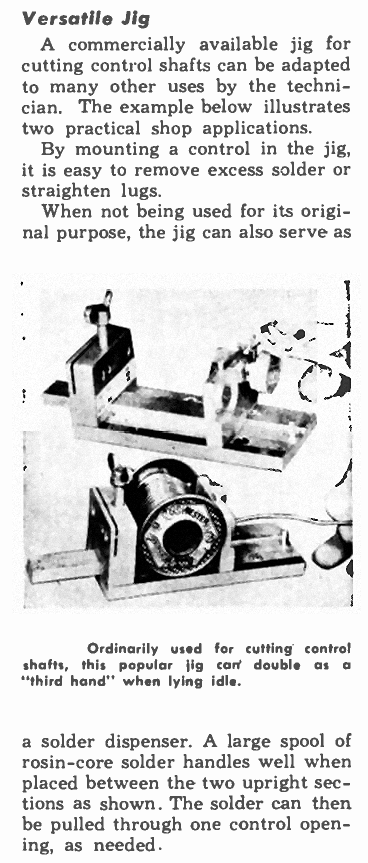

Apparently there was a tool for this.
https://www.americanradiohistory.co...hop-Hints-Rider and Electronic-Technician.pdf (3MB PDF)
Note slot at left, presumably for a hacksaw. The two thingies must slide for shaft length (some older gear had quite long shafts to clear curvy housings).
I have never seen this thing in real life. I always clamp the waste and saw carefully.
