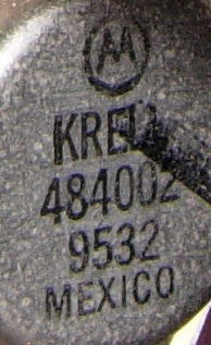

OK, I did something stupid and killed the output of a KMA 200 amplifier.
Need to replace some of the “Krell 484002” transistors.
Did some searching on the forum and found conflicting information.
Some older posts show “Krell 484002 = Onsemi MJ1302A”
Or : “Krell 484002 = MJ15025”
Can somebody let me know which is the correct one ?
Anybody has some for sale ?
Many Thanks

AndrewT said:
I think it unlikely that the ONsemi 1302 is correct.
Much more likely is the 15025, also available from ONsemi and their distributors.
Are the parallel output devices matched in any way?
Is there any damage further upstream?

Any outputs that are in parallel should be replaced as a group - with devices from the same lot. Any additional matching depends on how anal you want to get about it, but just using the same lot/date coded parts is enough for basic safety.
I was told by Krell service many years ago that a special test spec was used on Motorola MJ15024 & MJ15025 production transistors, which implied that generic MJ15024 & MJ15025 would not be an exact match.
I would:
0) measure the voltage across a couple emitter resistors on the good amp to determine the idle bias current
1) remove a NPN and PNP and make hfe measurements at 25ma and 1A and compare to new MJ15024 & MJ15025 specs / tests
2) if the match is close, I would replace only the defective output transistors with new MJ15024 & MJ15025 that measure close hfe, and leave the bias setting
3) if the match is not at all close, I would replace all output transistors on one channel with new MJ15024 & MJ15025 and reset the bias - same voltage across emitter resistor as-0
4) the Krell schematic shows a 1 Ohm emitter resistor, which is large, and hence allows good current sharing even with fairly large hfe differences
5) if the power supply capacitor date code is over 12 years old, I would accept the high cost to replace them in both amps. Leaky power capacitors often burn out the power-up relay board, which is very expensive.
