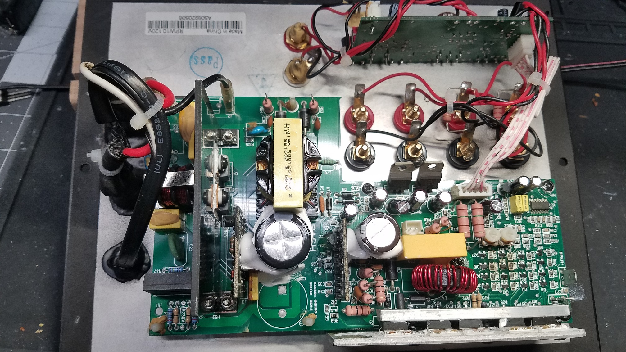

SUB-12 PLATE JIDG050400766

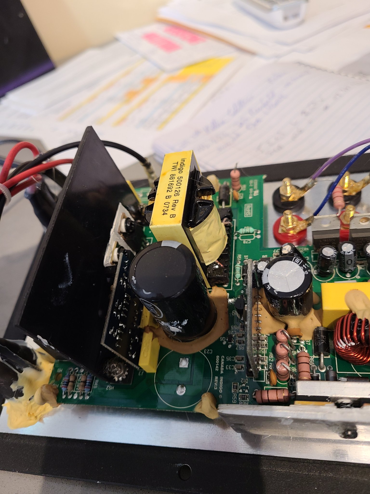

This one was rather interesting. It came to me with all of the power wires cut. I had to do the repairs and rewire the plate. I am not a fan of these all in one style boards. They are a pain to work on. The wires going form the speaker terminals to the plate were also cut. It was almost like someone wanted the copper and trashed the amp. This plate had the glue monster do some damage which is 99% typical for these. PDC rebuild, full recap, new fets and Q5 upgrade.

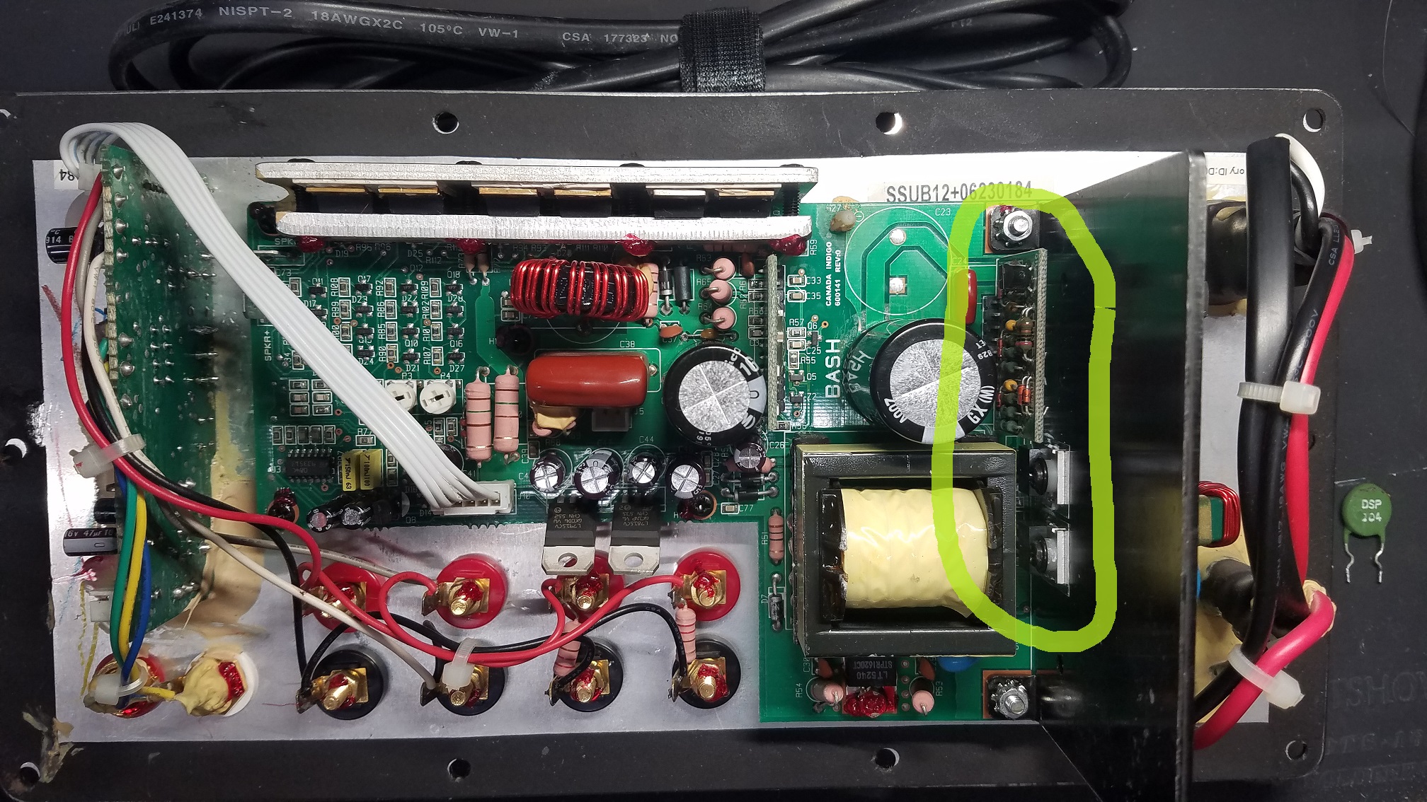

RPW-10 PLATE SI-00129
This plate is a trade in repair. I am trying to clean up my parts box that is overflowing, so I am going to start punching these out so I can get more organized. Typical repairs on this one. TH3 exploded, fets were shorted, PDC failed. Full recap and Q5 upgrade completes this one. The thru holes for the fets had damage from an attempted repair, so I had to freaking fix those.
IF YOU DON'T HAVE A VACUUM DESOLDERING TOOL CUT THE DAMN LEADS AND SAVE THE THRU HOLES!!!!!!!!!!!!!!!!!

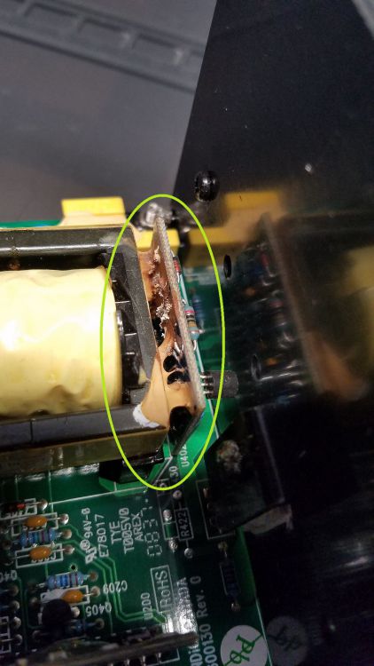

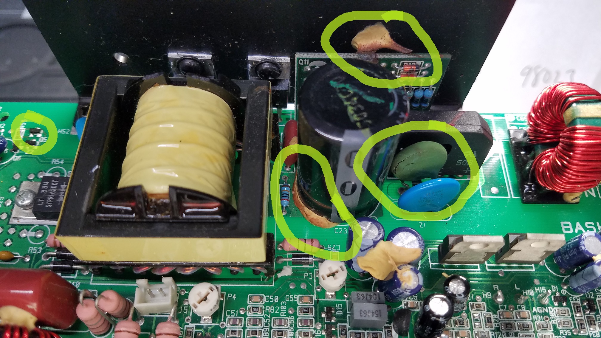

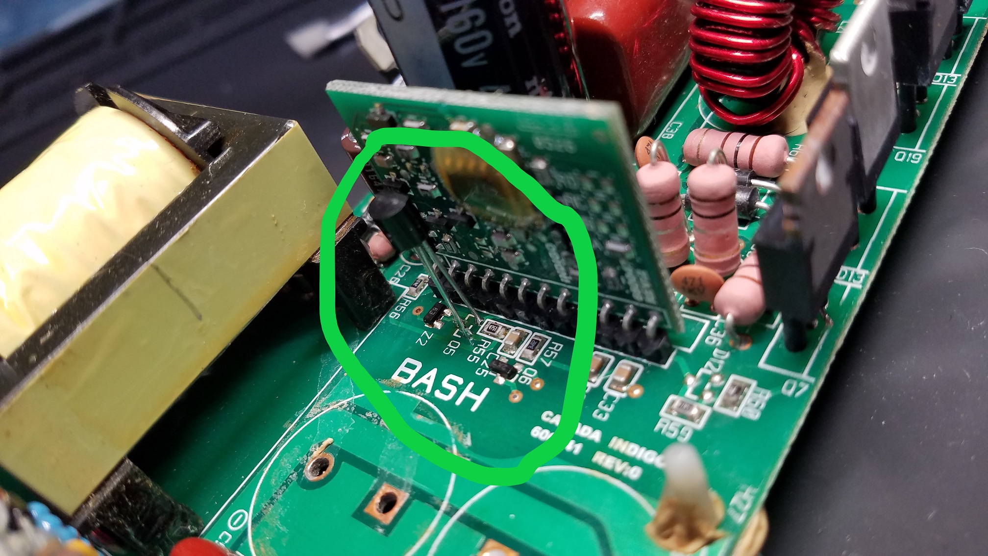

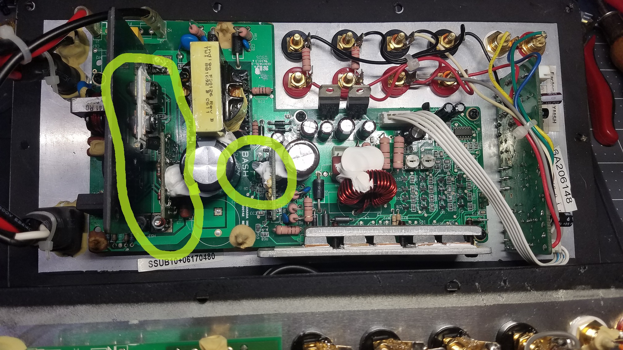

RPW-10 PLATE A506220506

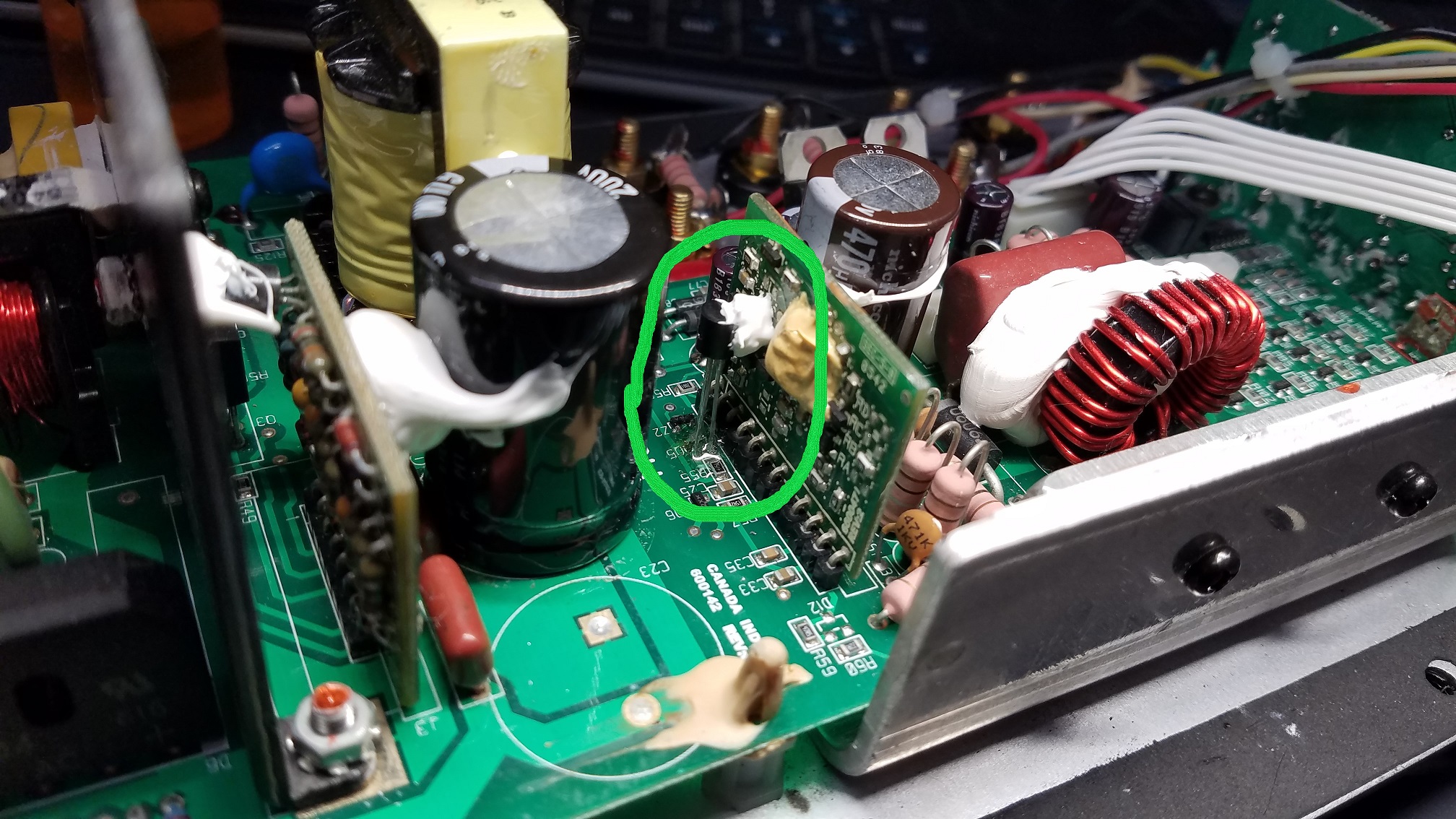

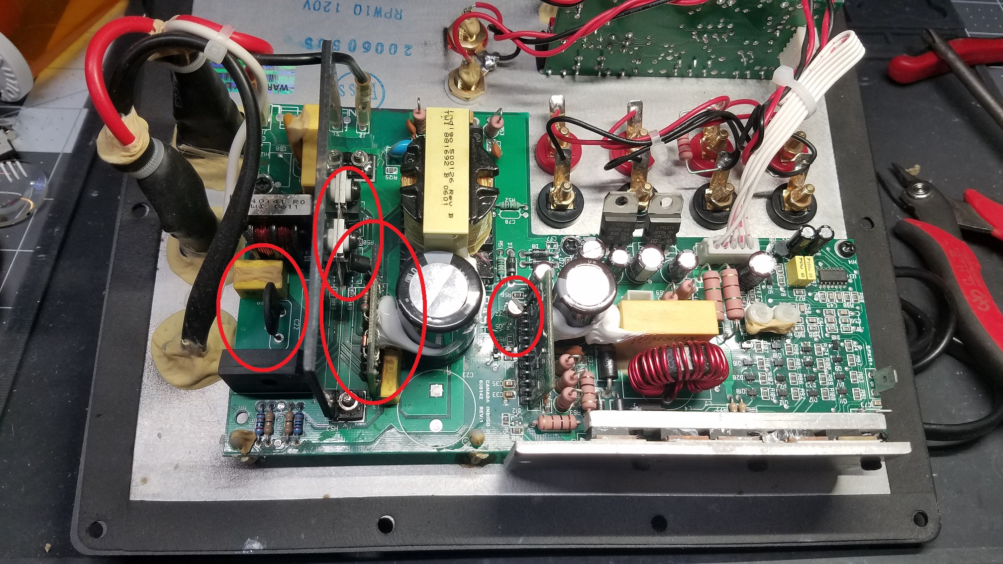

FINALLY, something different. This failure was not one I have seen before. C31 appears to have prematurely evacuated and caused all sorts of issues. Z2 was toasted, Q5 evaporated and R51 failed. The BASH board was taken out as well with a blown diode, transistor and the IC. The IC's are a pain in the *** to replace because of the glue or epoxy used to try and hide the UC3842 chip. The board did have some damage to the copper plane under the cap, probably from the electrolyte. This is a fairly easy spot to repair.
Best guess, Q5 failed and took out the bash board and caused Z2 to fail. R51 then failed from heat due to the current draw. When the bash board stops working the voltage on C31 goes over 100V, which it is only rated for and that would cause the leakage. Normal voltage is around 90V. This is why on later revisions this cap was upgraded to a 160V version. It is still OK to use a 100V cap here, as long as the amp is working properly. Go 160V if you want to play it safe.
As usual, glue removal and Q5 upgrade with a full recap.

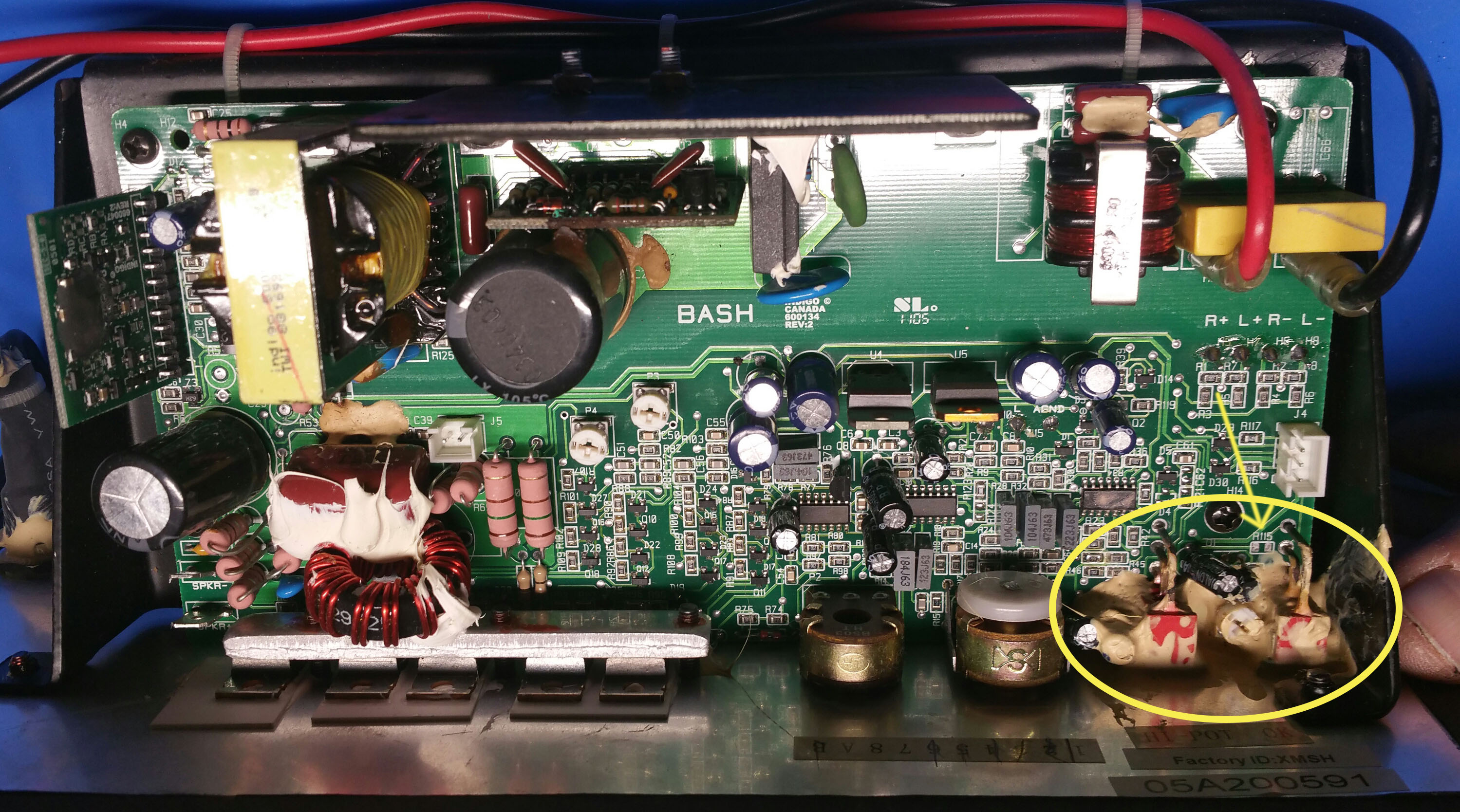

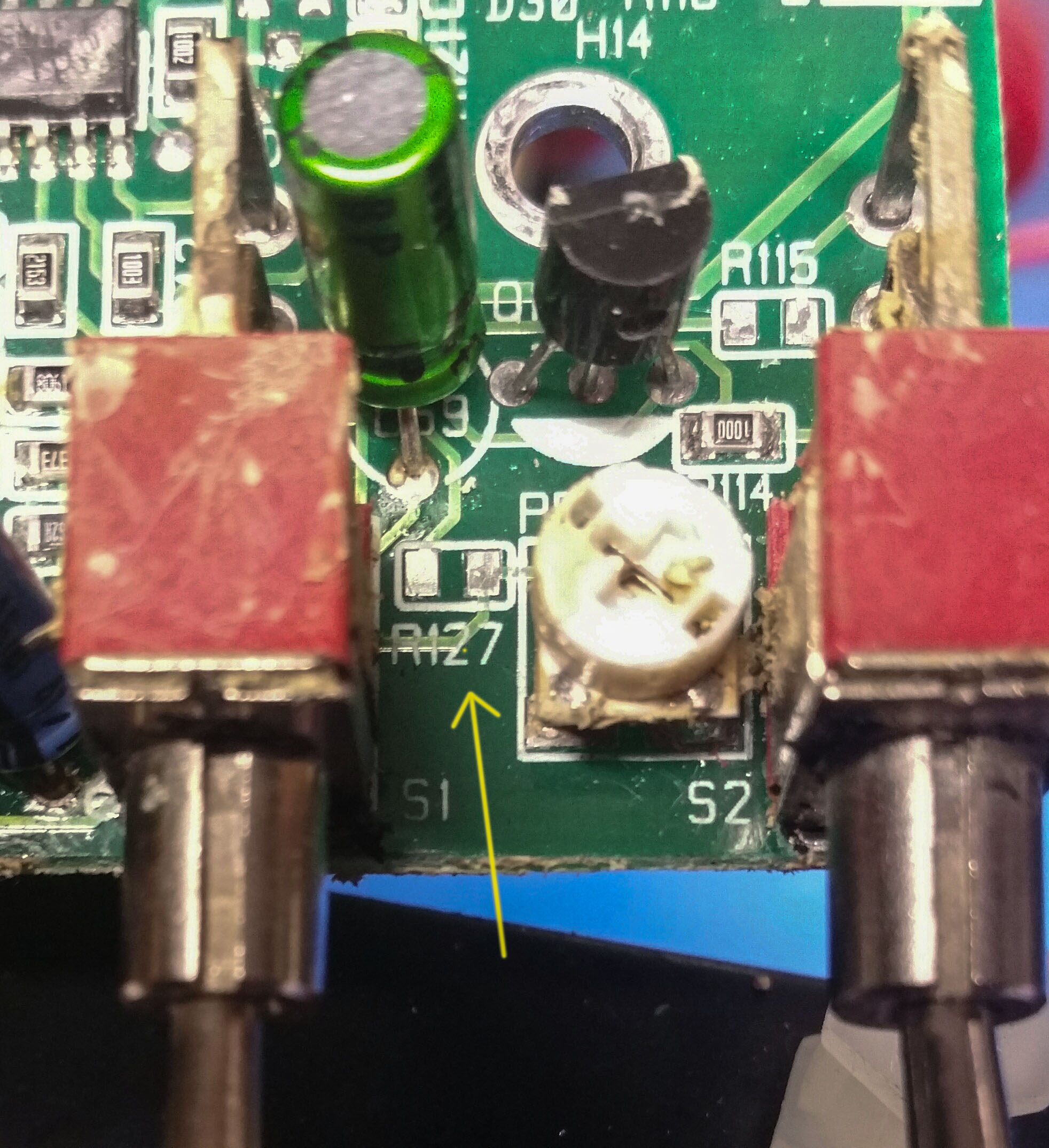

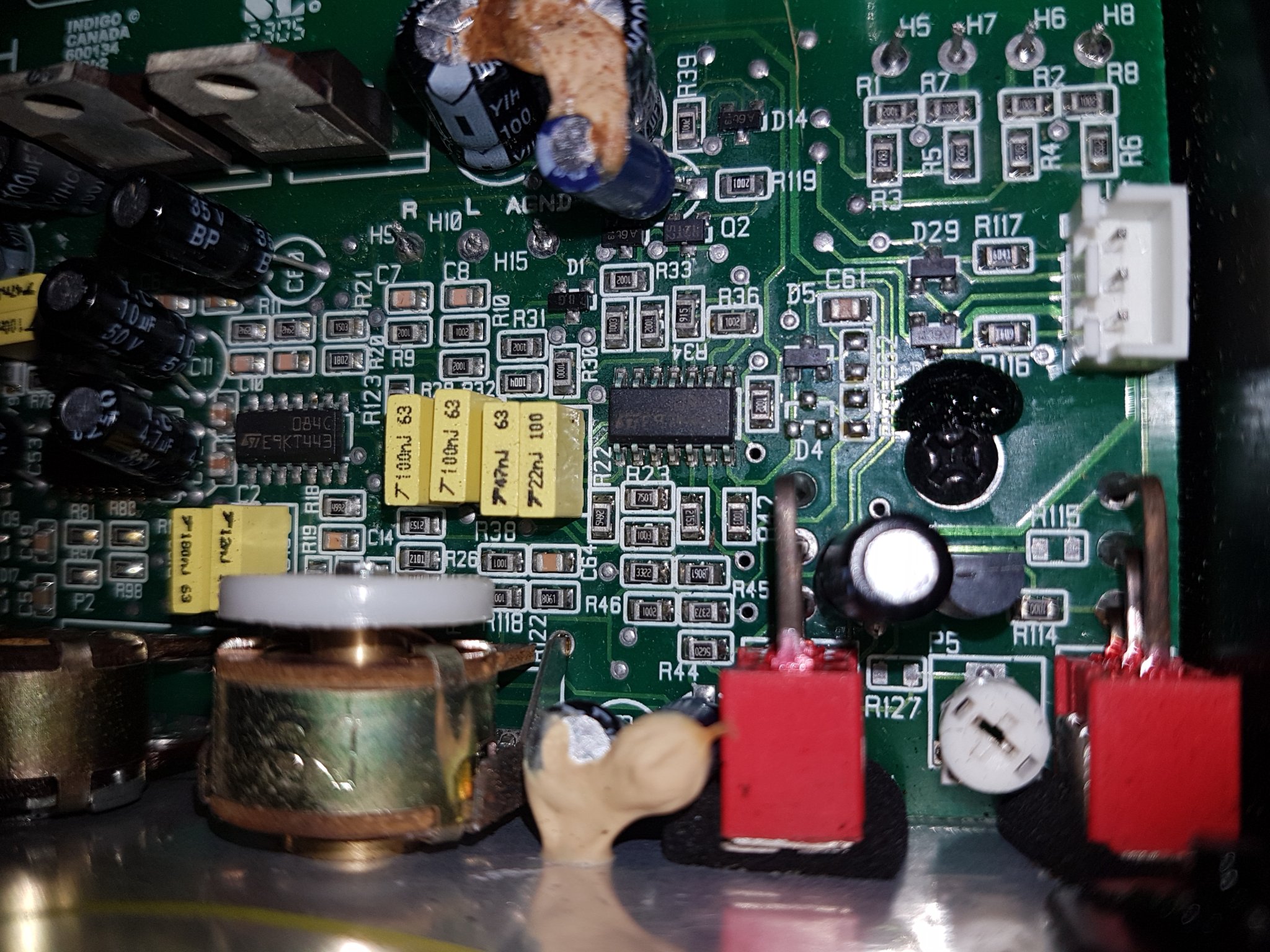

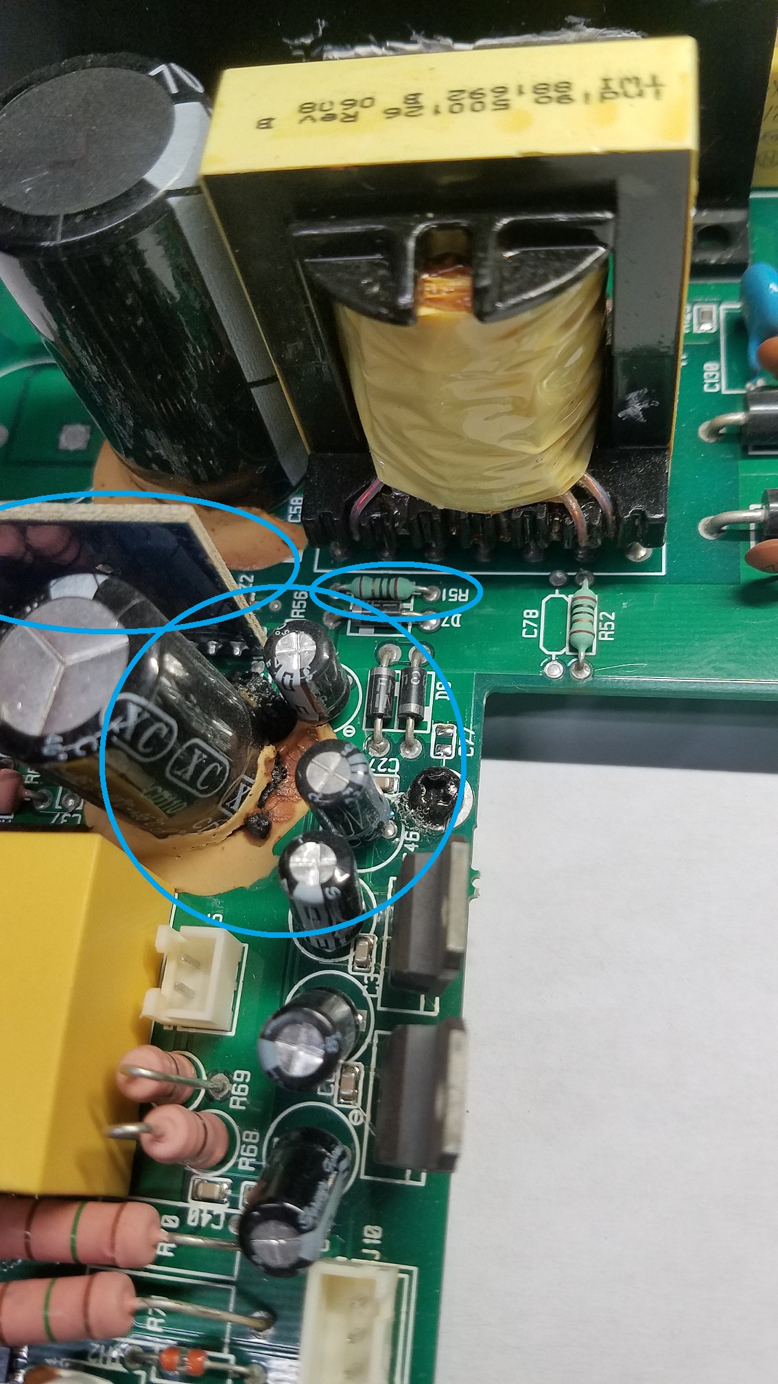

Resistor or not?

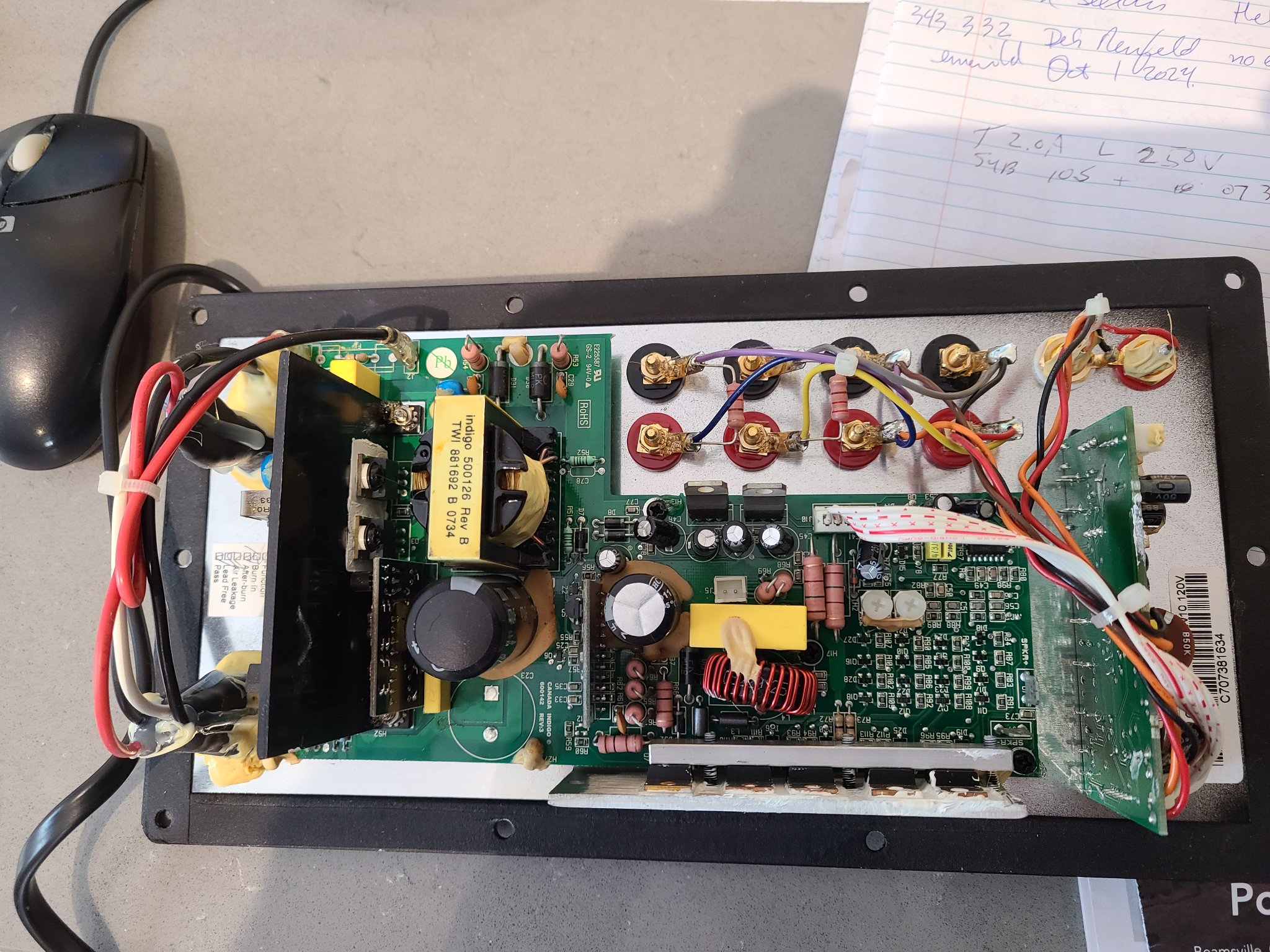

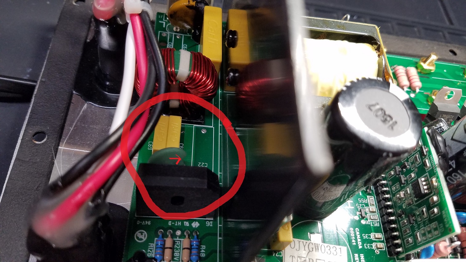

I'm working on this SUB-10 amp and after cleaning the large glob of glue from the corner of the board, I notice that there are a couple SMD resistors missing from the board. Looking back to my original pictures, I see that R115 was never there but R127 was buried in glue. My question for anyone is whether or not there was a resistor there that I possibly removed while cleaning the glue? If so, can you tell me the value? TIA.

Resistor or not?
On my SUB-10 board SMD resistors R115 and R127 are not installed. R114 is 100 Ohm just in case.

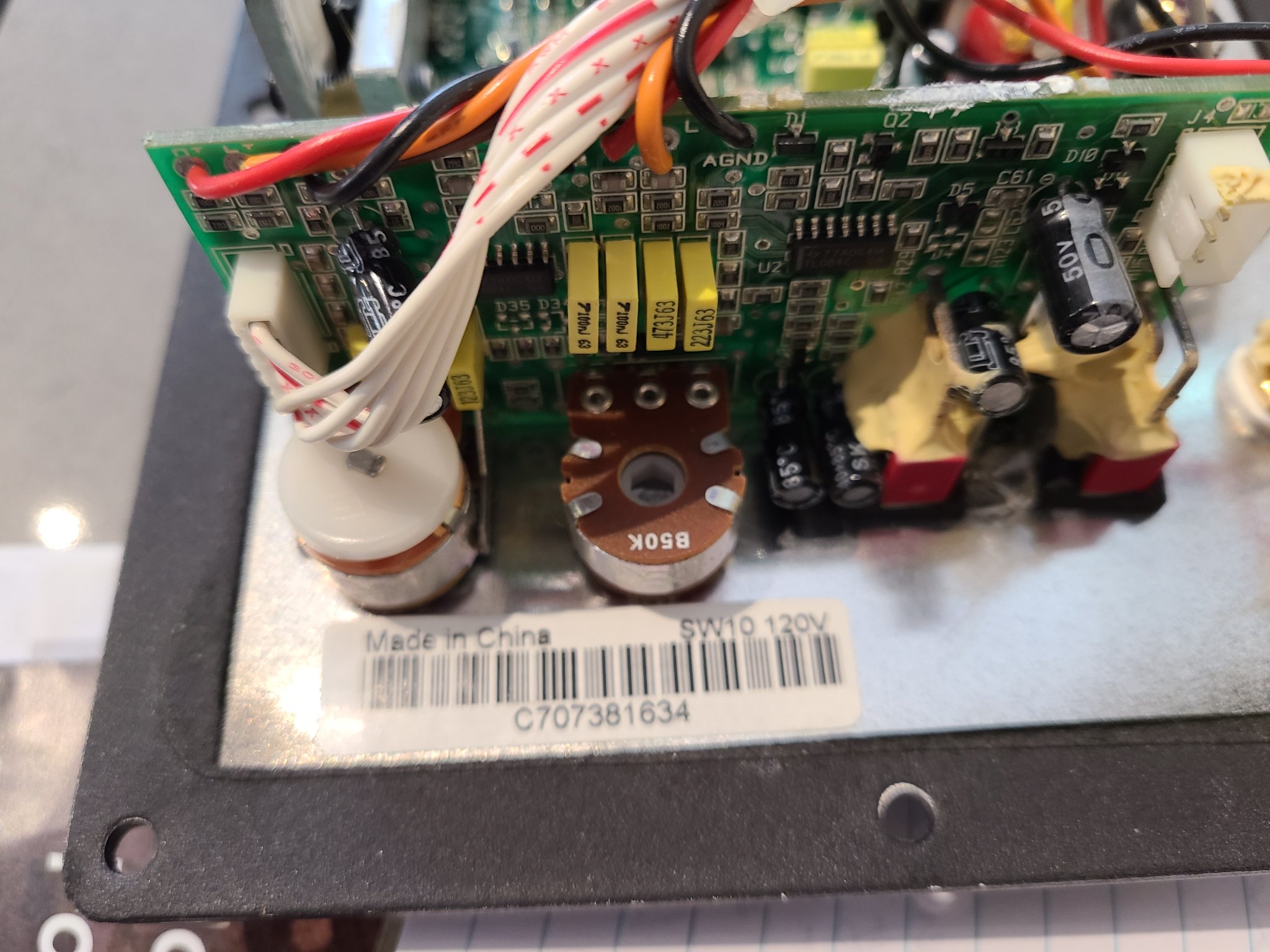

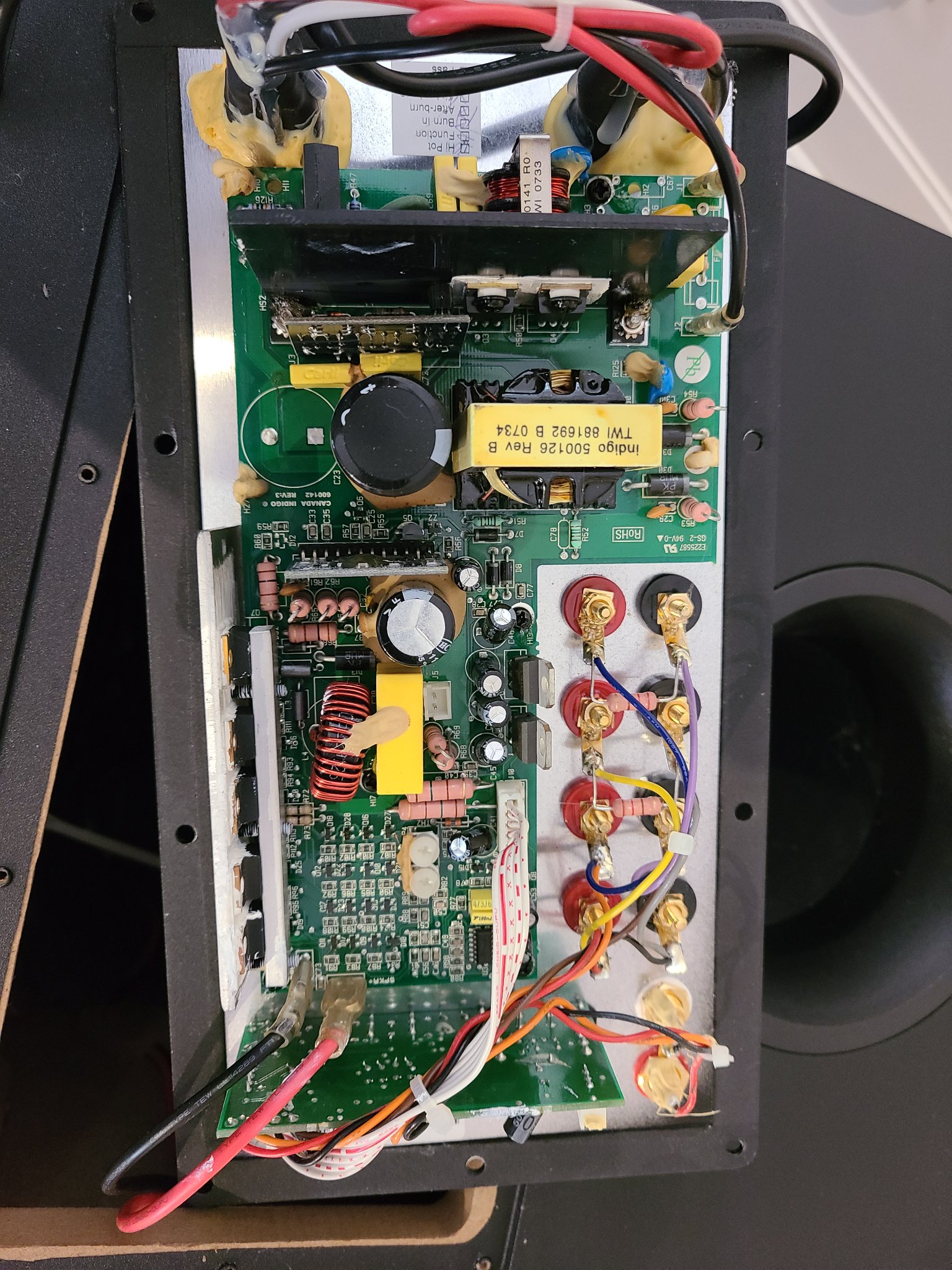

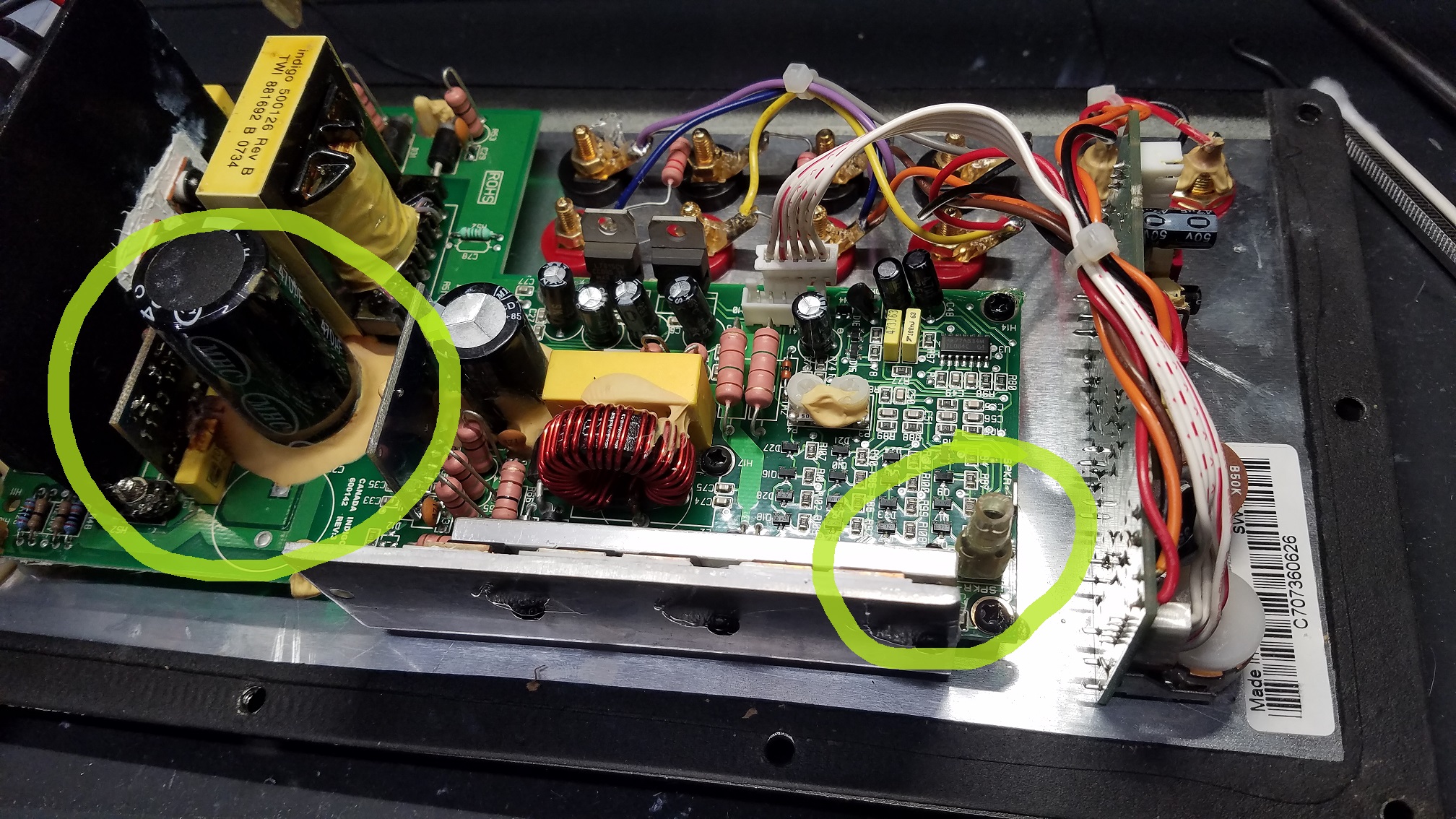

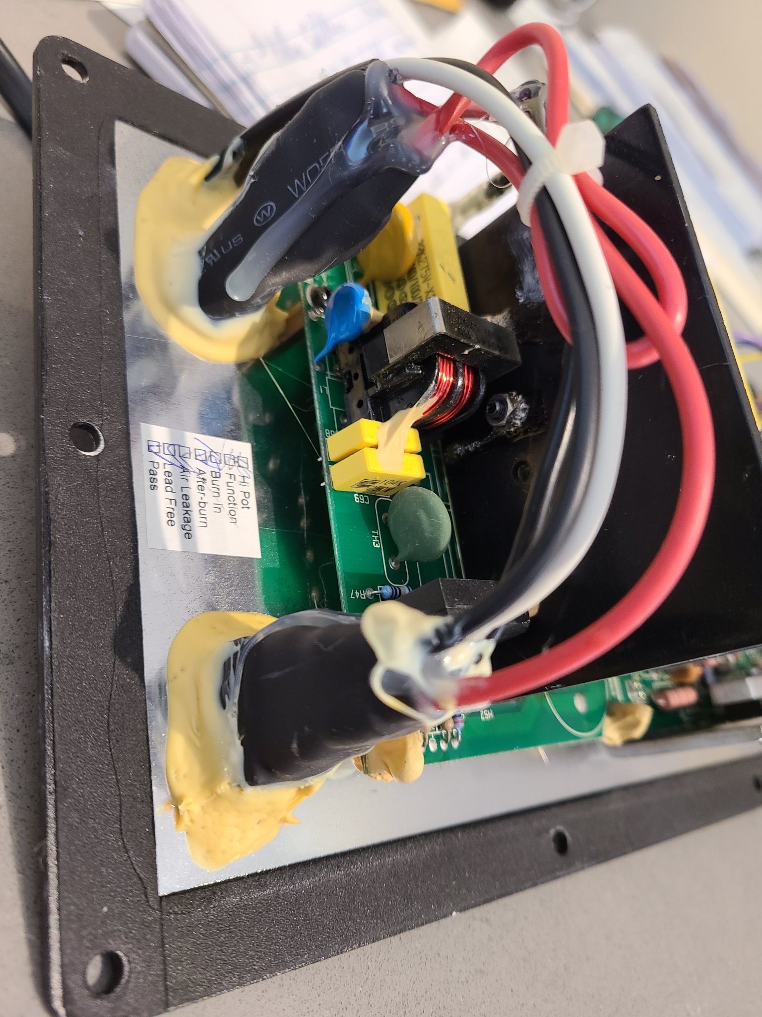

Sub-10 amp is dead. S/N C707381634 Blows fuse immediately. No obvious burnt or damaged components on board. Most of the repairs discussed are beyond my capacity/equipment to repair.
ngen33r are you still repairing these boards ? If so, how to contact you? Or any ideas to get a replacement amp board?
Rick V
