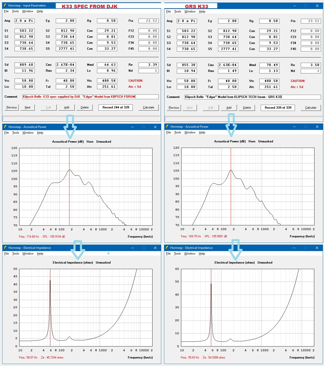

Hmm, it's Fhm is off enough for me (~124 Hz Vs 172 Hz) to question its 'perfect tonal match', especially in horn cabs, so waiting with 'bated breath' what the official K Community response is and/or if they had any input.
