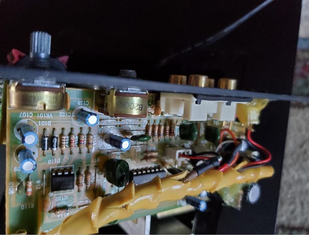

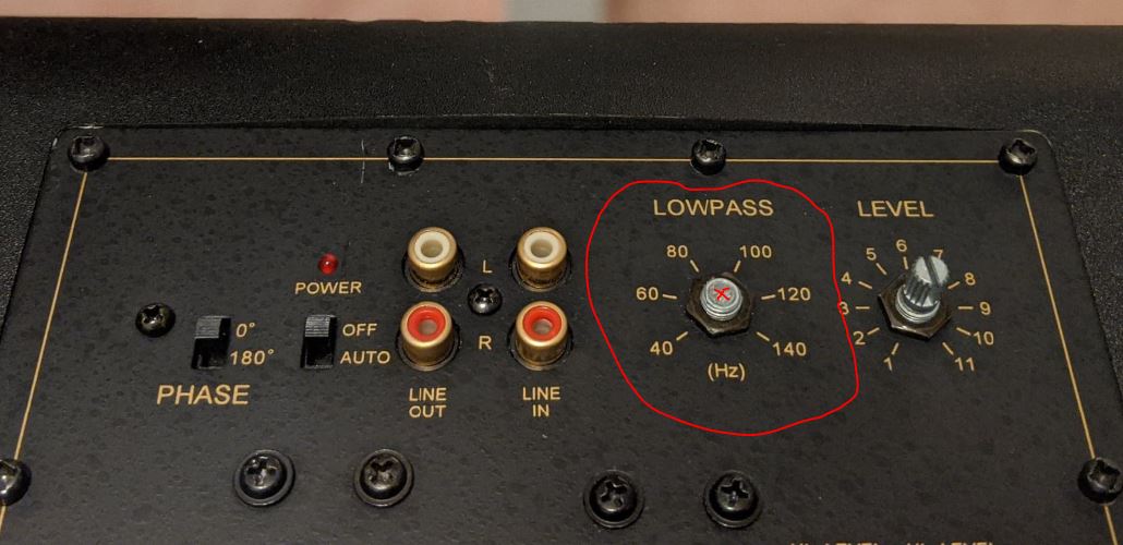

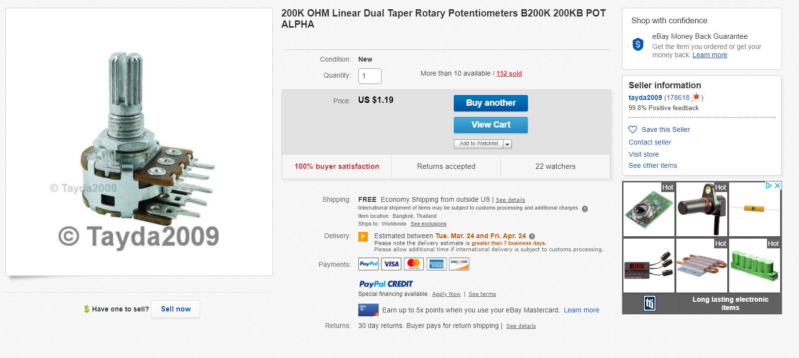

The trouble is a broken Freq Pot shaft. The seller says the sub works fine, but his kid dropped something on the cabinet and the "object" sheared off the B200K Pot shaft. (see Pictures)

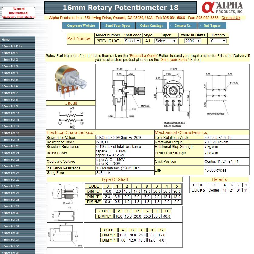

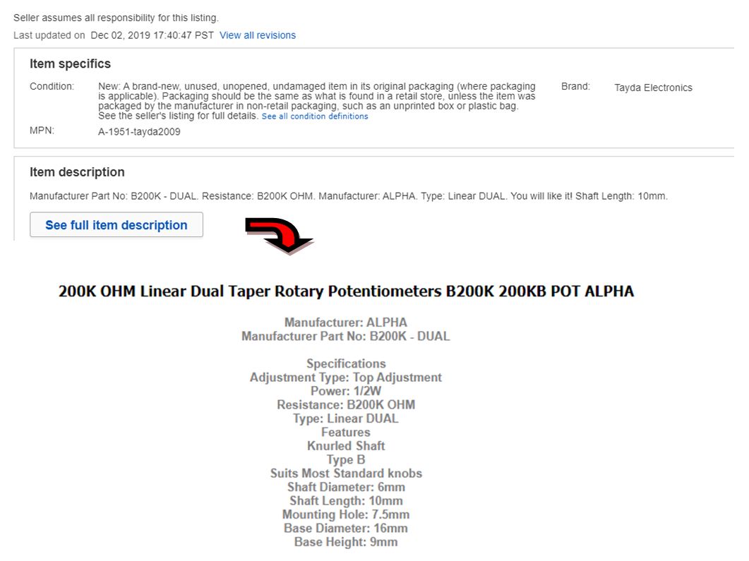

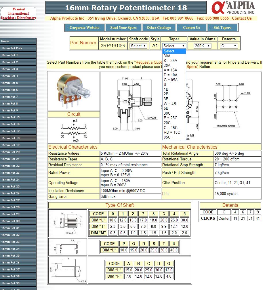

I visited the ALPHA website and the charts show the two most likely configurations I am fairly sure it will be a type "B-Curve" but I am not sure which one. I found this item on eBay that is rather a 1/2 Watt. I am unsure of the "Taper" value. Will this part work? Can anyone offer any technical guidance?

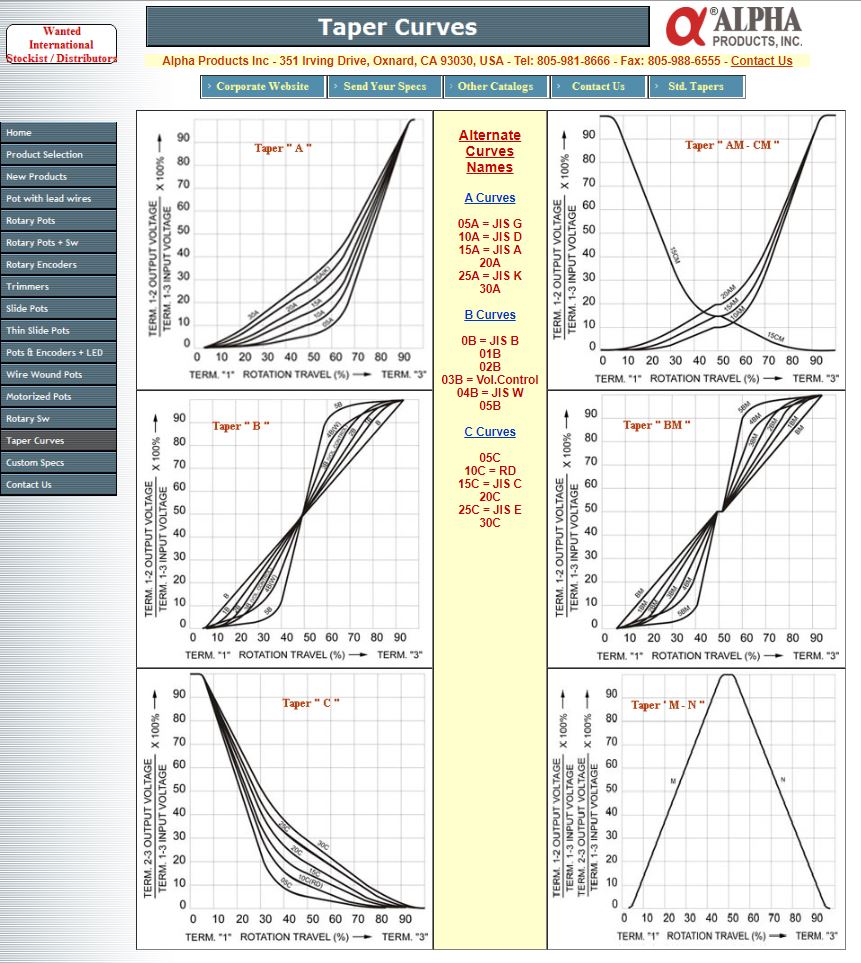

I believe if it's for frequency adjust it should be linear. The scale on the sub is also linear. According to the pictures I would choose Taper B, as for the pot in question they say it's Linear taper B, but make sure You measure the shaft dimensions.
i'm cheap and sometimes lazy i would simply use a Dremel with a cutoff wheel and cut a slot into what remains of the shaft and use a jewellers screwdriver to adjust it, once set it's not the sort of control that needs adjusting often.

I would rather fix the puppy up as best I can by replacing the pot, adding new knobs, restoring the case damage, and just enjoying it with the Klipsch KG 3.1 speakers the sub came with.

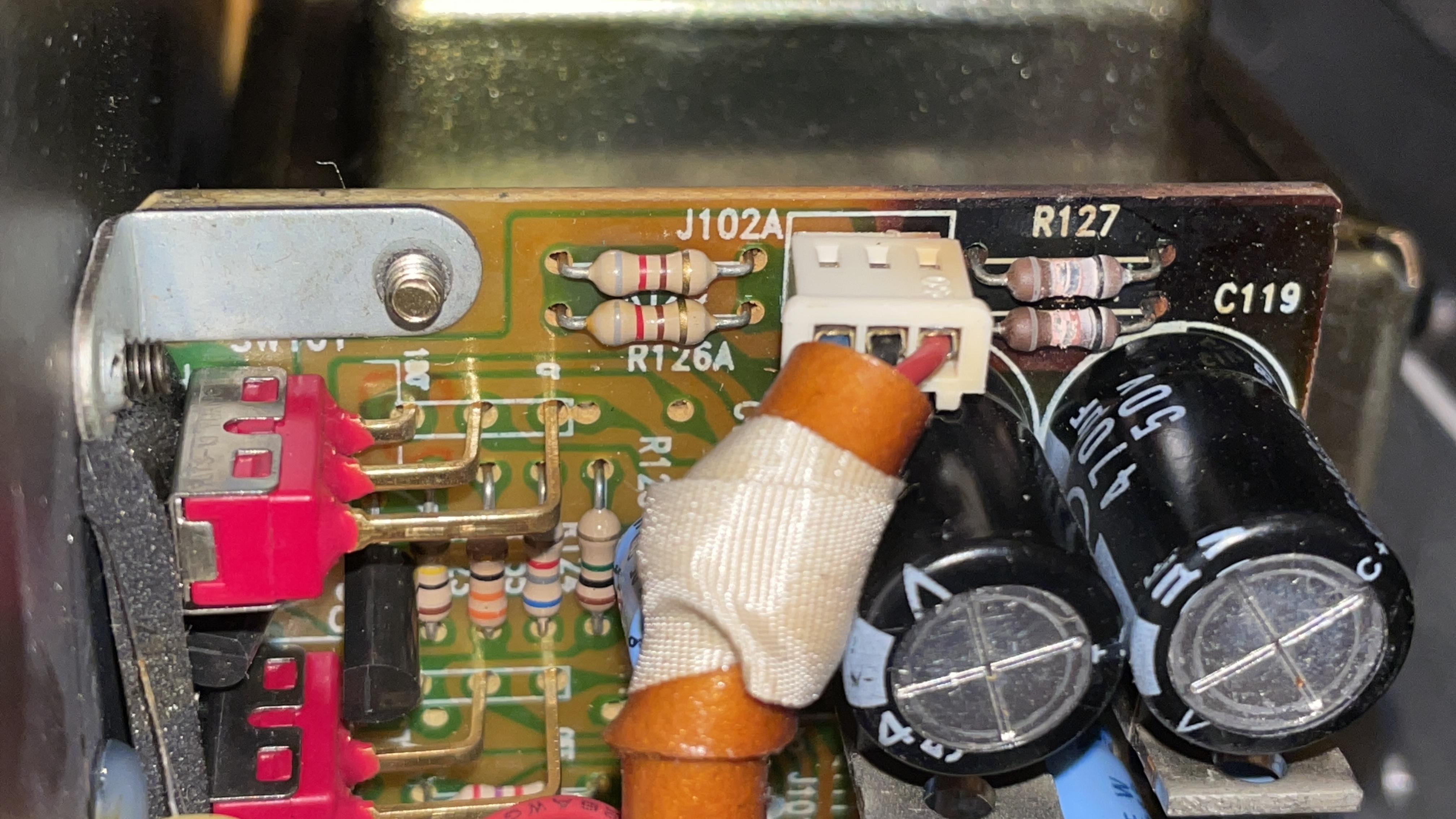

I also have the KSW-50. Mine won't stay on. R127 and R127A are crispy. So cooked I can't read the values. Assuming the resistors are +/-5% like nearly all the others on the board. What should be a gold band is now black. The other three colors may be in the red to orange range. I'm hoping Sandman01 can take a peek inside and give me the values for those two resistors. They appear to be in parallel at the edge of the board. Thank you!
