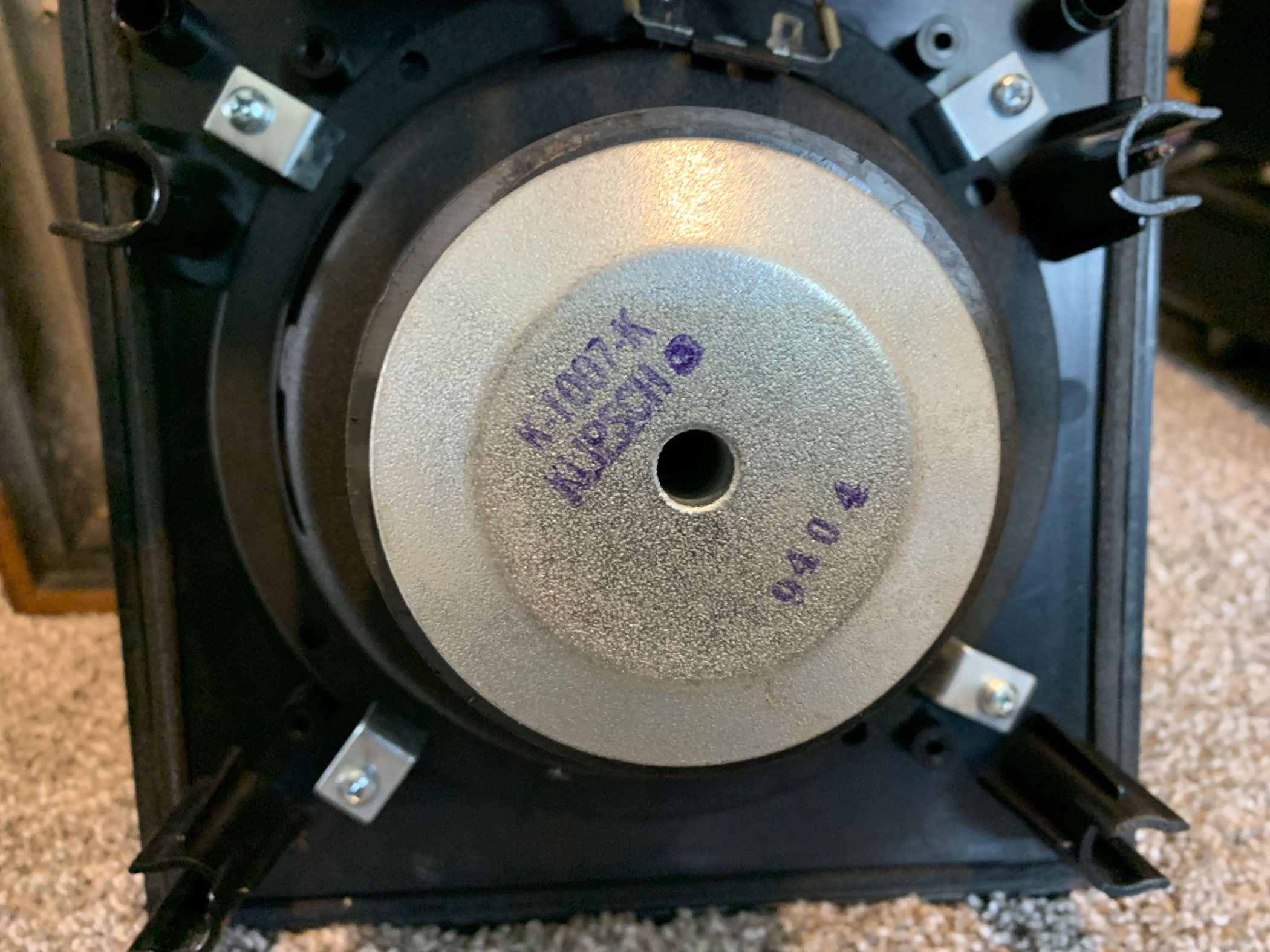

I have some KG1.2 2-way speakers (8 ohm) with dead woofers. Unfortunately, finding good K-1007-K drivers is not possible, unless I want to buy some KG1.2's with cosmetic issues and just use the woofers ... but that doesn't make $$ sense.
Rather than relegate these to the dump, I'm thinking about just replacing the woofers with cheapies from Parts Express and use these in my garage workshop where sound quality isn't a big deal.

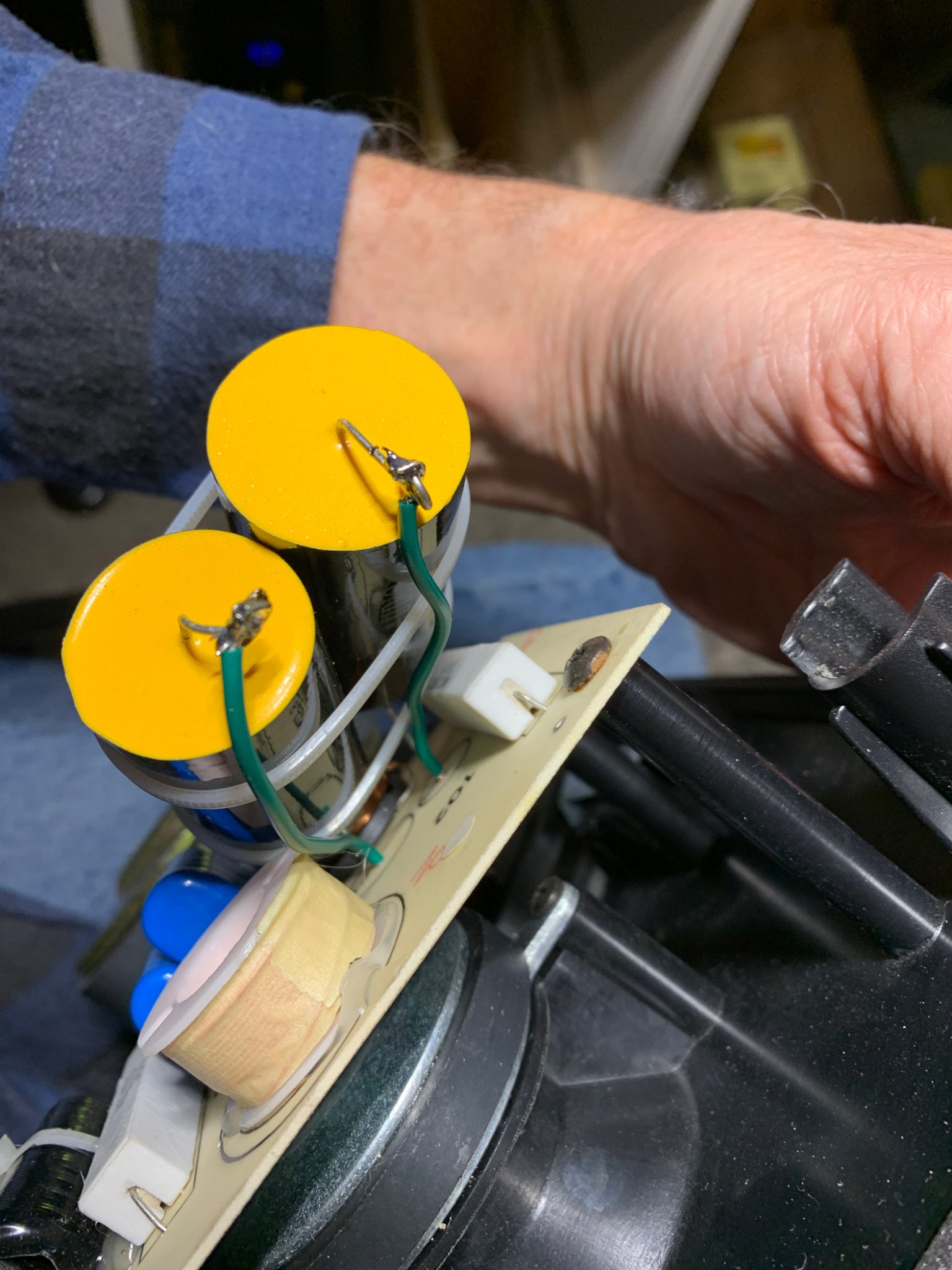

I'm hoping someone here can chime in on things to consider, like the crossover point, which is 2200Hz. The two electrolytic caps are KSC 20uF/25uF, 100 VDC, 10%. I can get film replacements fairly cheap at PE.

The oem drivers do not have an ohm rating on them and since they are dead, I can't get a reading. The baffle opening for the woofer is 5.75". Here is the woofer I'm looking at: GRS 6PR-8 6-1/2" Poly Cone Rubber Surround Woofer

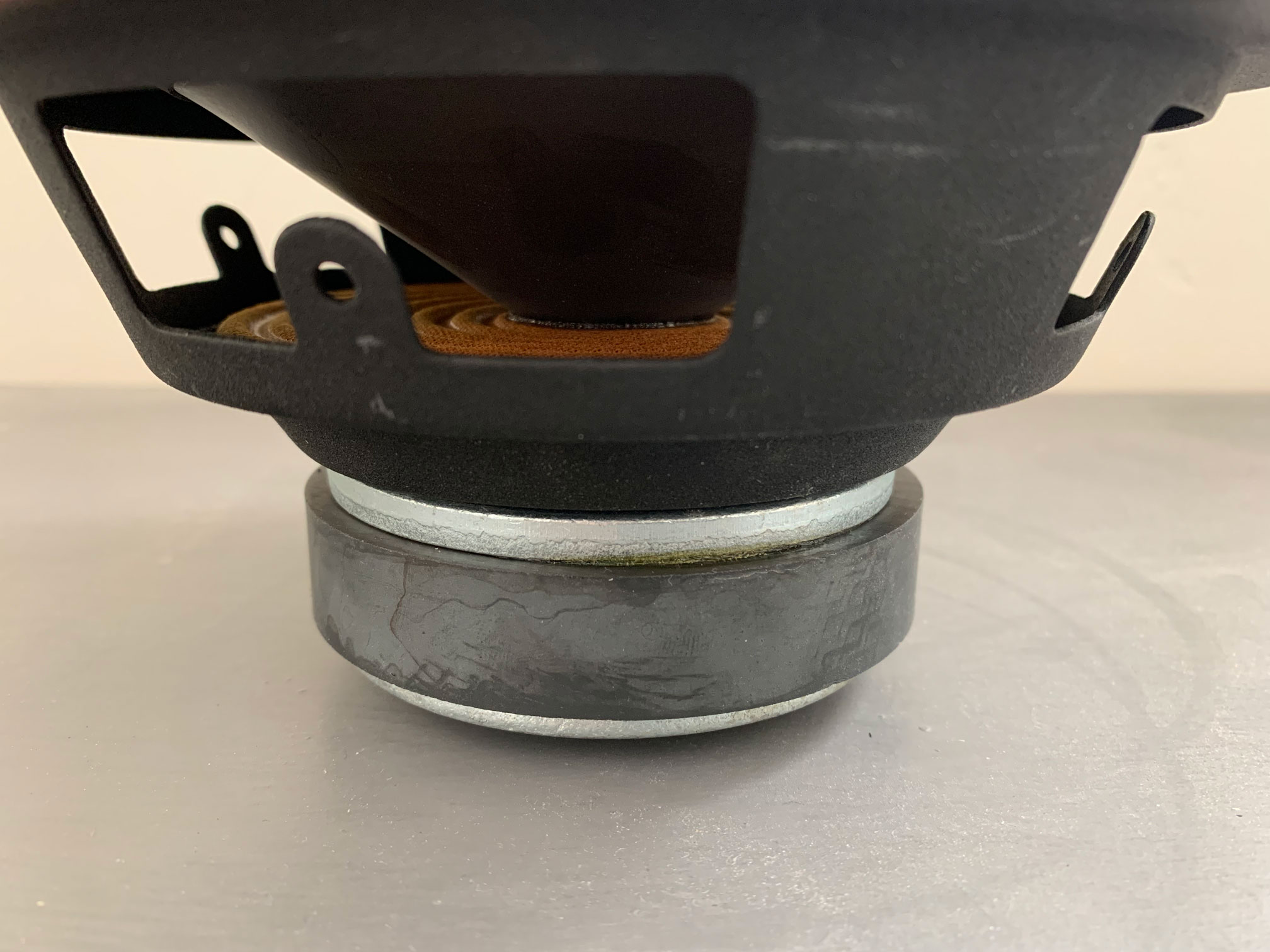

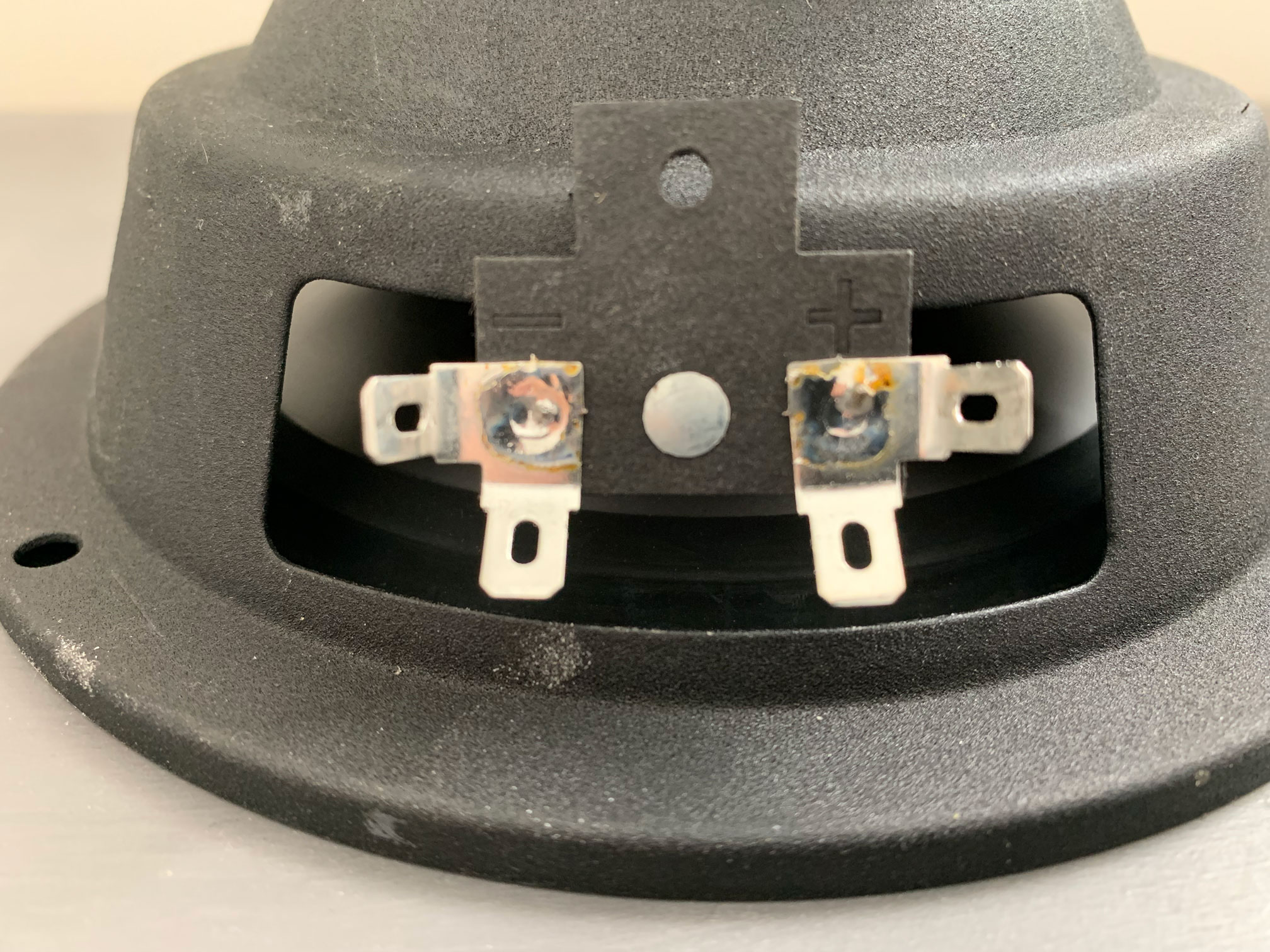

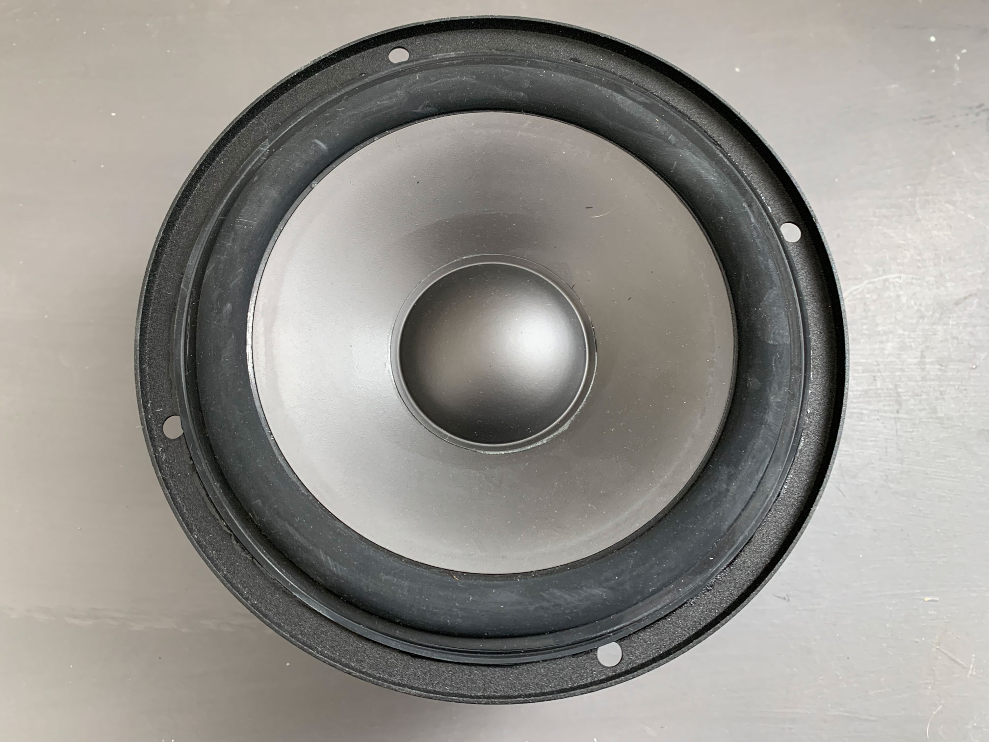

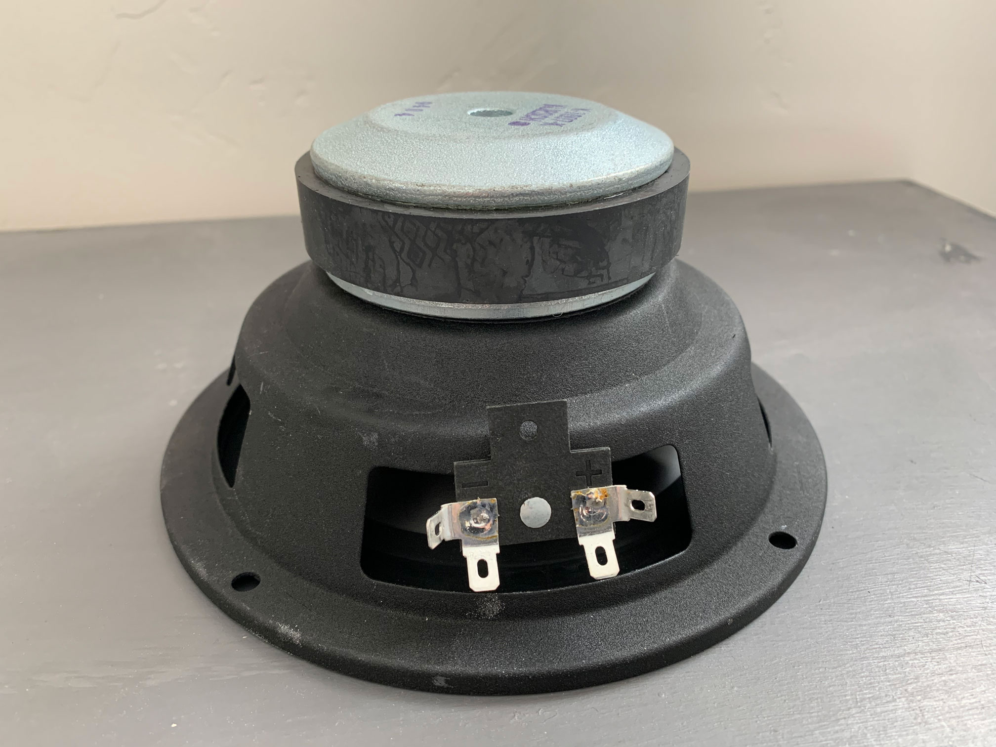

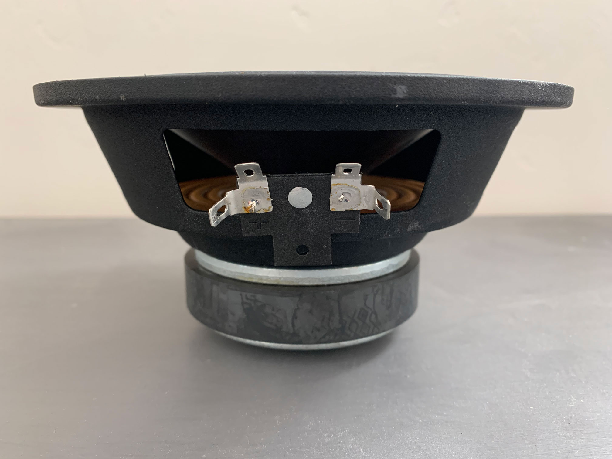

Sure thing. Her are a few shots to help identify a replacement.
The cone and surround look very much like the CG-168R I once owned, but the voice-coil dia looks 25mm/1inch instead of 38mm/1.5". Also, the magnet assembly looks different.A very capable mid-woofer, so if you could get a pair second/third hand, go for it.

I also ordered some Dayton Audio film caps to replace the two electrolytic caps on the crossovers. I plan to first install the drivers to hear the sound quality ... then update the crossovers to get a comparison.

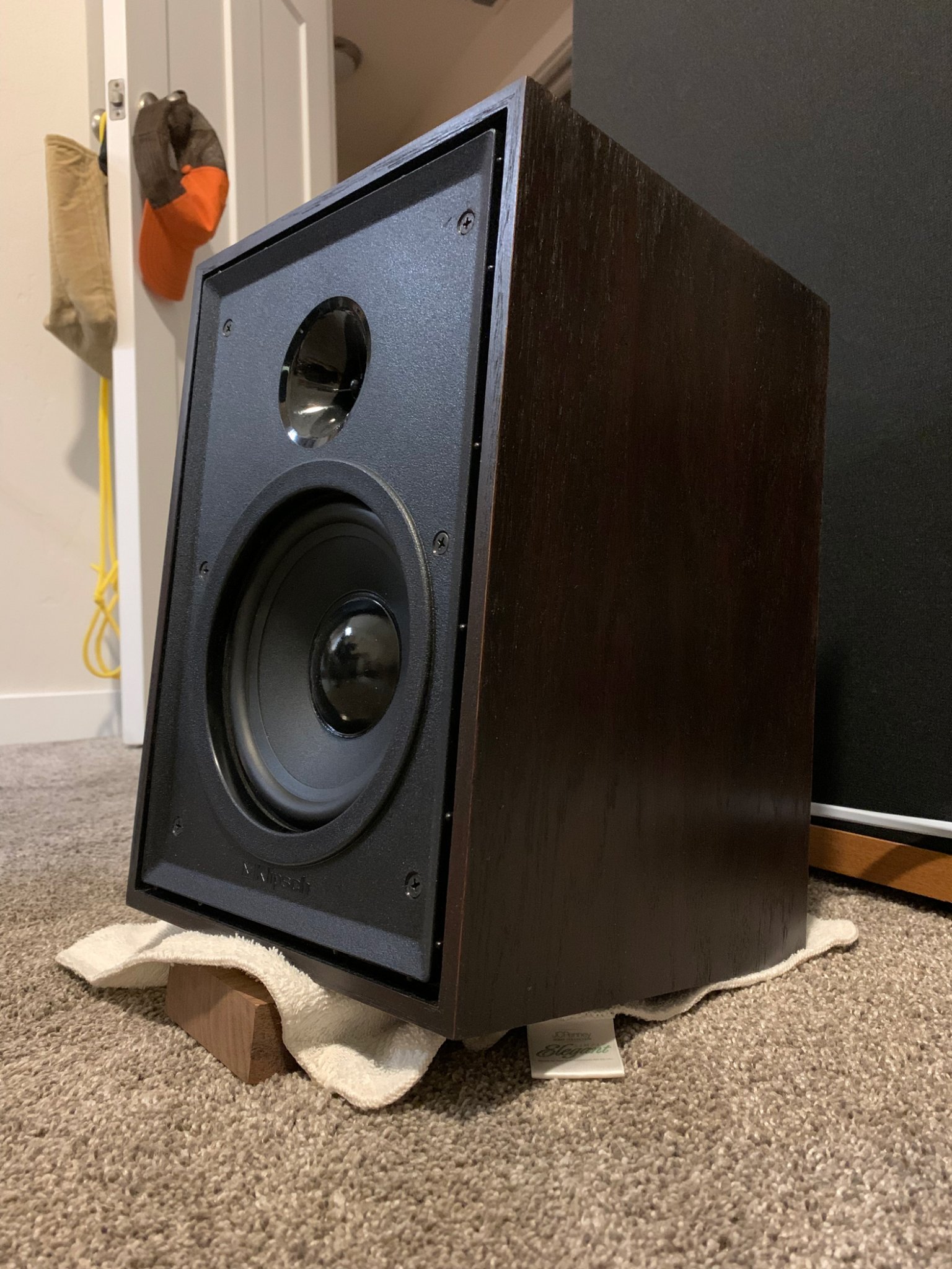

Ken, let me know how this woofer/driver replacement went. I'm in the exact same situation on a Klipsch KG-1.2v. both speakers were working fine. Took them to a friends house while he was waiting on some speakers. When his came in I brought them home. Hooked them up to an Onkyo and out of the blue one of the speakers had no bass and only weak treble. I flipped the right and left channel speaker leads and the problem remained on the left side so I know it is speaker related. I will replace both speakers woofer/driver I just want to know how you liked the speaker that simply speakers recommended.

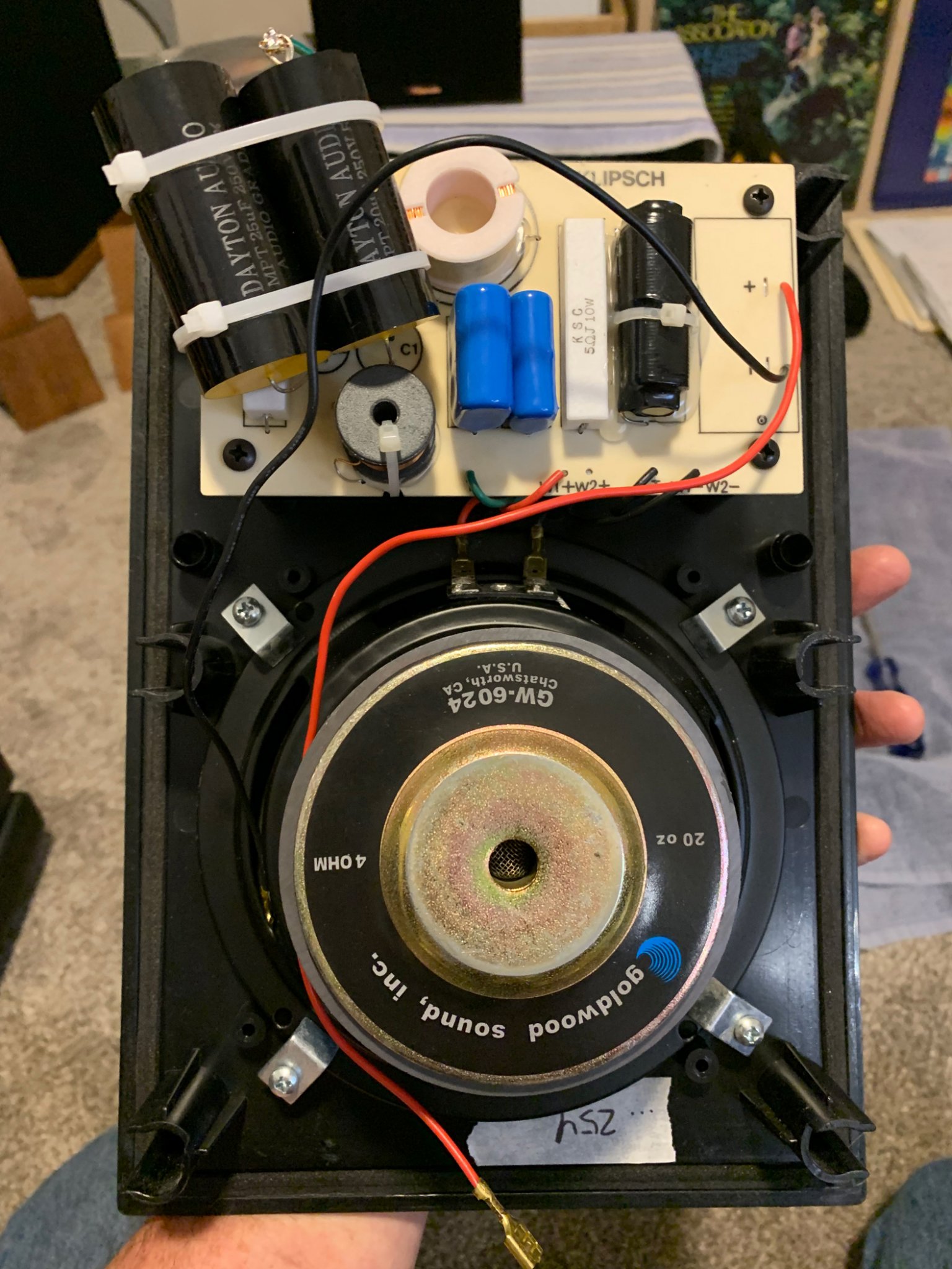

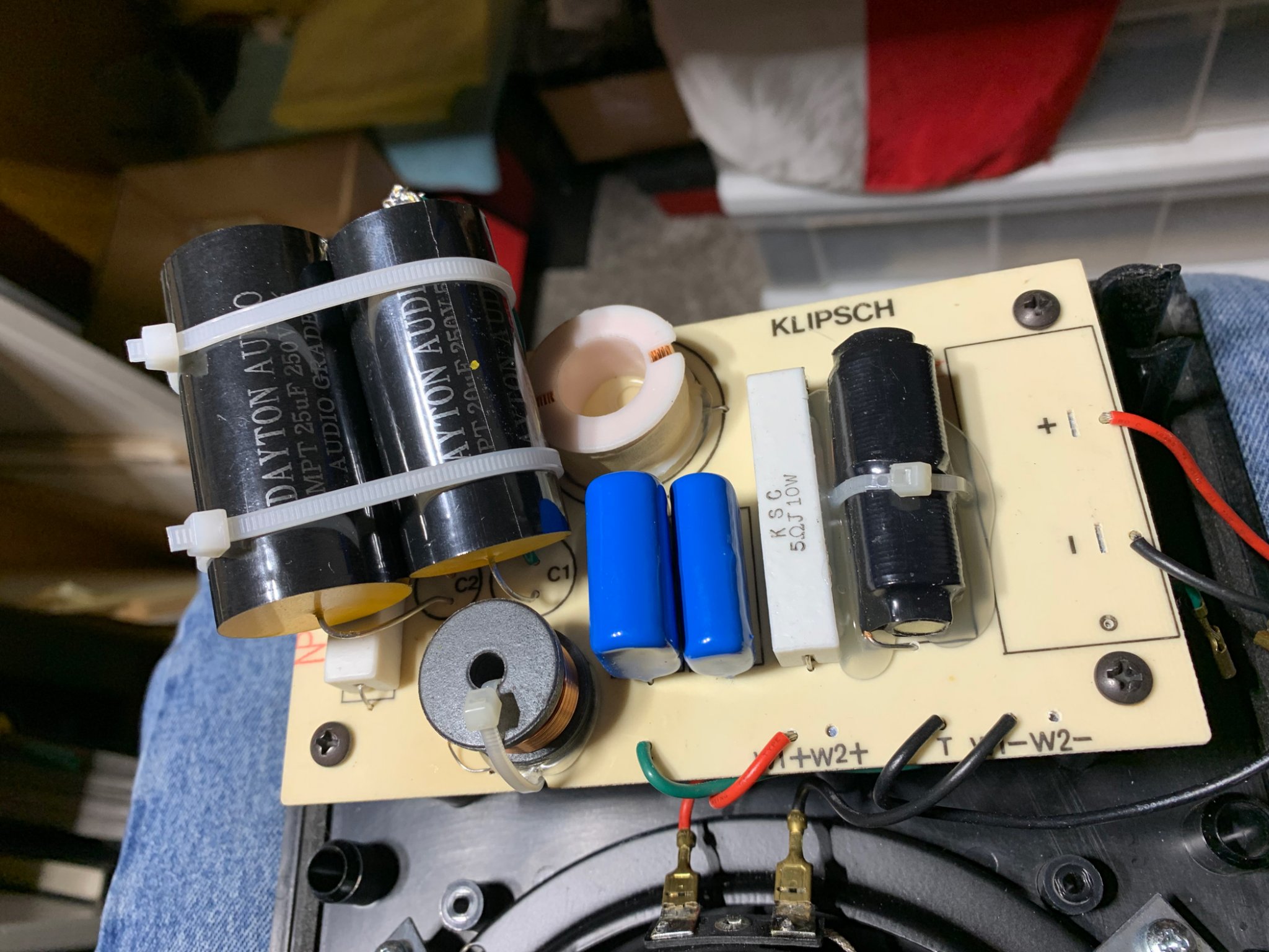

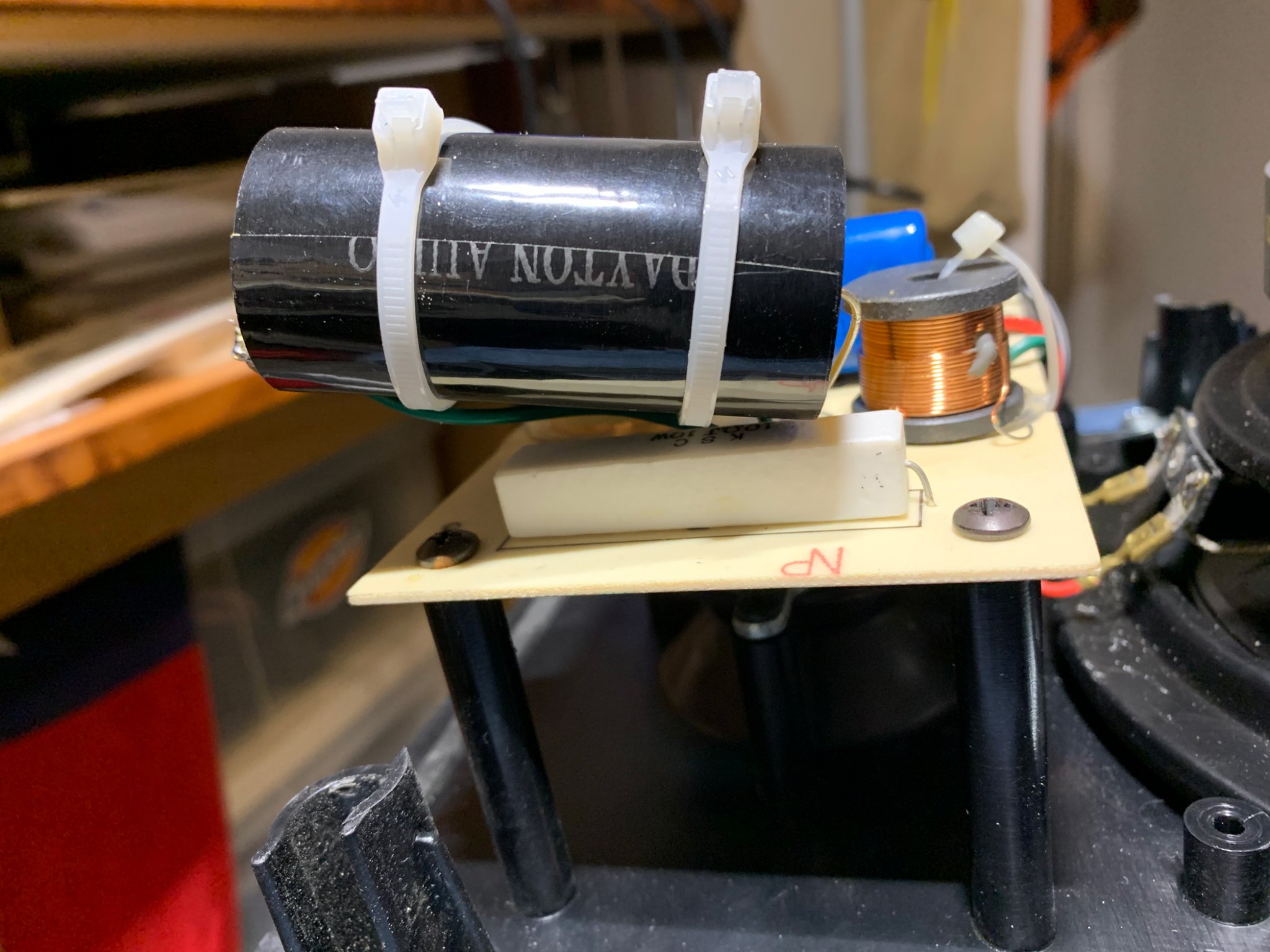

Hi Mike, yes, I did. I wish I could have heard the original woofers for comparison, but no such luck. A buddy of mine has them now and is loving them. I enjoyed them for awhile before they moved to his place ... I was impressed for the value.
I also replaced the electrolytic caps with Dayton film caps ... I was thinking to measure them out and it was a trick to get them to fit.

Wow, thank you for the response and pictures as well. they look great. And yes those caps look like they were a tough fit. I wish I could hear them. I do know before the driver in the one speaker went they sounded exceptional for their size. I guess I will do the same. I have other speakers and systems, but I can't see throwing them away or scrapping them. I kind of like bringing them back to life. I was surprised when I opened the bad speaker up to find 10-12 way dead honey beas inside the case. no damage just dry corpses. Vacummed them out before I inspected and found no damage whatsover from them. thanks again I will ldownload your pictures for reference.
