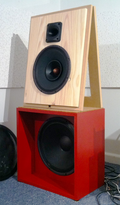

does anyone knows how to calculate the overall efficiency of a speaker with following units:
tweeter: 117db
mid-range compressor: 108db
woofer: 98db
the measurement with db-meter showed 108.3 ... what's the deal?
Be aware that there is a distinction between efficiency and sensitivity. The first is acoustic watts out for acoustic watts in and the other is SPL on axis for a given voltage. They can be converted but only if you know directivity or polar pattern.
1 acoustic watt is 109dB in full space at 1m. If your radiation is hemispheric then this becomes 112dB at 1 m for half space radiation. Most units are even more directional so you need a number for d.i. (directivity index in dB).
With a typical high frequency d.i. of 10dB then a 50% efficient horn (the maximum possible) would be 109 + 10 - 3 = 116.
Scale from there.

Did you measure them indoors? outdoors? How did you measure the input power - are those numbers you give per watt or at 2.83V? What frequency? What distance? Is the woofer horn loaded? Bass reflex? Passive x-over or multi-amp?
Ideally, the overall efficiency (in this case) would be limited by the woofer, but in reality there are so many factors that come into play that there is no one great formula to use.

the first measurement at 2.83V at 1 meter distance was 108.3... I have no idea how measuer max SPL but at 165W@8ohm they rated 124db
as I said we did measuring at 2.83V with frequency swipe... ideally the units (woofer,mid-range and tweets) will show their maximum efficiency when frequency swipe reachs to the frequency range which units are specified ... but the best thing is that testing the speaker with all 3 unites installed showed overall 108.3 db @ 2.83 ~ 1 meter distance... I think they are so efficient ... after all I think ear is the best tool to measure a speaker...Did you measure them indoors? outdoors? How did you measure the input power - are those numbers you give per watt or at 2.83V? What frequency? What distance? Is the woofer horn loaded? Bass reflex? Passive x-over or multi-amp?

the speaker mentioned above is a Klipsch Cornscala (modified)... sound very good to my ear... never heard something better... like the way they sound... the overall look is fascinating to me... the budget was something about 2000 boxes... do you think there is something more efficient than these considering the money? if so I like to know what is the idea... the cheapest speakers rated above 105db that I saw is some horn-maker brands like avantgard etc... which are all above 30-40 grands up to 100grands!!
many thanks
