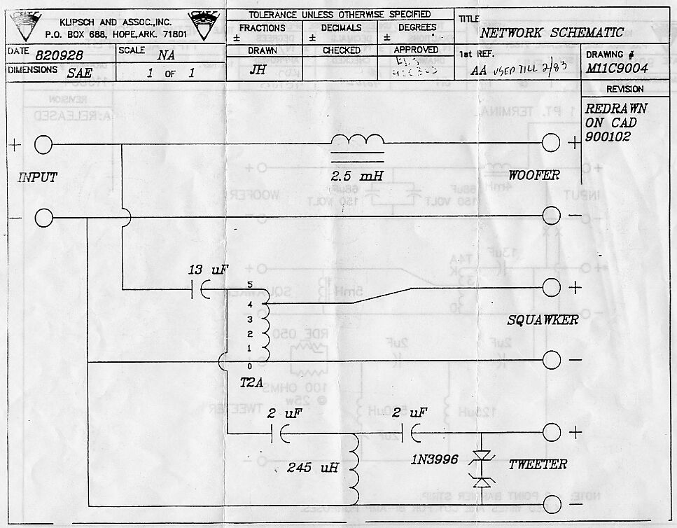

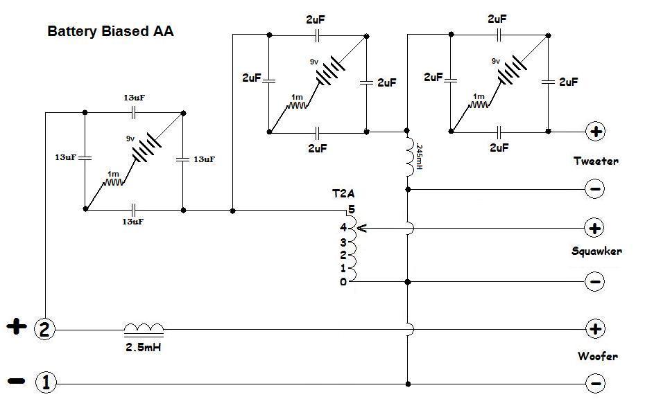

Klipsch AA network - battery capacitor charged modification
here's the original schematic....
