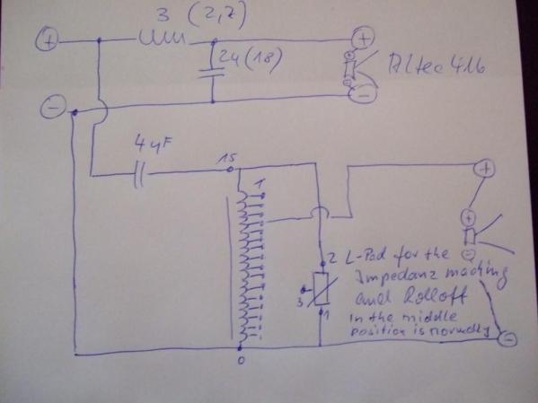

Hi all,
This is crossover for Klipsch horn speakers.
In order to improve the speakers I am thinking about this crossover.
Who knows about this guy WERNER JAGUSCH that built it.
Any information is well respected.
Best regards,
Williams
Hi, I know this guy. I once drove to Oldenburg to pick up those large Jabo horns.
The Jabo's I sold but the autotransformers I kept.
Much better than stock Klipsch.
I just performed a comparison with an L-pad on this wonderful CD: Cipriano de Rore, Ancor Che Col Partire. Outhere music RIC355
In short it sounds way more pleasant with the transformer.
Those brown capacitors are Russian paper in oils. The K40-y are even better but not available in the large values needed.
:idea:
Edit: the potmeter is used By Werner to controll the roll-off. I do not use that.

losses are probably lower for the deluxe autoformer. Did you use a "swamping resistor" on the Klipsch autoformer when comparing? What is your speaker setup? (Onken?)
Yes, I use 10-Ohm resistor on the transformer. Does not make much difference though.

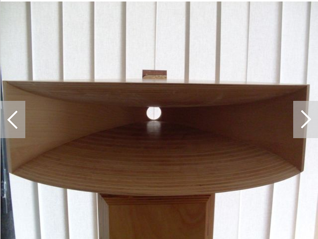

I now am using Heyder horns with Electrovoice 1823M drivers. Tweeters are JBL2404.
So only thing Klipsch left are the bass horns. 😉
