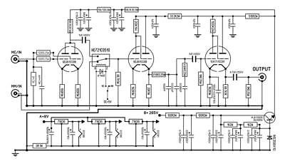

Hi
There should be a resistor, typically 100 ohms, depends on your cartridge requirements (same for capacitor if needed)
Thank you,
I will try a Little Bit higher, than I can adjust by putting a resistor parallel. My Denon DL 103 will probably bedarf igher impedance.
Check with Denon (or your manual) for the correct loading of the DL 103.
In general MC cartridges are loaded with a resistor only. Typically 100R and a bit higher. I recommend a bulkfoil resistor here.
MM cartridges are loaded with a 47K R and a capacitor in parallel. In the Pf range. Quality is important here as well.
Cheers, 😉
