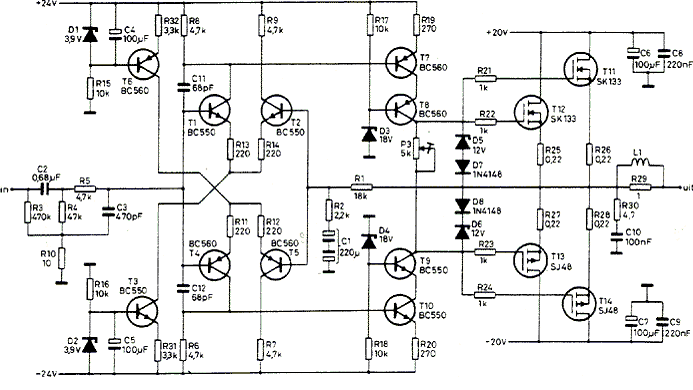

R7 and R9 are not very useful, and D3 and D4 drop a bit too much voltage, limiting output swing somewhat...
The design is like a blueprint of the Elektor Crescendo 1985 and is "fair" but can be enhanced of course.

ilimzn said:R7 and R9 are not very useful, and D3 and D4 drop a bit too much voltage, limiting output swing somewhat...
Isn't it beneficial to 'balance' the differential pair of transistors? Because I think the Idea of R7 and R9 is to match R6 and R8. I have matched hundreds of small transistors to get high hf and matched pairs.
If R7 and R9 is not very useful, what is the drawback of puting the resistors on that location? Will these resistors contribute to the noise? By matching the differential transistors I also hope I can get rid of the current resistors R11-R14 (to limit the noise floor).
peranders said:The design is like a blueprint of the Elektor Crescendo 1985 and is "fair" but can be enhanced of course.
You have built many amps from 3886 and 3875. How do you compare this amp to NIGC? Which one do you prefer? I hate to say that I like NIGC better than the standard mini-crescendo (also the elektor crescendo). I don't like the muddy, laid back vocal from the mosfet. I know that the amp depends on pre-amp, but I haven't got the right pre-amp so far.
So, going class-A (with the mosfet) is an approach to have better vocal. And I don't need much power either, so the rear-end is

Yes I know. I meant a 'reference' for K135/J50 based amp (mine is more similar to mini-crescendo). My Hitachis are NOS. I just feel responsible to build a good amp out of them 🙁
So the slew rate is the problem. Then the front end should have higher rail like that of mini-crescendo? I don't know electronics unfortunately, so I just change the circuit and listen. What do you think with the rear-end having 17V rail? (I don't need high power).
Oh, I also tried to build as carefully as I can so I can get rid of small caps on mosfet legs. This will also increase the slew rate right?
Mosfets have capacitance, as with capacitors current has to run in them before voltage rises.
General rule is : Risetime=0.35/ Cornerfrequency
For a decent output signal at 20KHz, nowadays 150 KHz bandwidth would be the bare minimum (i prefer it to be much higher)
The drivers have to push enough current in the gates of the output mosfets to have the voltage rise fast enough.
A bc560 transistor can handle 500mW, with front end powersupply voltage at 24 volts across collector and emitter the device dies if the current exceeds 21 milliamps.
If the gate of a N channel mosfet still carries -24 volts a single bc560 driver could only deliver 10.5 milliamps before it fries itself to death.
Stacking 2 bc560's has the advantage that they partially share the voltage load.
R19 and R20 are there to protect the drivers from collapsing.
Unfortunately this limits the ability to make the voltage rise fast.
On top of that the bases of T7 and T10 will not be able to receive/release enough current.
Regular bc560's have an Hfe of around 200 at decent output currents.
The current source around T6 delivers only 1 mA to T4 and T5, same with T3, T1 and T2.
Half of the 1mA goes to T1, with a signal on the input T7 is allowed to deliver more current into T1, but no more than T3 will allow to pass through it.
In this design the bandwidth was limited at the entrance to limit TIM distortion, which even then isnt that wonderfull.
Means:
if you wish to make it better you need a driver with higher power rating that will enable to lower the values of R19/R20, higher Hfe of the driver or you have to add a current amplification stage to the circuit.
I've built better 4 stage circuits with BD139/140 drivers for the Mosfets.
Could be worse, the original circuit used carbon resistors, ceramic capacitors and only a 120VA transformer for 80 watts of dissipation.
For those who wonder why 20 watts need 4 TO3 can mosfets: the design was meant to do full class A in 4 Ohm !!

Err... Crss for those K135/J50 Hitachi FET's is only 10 resp 40 pF and that's what counts for source followers, not Coss!
BTW Hitachi FET's dont have any such numbers as 3000pF Coss, rather 350 resp 400 pF each.
Say compare to IRF540/9540, these IRF's are much worser regarding capacitances, especially Crss.

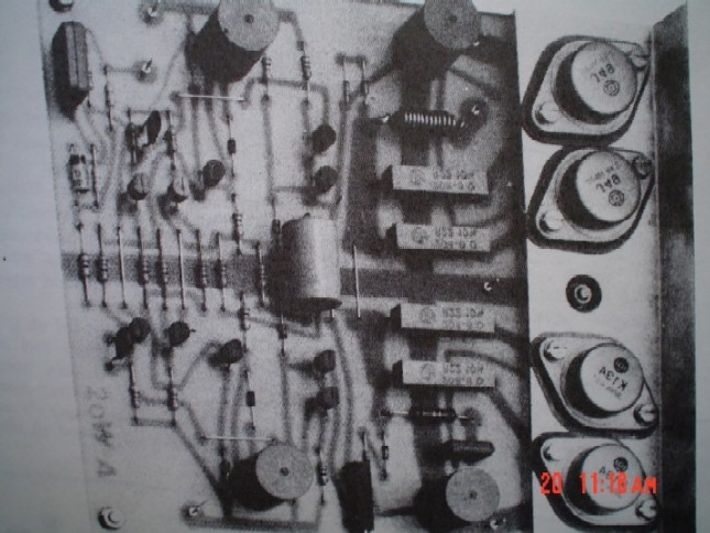

The picture you added, I noticed there's those wire wounded source resistors which is a big cause for ocillation, should be replaced with carbon film resistors.
Regarding modifications I would roughly make following changes, add a driving stage between VAS and output FET's, remove C11 and C12 and add a feedback capacitor from VAS to diff stage.
Quiscent current in VAS is around 6 mA, half that value and keep those BC550/560 and change D3 and D4 to a couple of volts higher values(R6, 8 ,19 and 20 must be recalculated) and remove R7 and 9.
And of course make sure output FET source resistors are carbon film.
Cheers Michael

I do take it that separating Vas and driver stage by adding a driver stage between Vas and output stage will be a big improvement to distortion figures ?
How about upgrading the trimpot to a Vbe multiplier, the value of the gate resistors and the feedback ?
The advised heatsink was a 0.4 K/W model, 2 amp bias.

The A75 was the last amplifier i constructed in 1995, after finishing Mr Thagard's 100 watt 1990 mono design, after that 10 years nothing.
The output devices i used for the A75 were 630/9630s because i couldnt lay my hands on TO3's.(see datasheet of the irf230)
Performance of the 20 watter is in no way comparable with the A75.
