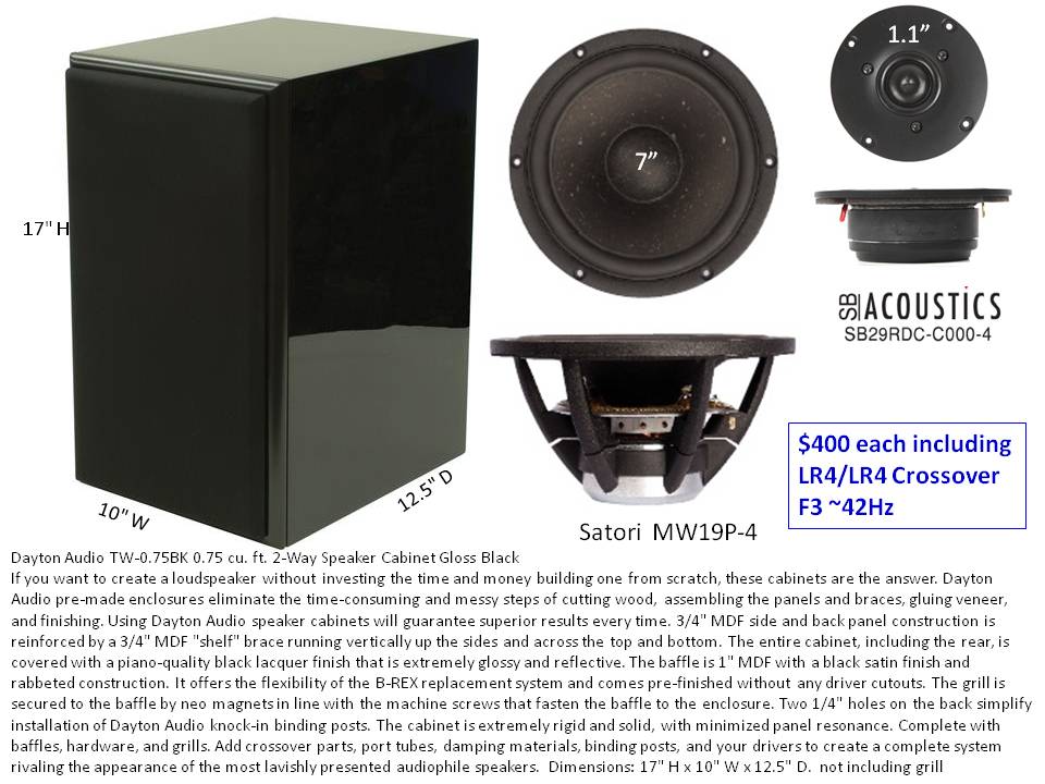

At a lower price point, Troels has a new Satori 2-way monitor using the 7" MW19P midbass with the TW29RN tweeter on a time stepped front baffle in a 24 liter ported cabinet. Troels designed an LR4/LR4 crossover at 1700Hz. 88db/2.83V, Zmin=6.2ohms.
MW19P-8
If you have a friend with a router, you could purchase decent cabinets from Part Express.
