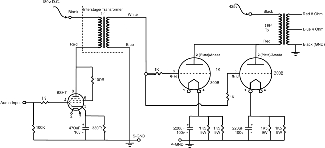

Thanks for all your help. I was wondering what advantage their is to using an interstage transformer in place of the driver tube. That seems to be one of the differences between
Audio Note 300B's and most others. I saw that DIY sells an interstage, but obviously felt using the 310 was better overall in their amp.
I would think the transformer would be more linear, however, I don't know about the sound, whether it would become a bit analyltical compared to an all tube design.
I was just wondering if that was a potential design that was looked at when you designed the latest Lux amps.
There is no advantage as it is not possible to do so. An interstage transformer essentially takes the place of the interstage coupling capacitor. You still need a driver tube however.
Most interstage transformers are 1:1 so they do not really offer any different signal as capacitor coupling. Of course, interstage transformers have a number of additional sources of non-linearity over a capacitor. Depending on how it is done the resulting Amplifier can be better or worse.
I have found that most interstage transformers are by far too limiting in bandwidth and have iron based cores (amorphous iron is still iron) which I dislike in transformers for low level signals. Tango and Tamura (James too IIRC) do offer some permalloy interstage transformers which I do happen to like, but a pair of these approaches "donating a kidney for cash" territory and still need some trickery in implementation.
I generally try to work without interstage transformers as a result.
The key difference between capacitor coupling and interstage transformer coupling is that the impedance at the grid of the output tube progressively increases as the frequency lowers, which means that at high power levels the grid current from the 300B is handled better.
My personal "budget" alternative to this is the use of a gridchoke together with "DR.P" (Damped Resonance Parallelfeed), which goes a long way to redress the situation or indeed "my latest trick" (Yes, that was Dire Straights on Brothers in Arms), which I call the "Bushido" circuit. It forms the core of diyhifisupply's lates generation of 300B Amplifiers, the Lux and Lux 91 but cannot easily be applied to your Amp's.

No, not really. Very few AN-UK Amp's ever used interstage coupling and AN-JP never used any IT coupling. In fact, AFAIK non of the AN-UK 300B AMp's use interstage transformer coupling and only the AN-UK Ongaku and Ankoru use IT coupling.
Here a schematic of the quintessential AN-JP Amp, the Ongaku:
Audio Note Japan (Kondo) Ongaku
Why would you think that?

Thanks for the explanation. I asked as on the Audio Note kit page, they have a mono block kit that uses an IST and suggest that it has advantages over a non-IST design.
As you say, you can design amps many many ways, and you get advantages and disadvantages, as well as prices differences that can many times explain the advantages very quickly (the "you don't really need any kidney's pricing").

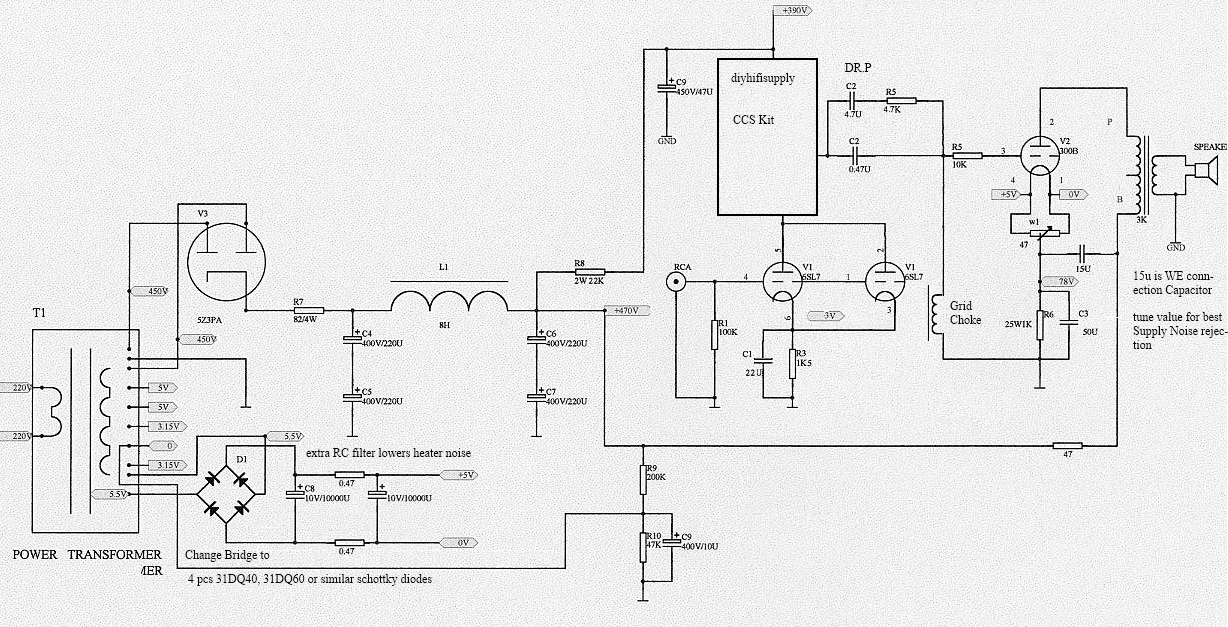

I'm planning on the MU circuit. The DR.P mod you mention, is that part of what I'm doing already with the Gridchoke mod or is it a additional mod for me to consider?
I do not think it would be approriate to make specific comments about specific products from a competing manufacturer here. But I would look at what AN-UK and AN-JP do in their best 300B Amplifiers...
DR.P means you connect a snubber (I would suggest 3.3K & 3.3uF) across the coupling capacitor (I would use 0.33uF or 0.47uF with the above snubber).
My other comments regarding IST's basically came from what was on that page for the amp (I think they call it the Mono interstage if I remember correctly). My thought on the linearity was based on the premise that you would not be driving the IST near saturation levels and that a transformer (well-made) would not be subject to the sound differences that occur with caps due to the large number of different materials and designs that occur with them.
Hmmm, transformers have many problems of their own. airgapped transformers have very limited primary inductance, which limits their LF response, also, air-gapped transformers rarely use permalloy cores, so their sonic merit is quite limited simply by the core material (worse if they do not use 0.05mm steel laminations).
Equally, they need to be quite large physically (to handle substantial DC current) and need high impedances, which means winding for good HF response is at the best very difficult. Of course, few transformer winders attempt to make IT's that offer the same wide bandwidth as capacitor coupling routinely allows. Due to the "law of the 400k" this tends to work okay sonically, even though the bandwidth is obviously limited, if the transformer is designed well.
Compared to for example to a CCS Load with a gridchoke an interstage transformer will usually have much worse (lower) impedance at low and high frequencies, only in the midrange can it offer similar linearity.
In addition, there is usually a claim that interstage transformers removes coupling capacitors. This is of course patently untrue, refer to Lynn Olson's "Current Loop" presentation at ETF (available at nutshellhifi.com) for more.
So, in the end IT coupling can have some advantages over capacitor couplings, but most of these can be attained using other means as well.
Making a good Interstage transformer costs as much if not more than making a good medium power output transformer and even then the transformer is unlikely to match the bandwidth of other options. If this is a possible problem or not depends on musical tatse and speakers used (e.g. those with Speakers that omit low bass and high treble will not notice the problems, other very well might).
hope the mods will tame that issue without destroying the underlying detail, and keep the wonderful mids I love.
The "Hot high frequencies" are mostly (IMHO) down to tube choices and the heater supply. Try some good NOS 6SL7's and warm or neutral sounding 300B's. If the Amp has it's original tubes, these sound quite steely and bright.
With my Billy Kit I did not listen to the supplied Chiense tubes (O&J aka Valve Art) for long, the chinese 6SL7's where pulled within twenty minutes of listening. I used with the Stock Billy Svetlana 300B's (sounded quite close to WE) and some nice NOS 6SL7's, I liked the Ken Rad ones very well. I also rather liked the TJ Tubes.
The Heater supply modification tend to reduce edginess and grainyness.
The Powersupply Mods and WE connection of the output stage extend this, the WE connection also gives a more solid presentation and more of the oh so famous "black background".
The Hybrid Mu-Follower adds more detail and slam.
Gridchoke and DR.P extend slam and make the Amp subjectivealy capable of playing notably before compressing or breaking up.

Thorsten, received everything I think I need, and have mapped out the mods, but the changeout of the coupling cap has me a bit confused.
I am planning on two changeouts based on our discussion.
Looking at the schematic for the M500 you posted, the cap labeled C1 100uf is being changed out to 22uf film caps as per our discussion.
The other coupling cap you refer to I assume is C3? which is 150uf on the schematic.
The confusion is that the link I ordered from specified the new cap as a .22uf cap, which I choose as a Audio note copper PIO.
Am I really changing the 150 to a .22, or do I have the wrong cap (and/or ordered the wrong value cap)?
Also, to make sure I'm in sync with the schematic, the grid choke replaces R6 on the schematic?
Everything else makes sense and I have determined the best way to install them, its just the value of the cap that has me thrown a bit.
Thanks for all your help!!
Best, Bruce Prager
I am attaching a schematic of the M500 with my suggested MINIMUM modifications applied. This does not show the Filament Supply, but a simple CRC filter, for thse who want to keep costs to a minimum.
The coupling capacitor is marked C2 on both Schematics. Value is uncritical, minimum 0.1uF. My mod schematic shows a 0.47uF coupling capacitor. The 4.7uF/4.7K "snubber" across the 0.47uF cap is the fabled DR.P.
In simulations I have found that making the DR.P cap 10 times the value of the coupling cap and making the resistor in KOhm equal to the DR.P cap in uF seems to work best, but I have not done much experimentation. So feel free to try other values etc.
No, R4 (the grid leak resistor).
Also, my schematic shows the original power supply, however I would recommend to convert it to the schematic shown in post #2.
Ciao T
Thanks Thorsten.
The pwr supply change is the addition of the 10uf cap before the choke and the move of the 220's? I have that mapped and have the 10uf as a gold Obligatto.
Also, I am adding the 47R resistor and the 22uf cap as was circled in green on the first diagram in post #2.
Didn't realize quite how big that 22uf bugger was going to be however extending the case depth is quite easy so I'll stuff it in somewhere. I notice similar ones are used your new amps. Those are really packed, I definitely admire the skill it took to lay out that much componentry and get it all to fit so well.
I originally ordered .22uf coupling caps. Can/should I still use these, or return them and get .47's? I had picked the copper AN PIO's.
The 15uf and snubber components? Do they need very high quality components or are they not as critical? I could go with Hovland or Auricaps if critical, resistors aren't hard to get.
Everything else seems to match my workplan, so I really appreciate you taking the time for the schematic. It helps to have a frame of reference when you are doing things like this. Otherwise its easy to get lost and misunderstand what goes where.
