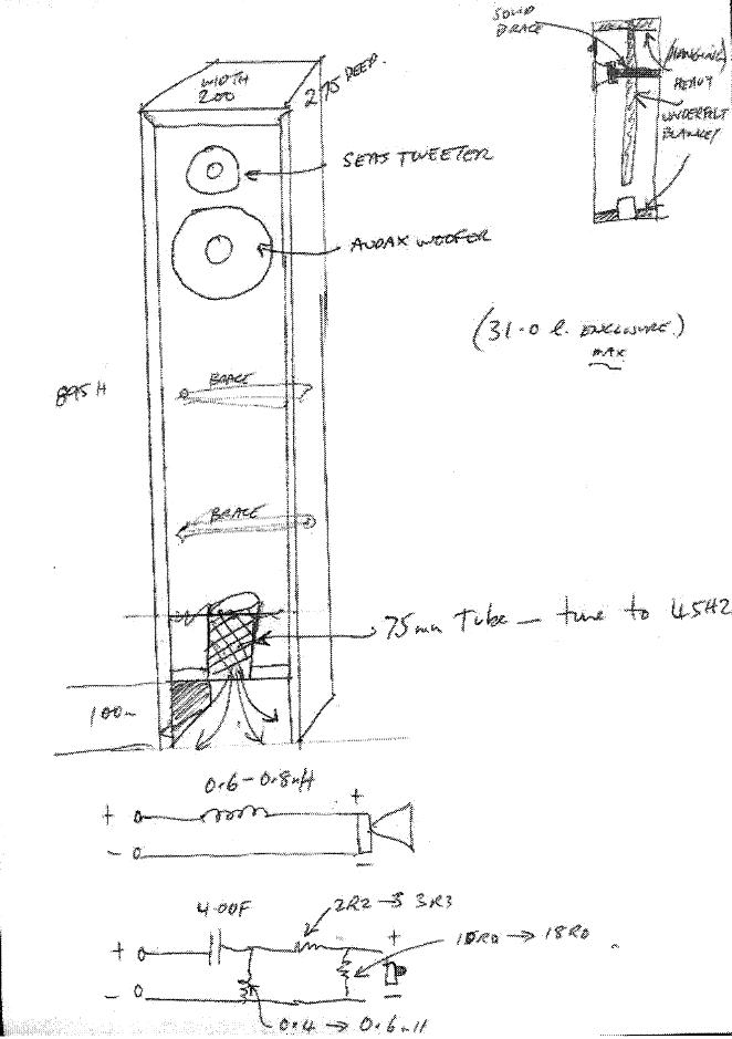

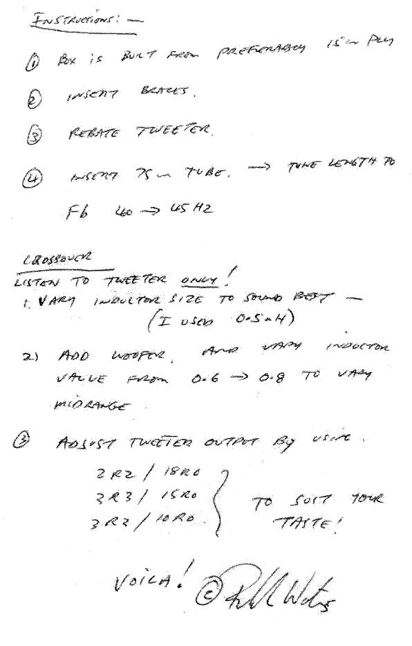

Ralph Waters included some sketch's on how he would go about doing the floor standing version. They have a down firing port of 75mm tuned to 40-45Hz, a brace behind the woofer and some heavy underfelt hanging from the top. busy night at work tonight, will try get the pic's posted and sketch's scanned and up tomorrow night so this thread can have another design to chew on and some eye candy. I hope the pic's came out OK, they were pretty rushed 😱
I'm a bit lost to say the least, tuning vent tubes and best practice for speaker building etc. someone want to point me at a good book for getting to grips with this stuff?

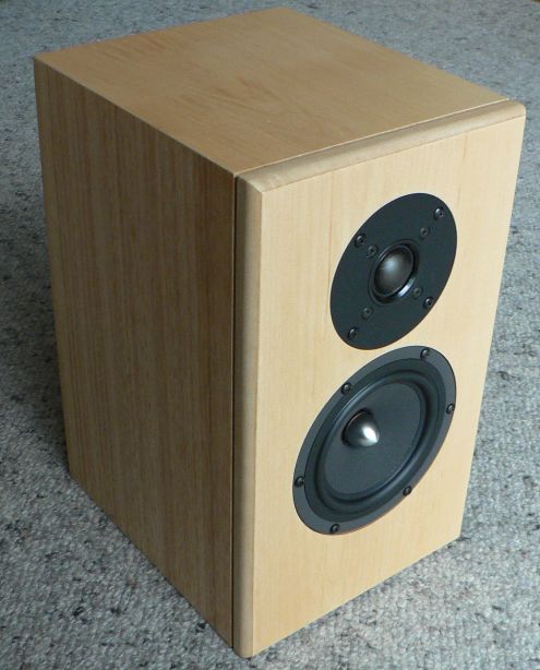

I'll take a punt and say these speakers should be better balanced and have more bass than the Atoms. It's a hard call with the Dynaudio but to give you some indication here's a comment (post #303) on the little Vifa speaker design in the wiki compared to a Dynaudio Contour 1.1 which shows a DIY can hold it's own quite well.
http://www.diyaudio.com/forums/showthread.php?postid=1766678#post1766678
The speaker in this thread should sound a bit fuller than the little Vifa speaker (design is now dead as drivers no longer available) in that example. Please remember that these would not produce much bass under 60Hz due to the small 14 litre box design. To go down to 50Hz would require another 5 litres + which is taking it towards the floorstander size.
I haven't built this speaker but I do know what Ralph's speakers sound like and this would be close to the early Richter Merlin of around 1990.

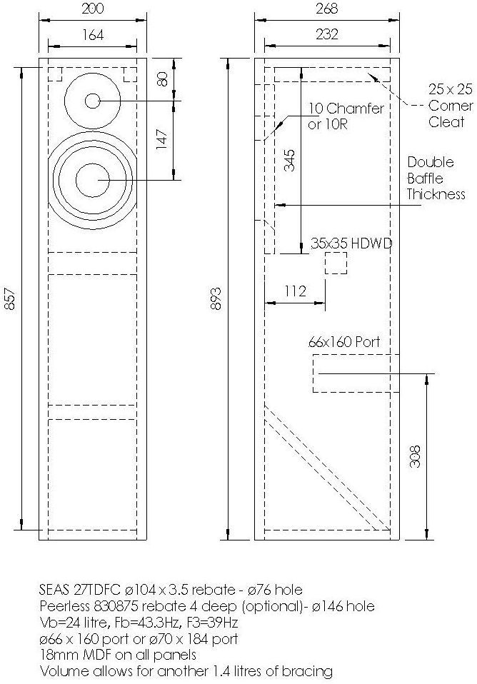

To help and give you a guide I've added a sketch of a similar floorstander which uses contruction very similar to one of Ralph's designs from 1990 which used similar woofers from Audax (HT170G2). The design is not a drop in but can help with ideas and box proportions and ratios.
Would I see much benefit from an increase in volume to about 18L.

A volume increase to 18 litre would be quite noticeable with added weight to the sound from added extension in the bass.
A cube is the worse shape for a speaker (subs OK) as you want all XYZ dimensions to be different. Generally ratios are used to achieve this such as Phi (golden ratio) or variations so use of irrational numbers are used (different panel resonance etc).
