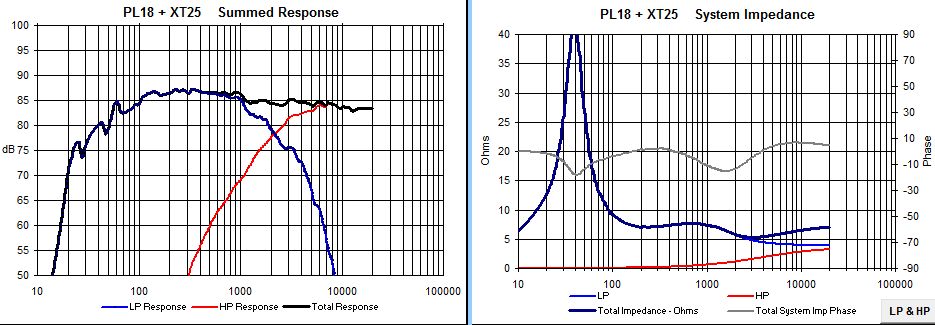

Here's one you can try (even cheaper) using the Nebula crossover schematic reference numbers and values of some of the caps and inductor will be able to be used in Troel's xo if you don't like it. It's similar to the crossover I used in a XT25/18W8531 speaker that worked well.
L1=0.1mH (0R05 - 0R08)
R1=3R9
C1=20uF (parallel 2 - 10uF)
L2=1.5mH (0R3 - 0R6)
R2=8R2
C2=8.2uF
C3 not used
Place 15R damping resistor across tweeter +ve to -ve (parallel)
Tweeter wired -ve polarity
The pic shows the plots for FR and Z.

Cheers for the help. Are those component values to be used with the Nebula schematic?

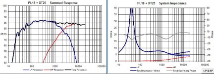

Yep... use the Nebula schematic designations but tweeter -ve polarity.
If the tweeter sounds harsh then use L1=0.08mH (remove 5-6 turns from a 0.1mH depending on bobbin size.... we can tell you exactly) and C2=5.6uF as this increases the crossover point and takes more load off the tweeter near it's Fs. L1 needs a low DCR (0R05 - 0R08) as this helps protect the tweeter. 1.5mm - 2mm wire would do the job.... no smaller.

OK cheers. I'm not quite sure what tweeter polarity is but I'll figure it out between now and then.

-ve tweeter polarity means the +ve speaker wire is connected to the -ve terminal on the tweeter. This gives us correct phase and summing with the mid woofer and if we don't, you get a suckout (null) across the crossover frequency (see graph).
