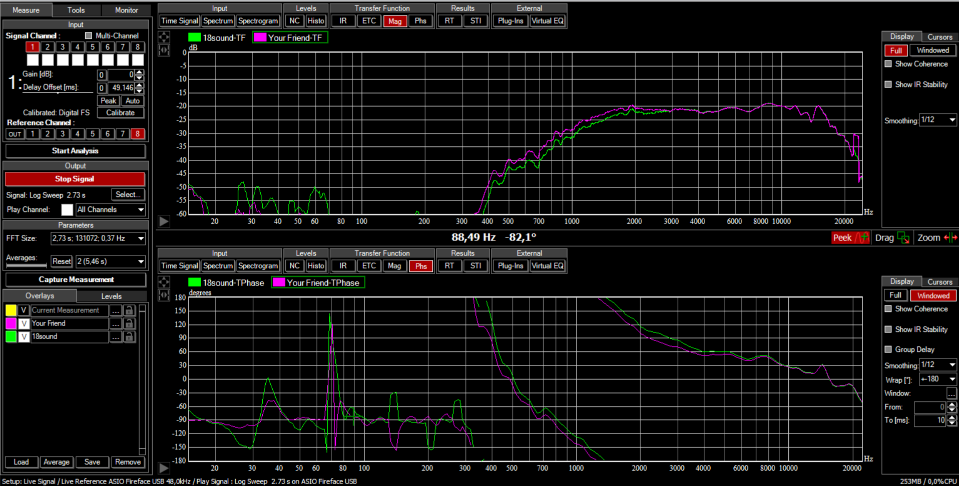

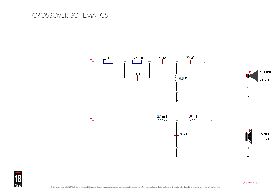

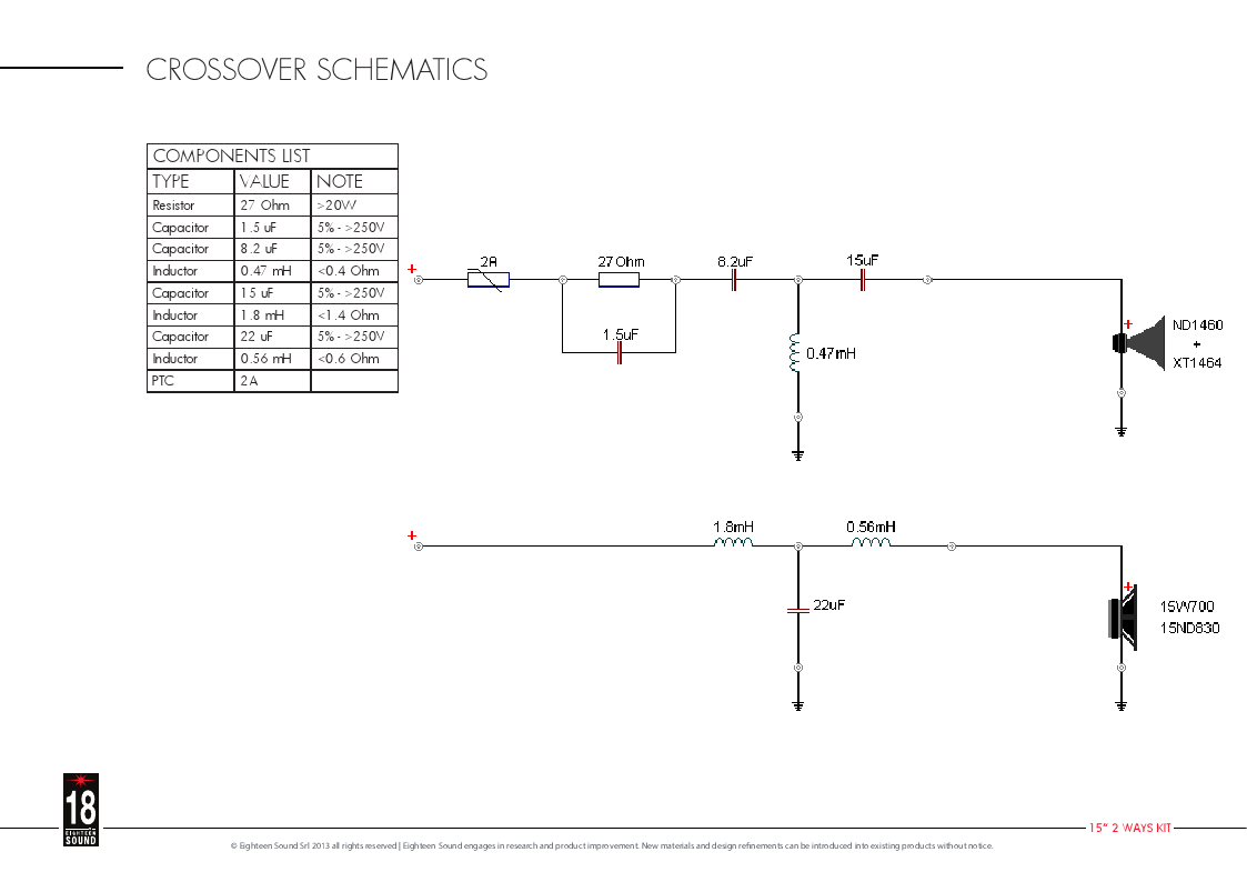

a nice Norwegian friend passed me some information.
in turn he too made an acoustic diffuser with the same components but made some changes.
he suggested that I build a 130 liter box.
for reflex loading he suggested that I use two tubes of 11 cm in diameter and 17-20 cm depth.
he passed me the crossover filter scheme he made for his speaker. he told me it crosses at 800Hz. in the attachment you can see the original crossover filter and the one he modified.
if you have patience I have a few questions for you.
can I only change horn waveguide with another one that has the same frequency range and the same 1.4 "throat but with a sound radiation angle that has a greater angle? ..
in this case I would like to know if I can use the crossover filter and all the acoustic drivers that I already have available.
is it possible to separate the woofer box from the horn compression driver for convenience of transport?
can I eliminate the thermistor which in the image is identified with the code 2A?
Bigger box, lower tuning and lower crossover frequency are definitely good ideas.
You can use your driver with another 1.4" horn but you will have to adapt your crossover.
You can also seperate the drivers if you like to do so.
Regards
Charles

-In the second image you posted, where 18sound gives the Technical Data the picture of the horn is not the XT1464 but the XT1086
- as Phase Acourate already answered, different horn usually needs different crossover
- you can eliminate the 2A PTC, if not activated it will have quite small resistance.
Overall for Hifi use you did not purchase the right Kit IMO.
The woofer you have is not very well suited for producing enough base in a passive design, the 15W750 from 18sound would probably be a better choice.
But now we are talking about a completely different speaker.
Regarding the Crossover from your friend see attachment:
They do indeed show the xt1086 on the picture but the building plans do definitely show the xt1464. And I assume that the crossover is also designed for the 1.4" waveguide and driver.
With the correct box it would definitely be possible to reach lower than the original kit. And yes, I would still cross around 800 Hz.

although i can find the right horn unfortunately i am not able to design a crossower filter.
I wonder if among you there is anyone so kind willing to make me some simulation.
for final tuning I'll see what I can do
