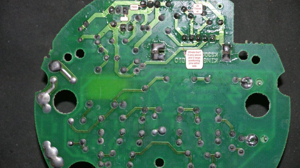

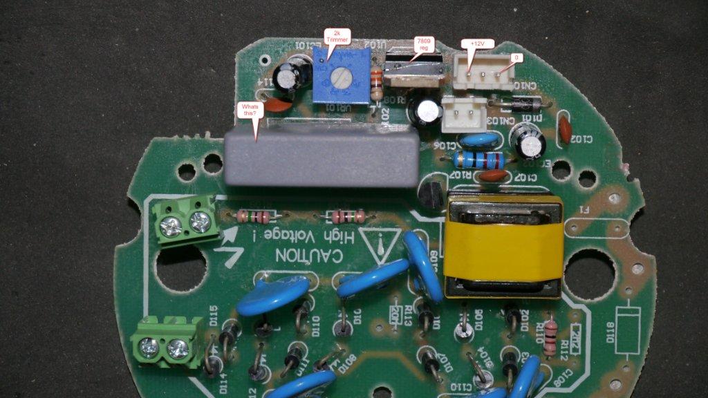

I replaced one of the midrange HVPS with a spare that reads 5.8KV.
The other was actually ok. I was just not making contact with the meter as its pretty cramped.
The other bad news is that when Rob (ER audio) had a look at a burnt bass panel he put his high res meter on the diaphragm and couldn't measure anything. Checked his meter on one of his panel and retried and it was the same.
It looks like the coating is loosing conductivity which explains the recessed bass/midrange. I am using a Bryston 4BST on the woofer panels and an old panasonic pro amp on the tweeter with a Rotel RB1080 on the TL subs. The mids are over 5db down on the other 2.
All the tweeters seem OK and the previous owner hadnt changed any out.
The very high bias current used may be a reflection of this degrading conductive coating and very heavy diaphragm?
It looks like it may be a fair bit of work to get these panels going properly.
If I do I would probably need a lower bias current as my ER Audio ESLIII panels don't take much more than 2.5KV.
