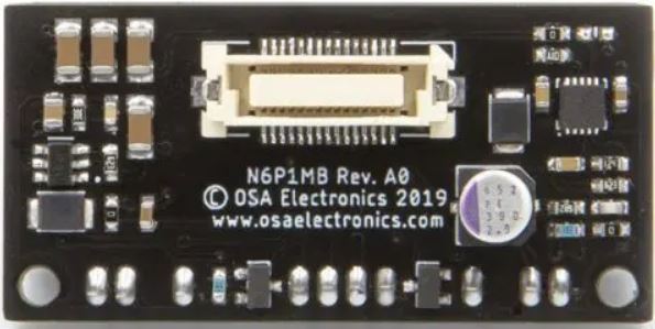

- I do like the power supply regulation, decoupling and the capacitors used (attached photo)
- there's little doubt that the engineering that went into designing this board... can never be compensated by such a low price, so kudos there to designer
I will not comment on the choice of the DAC chip; the implementation seems okay, so that should not be a main deciding factor not to buy the DAC board (however, judging by what others say, it IS a deciding factor indeed for some, and I respect that as well)
