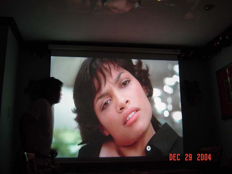

Thanks for that information. My other reason why i want to use ir filter other than heat reduction is improvement of color of image and i guess it will somewhat improve a bit the contrast also.
regards,
PS. attched image is from MIB2-superbit copy. Its the dvd copy i've seen better than 5th element.
hertz
regards,
