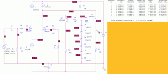

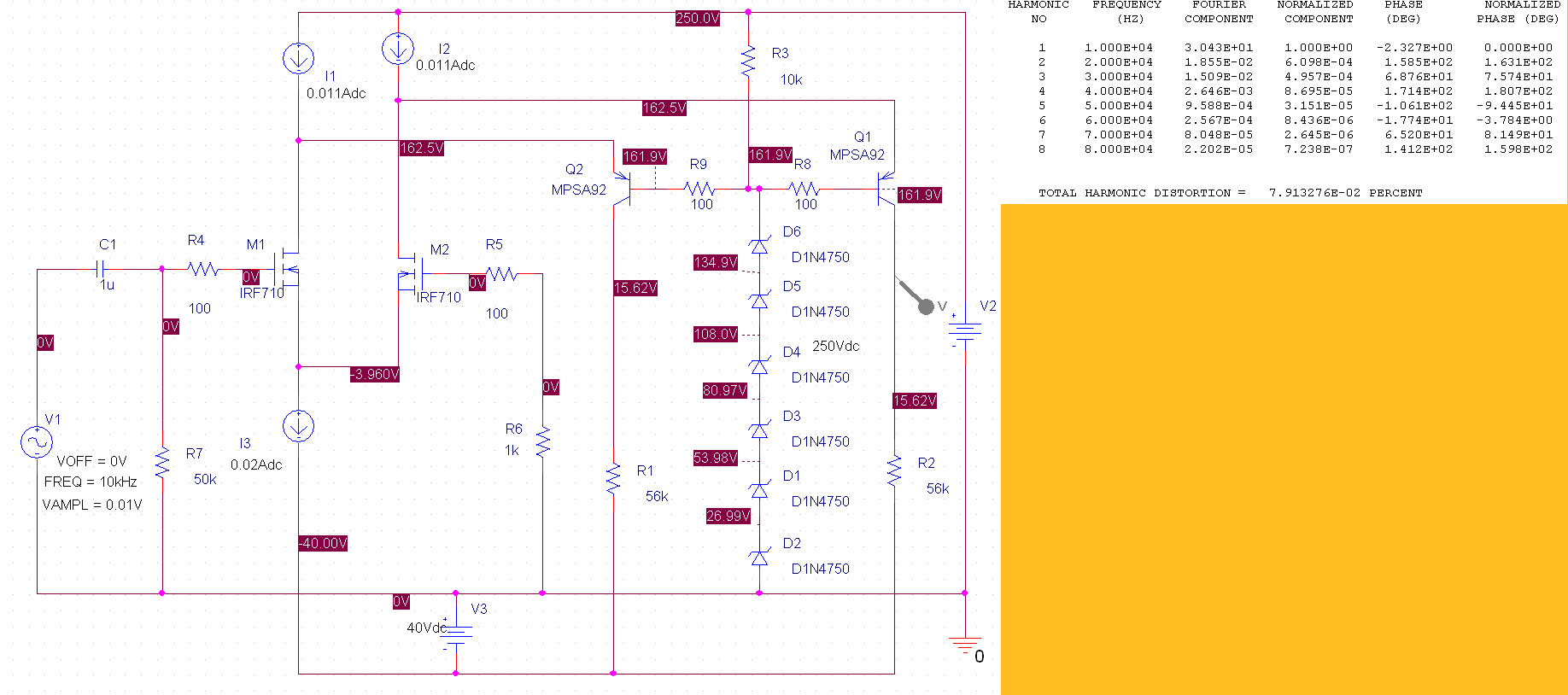

Her's a first stab at the mosfet input stage. Output voltage is ~45 V. I'm pretty sure I can do better, though this is not bad for open loop and this level of output voltage.
