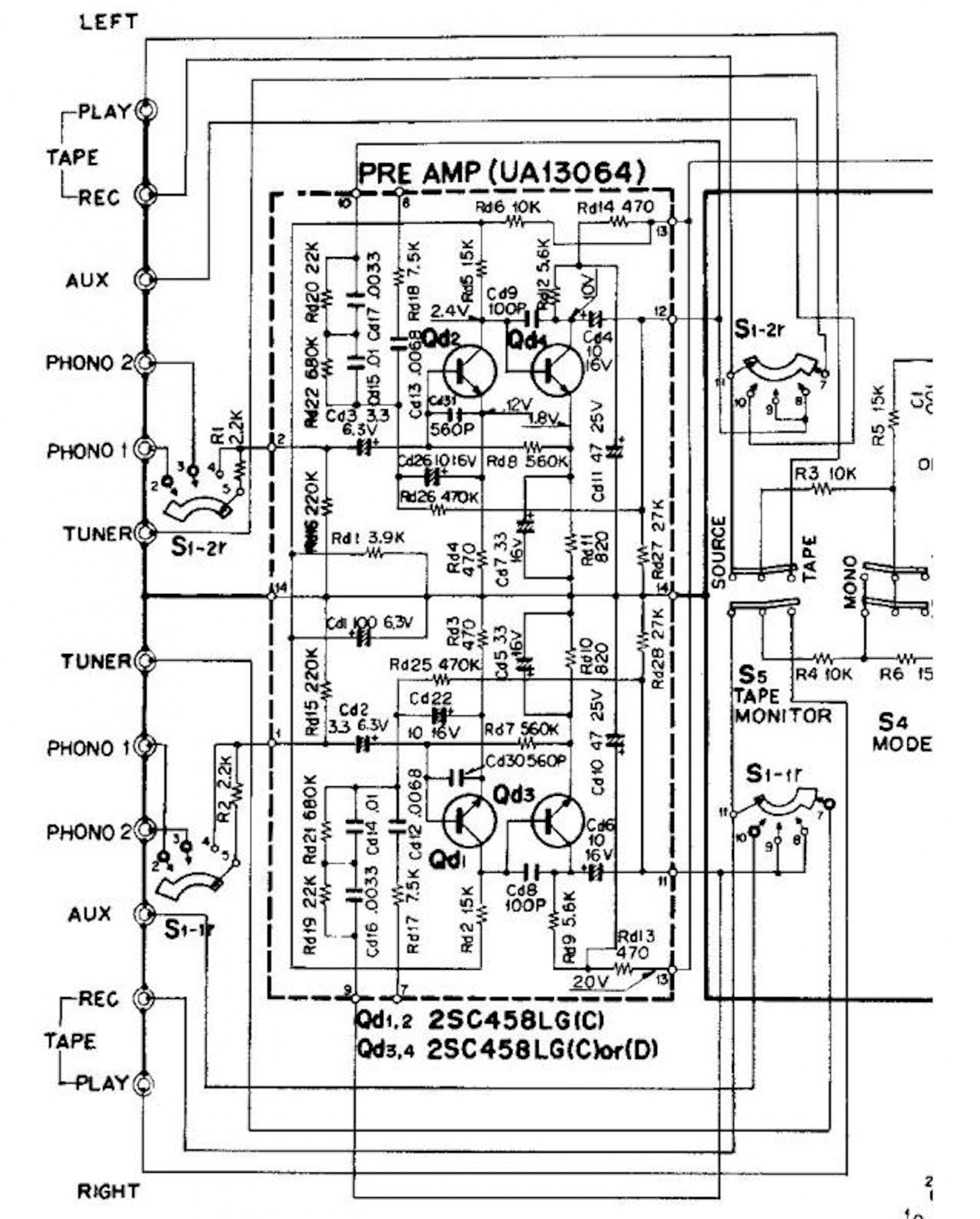

reinstall issue
Hi, I have reinstalled the 2sc458s after they all tested fine with my tester. In the process I inadvertently pulled the wires from the Tuner/Phono1/Phono2/Aux selector switch.
Thinking ahead I had taken pictures but of course the one of the selector switch is unclear as to where four wires go from the pre-amp board to the selector.
The way I read the schematic (excerpt attached), the wire that exits the pre board at C16 is also connected to the wire that exits the pre board at C6, then both go to the selector. The other side is a mirror with C17 and C4 going to the selector.
I see no numbers on the selector switch and have been unsuccessful at guessing which ones are to be connected. The designation on the schematic for the switch is S1-1l and S-1-2r
Am I being stupid? Wait, don't answer that.
Thanks.
Thanks.
With the selector set to phono there should be continuity from the tape record outputs and the terminals the pre should connect to.
Hi James,
You can do a similar thing with your finger on the selector switch terminals and hear hum for each selection on your input selector switch. You might find that is easier to do.
I can't believe that you didn't damage the switch! Amazing luck! Just work at a steady pace and you should get through it okay.

I have been referred to as a Bull In A China Shop on more than one occasion I must say. I may very well have caused some minor damage to the switch - it is old and fragile. So, I am being very careful with my bull hooves in working with it.
I do believe I am lucky and just need to revisit each and every solder point on the non-working side of the preboard. I am concerned that I am not reading the schematic right though.
I attached it above because I do not understand the theory behind why the two wires for each side connect just before reaching the switch connection. If they connect they must both be carrying a positive signal? Where is the ground?

Hi James,
Your audio signals are all referenced to "ground", so since all the common part of the audio inputs are all connected together (in common), you just need to route the "hot" terminal of the jacks that carry the signals. If you were using a balanced type of system internally, you would need to switch both conductors.
Your question isn't a silly one and we all have to learn that at some point in our lives. Just remember that wee don't tend to draw in the common connections in a conventional diagram as it would only clutter up the schematic and make it harder to follow.

I could not seem to get the right side to work. I have tested and compared all connections good side/bad side. The two 2sc458 transistors all test fine with my Peak tester but I am getting no audio from that side.
While playing an LP on the TT, if I took the good side pre outputs connected with an alligator clip and touch either side of the selector switch I get strong audio on both right and left channels. That told me that downstream is fine.
Assuming it was possible that transistors that tested fine are actually not I dug around in my parts bin and came across a set of four NTE193 (gasp) which are roughly equivalent to a 2sc1845 which in turn is a higher voltage version of 2sc1815 which is I think a direct replacement for the 2sc458. Put them in and voila! Audio both sides clean and strong.
The cool thing for me is I spent no extra money and used parts I had on hand albeit roughly equivalent and now it works. It has more bass punch than it did before. The power filter cap went from 2000 to 3300uf.
Thanks All! I am going to button it up and listen to my little 13 watt wonder for a while.
