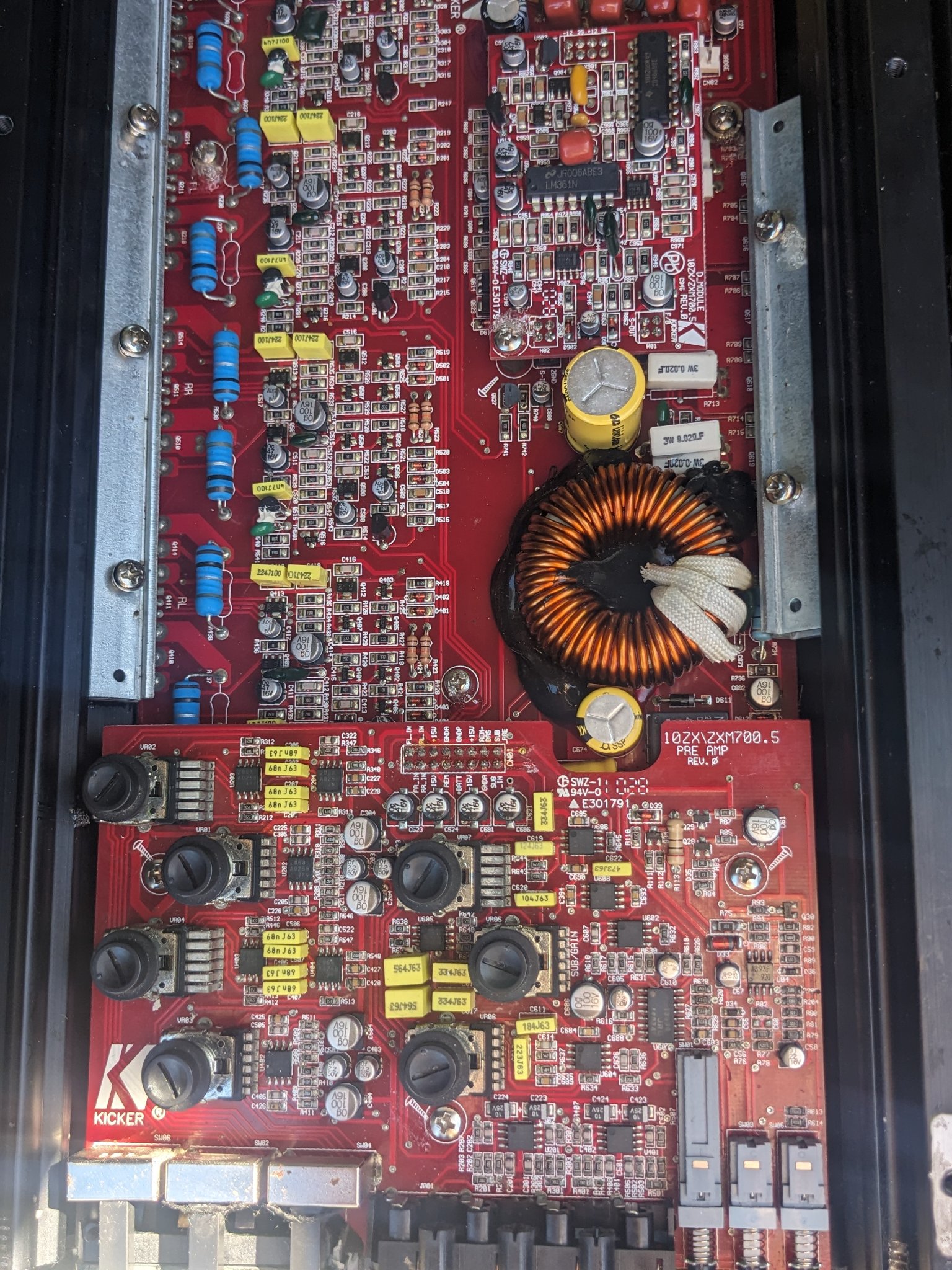

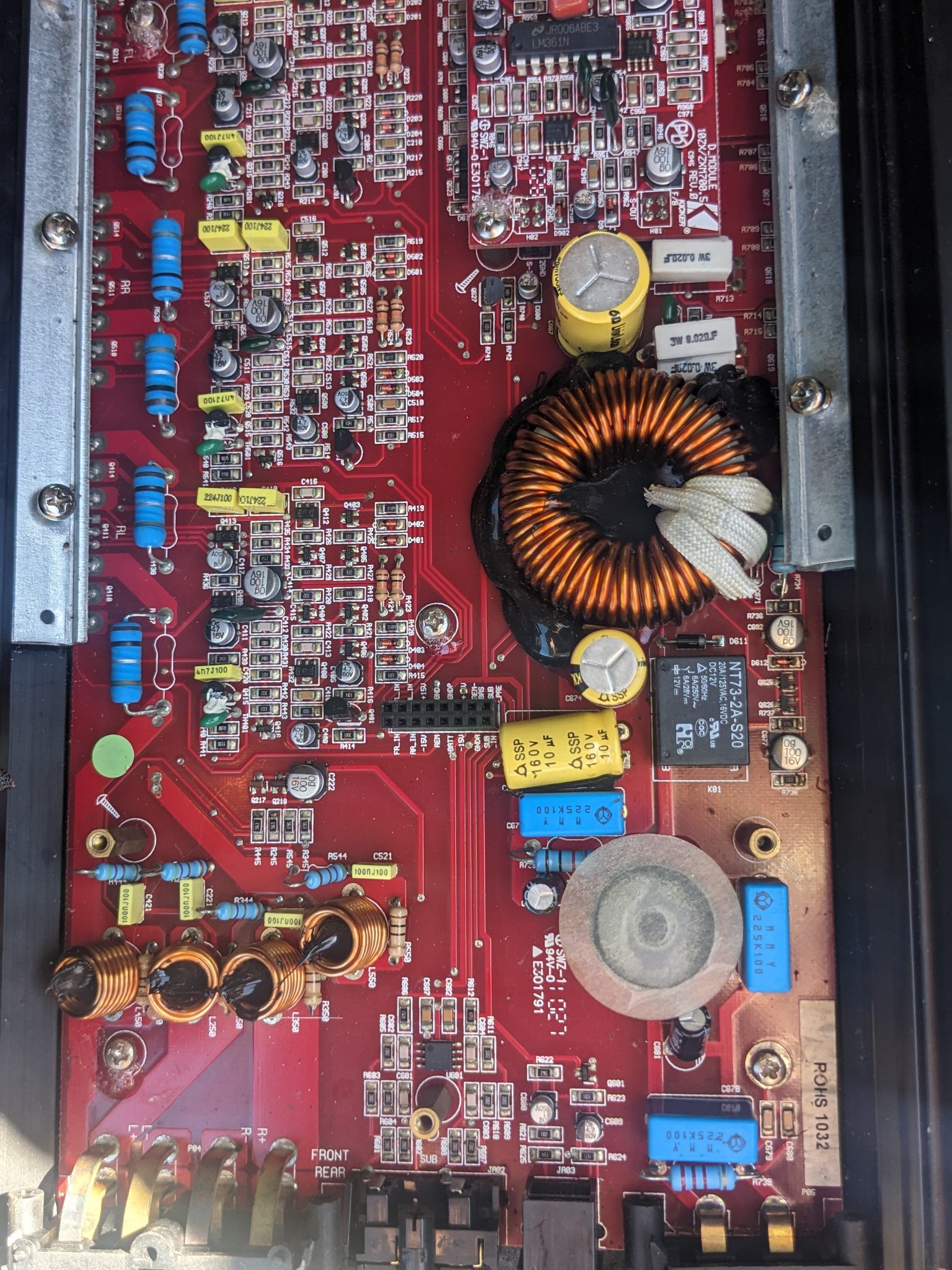

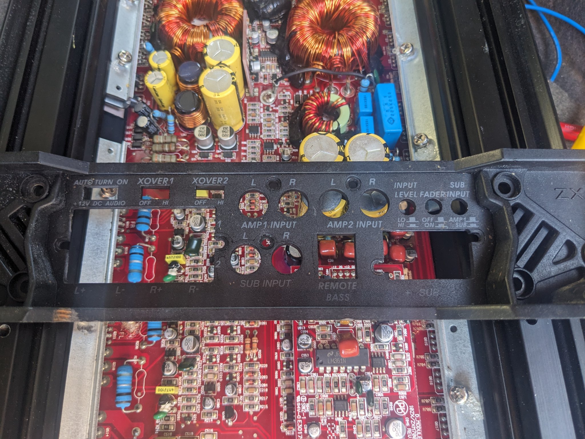

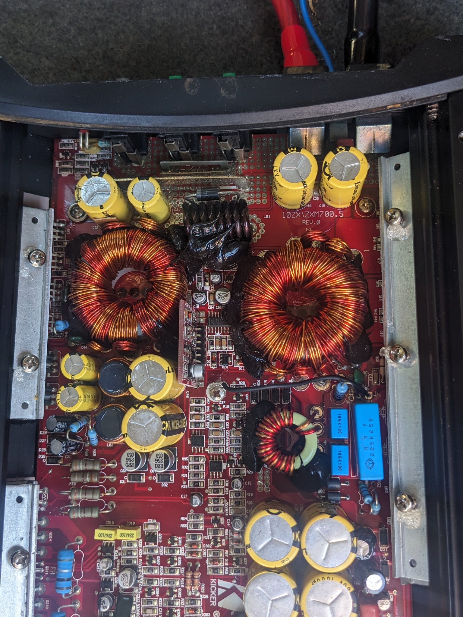

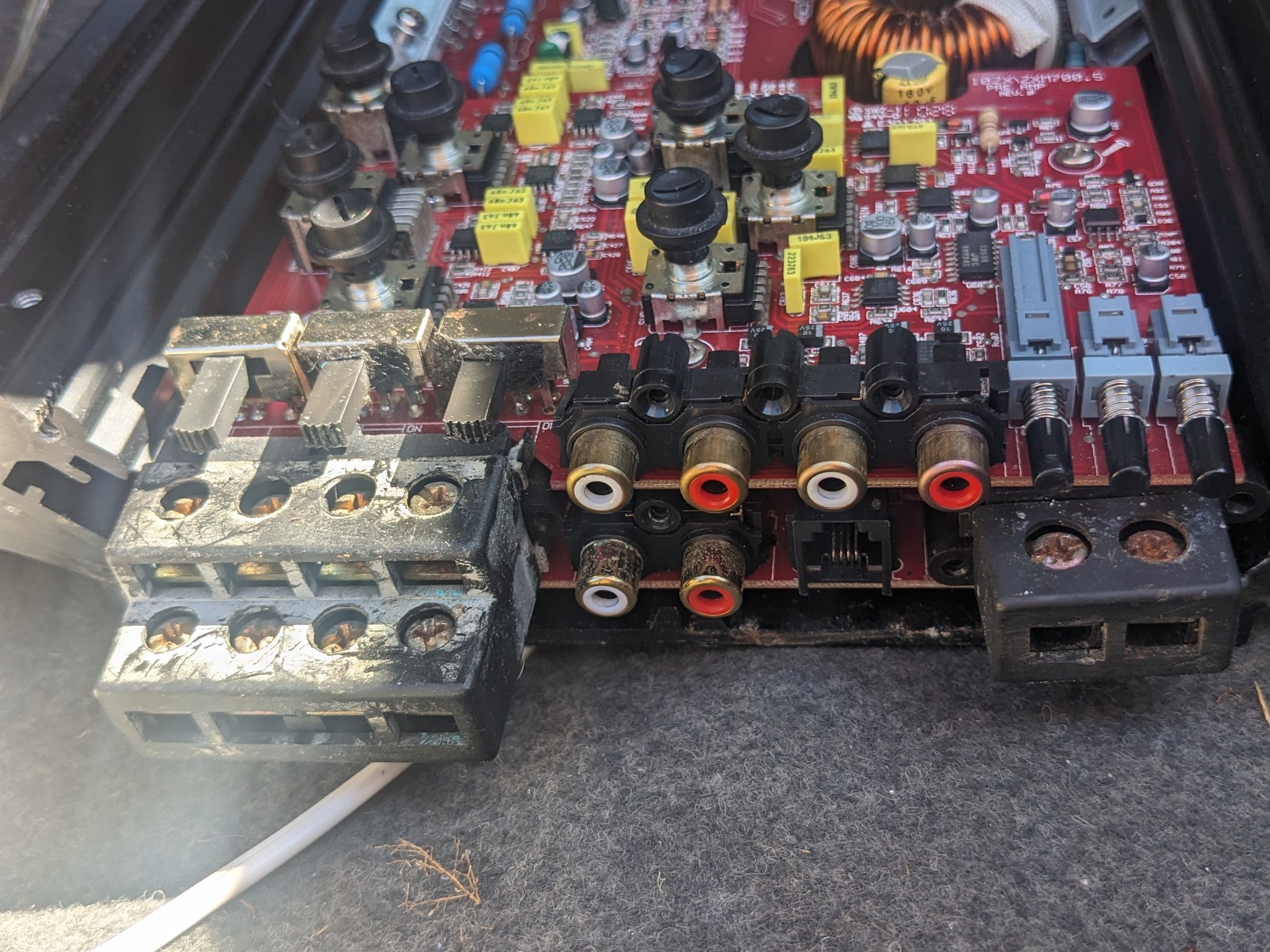

Hello I have a Kicker zx700.5 that I got at a yard sale. Amp2 seems to work fine but amp1 outputs have very low volume in comparison like it's muted. Sub works fine. I can hear something buzzing on the amp but I haven't located it yet. Any suggestions? Thank you
Here are some measurements I took from the preamp board to speaker ground:
Fr in -18.3 mv
Fl in 9.6 mv
Rr in -19.3 mv
Rl in 10.0 mv
-15v -14.14 v
+15v 13.95 v
Rem 11.51 v
Gnd a -4.5 mv
+ Batt 11.63 v
Gnd p -4.5 mv
Rem- bas 12.3v
Sub in 15.3 mv
Sub pre -4.4 mv

Some of the kicker amps have an input sensitivity switch. Does yours?
I haven't tried feeding both inputs so I will try that next. Yes, there is an input sensitivity button that you press in if you use a high level signal from the source unit. There is also the fader switch which you press in when two inputs are used. I will try feeding the high level signal and see what happens and report back. Thanks!

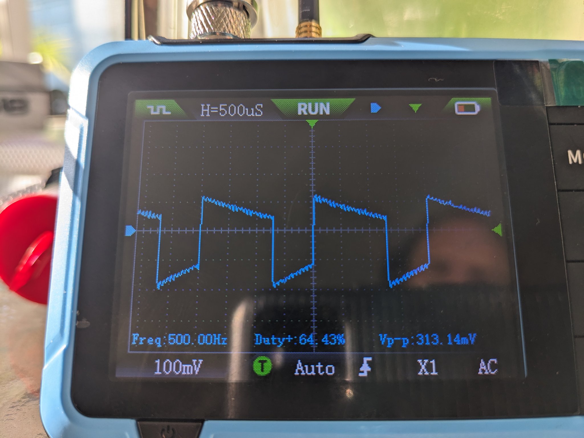

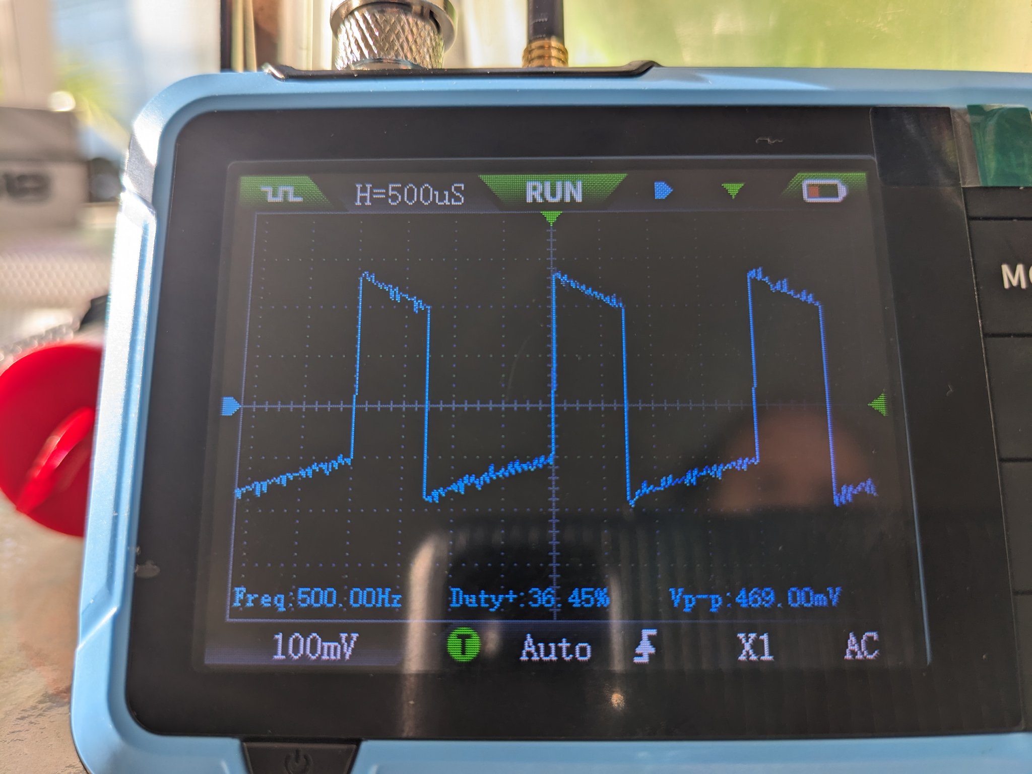

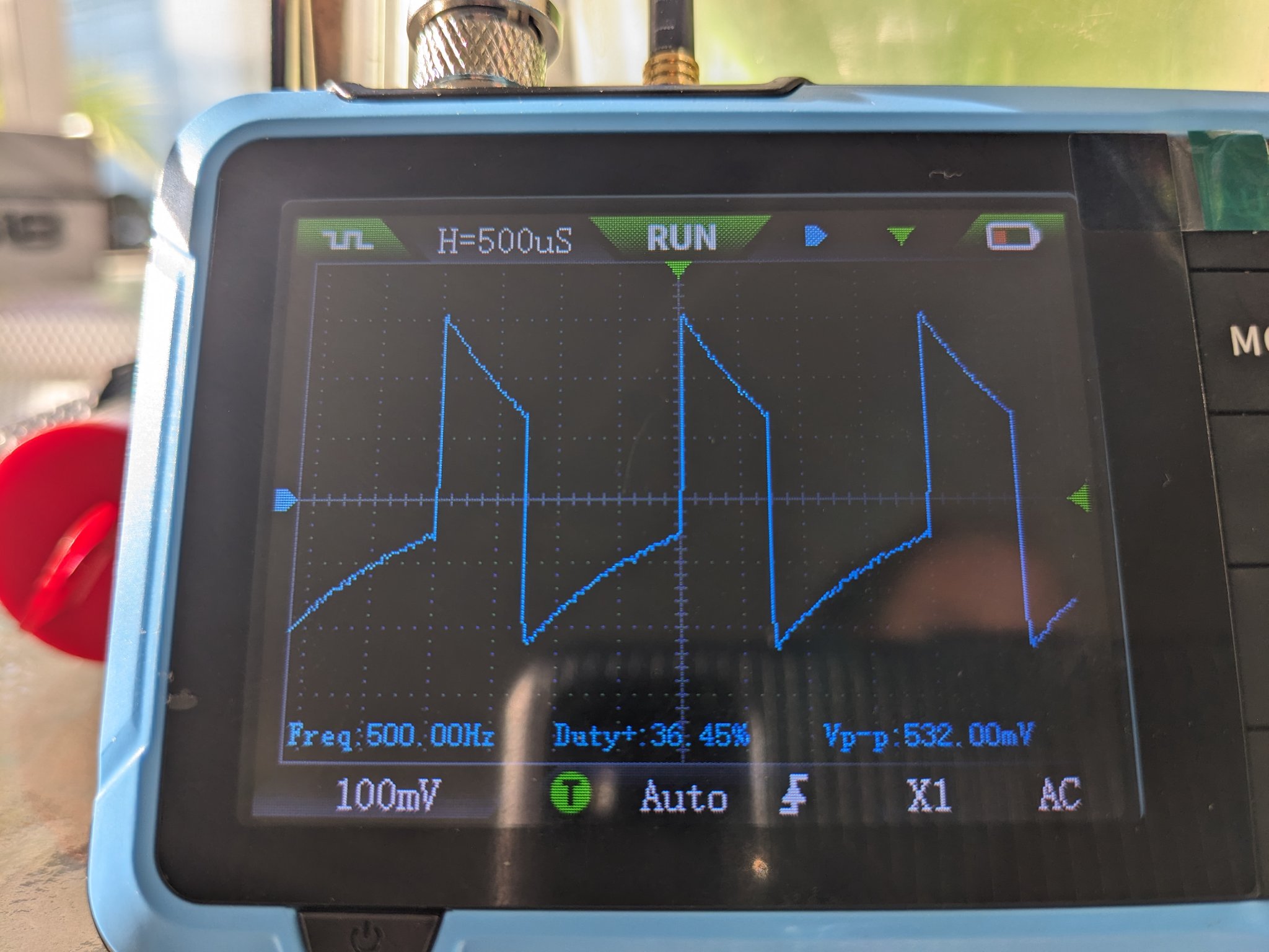

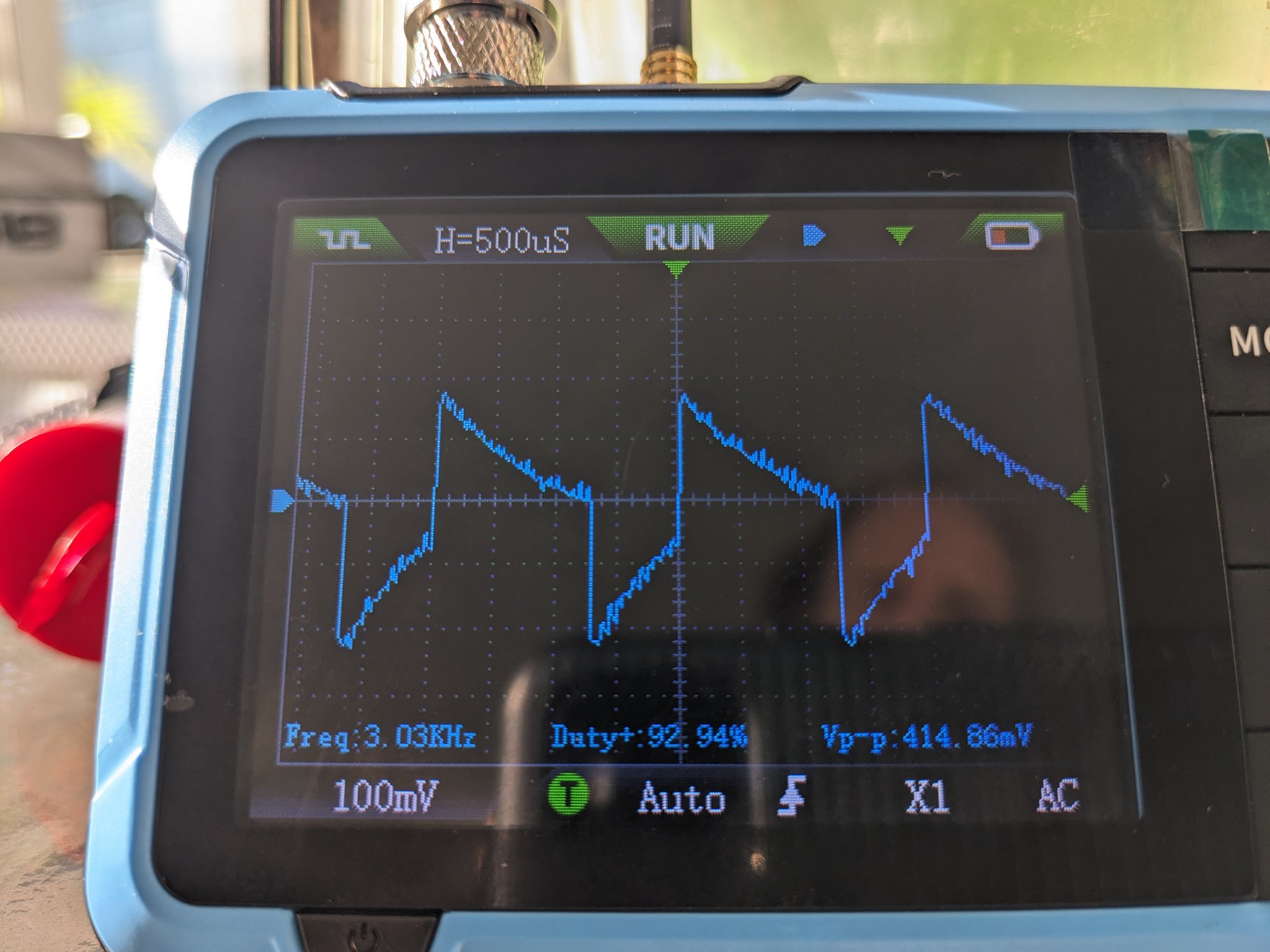

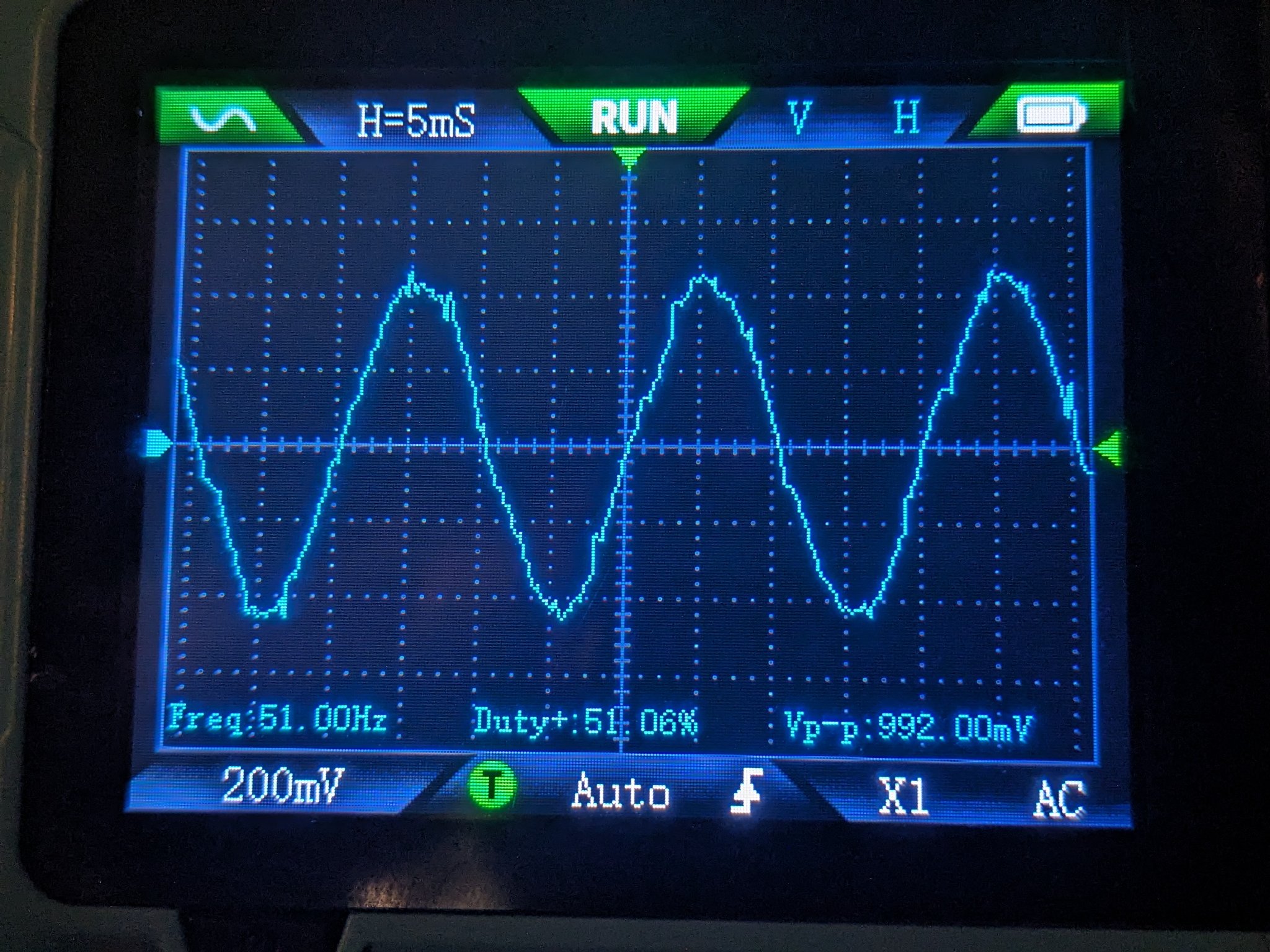

I have an oscilloscope now. I'm looking at the signals coming from the preamp with a 500 hz 0.3 v square wave input. To my untrained eye they look quite different. The order is FR, RR, FL, RL starting with the first photo. FL and RL have noticeably higher amplitude.

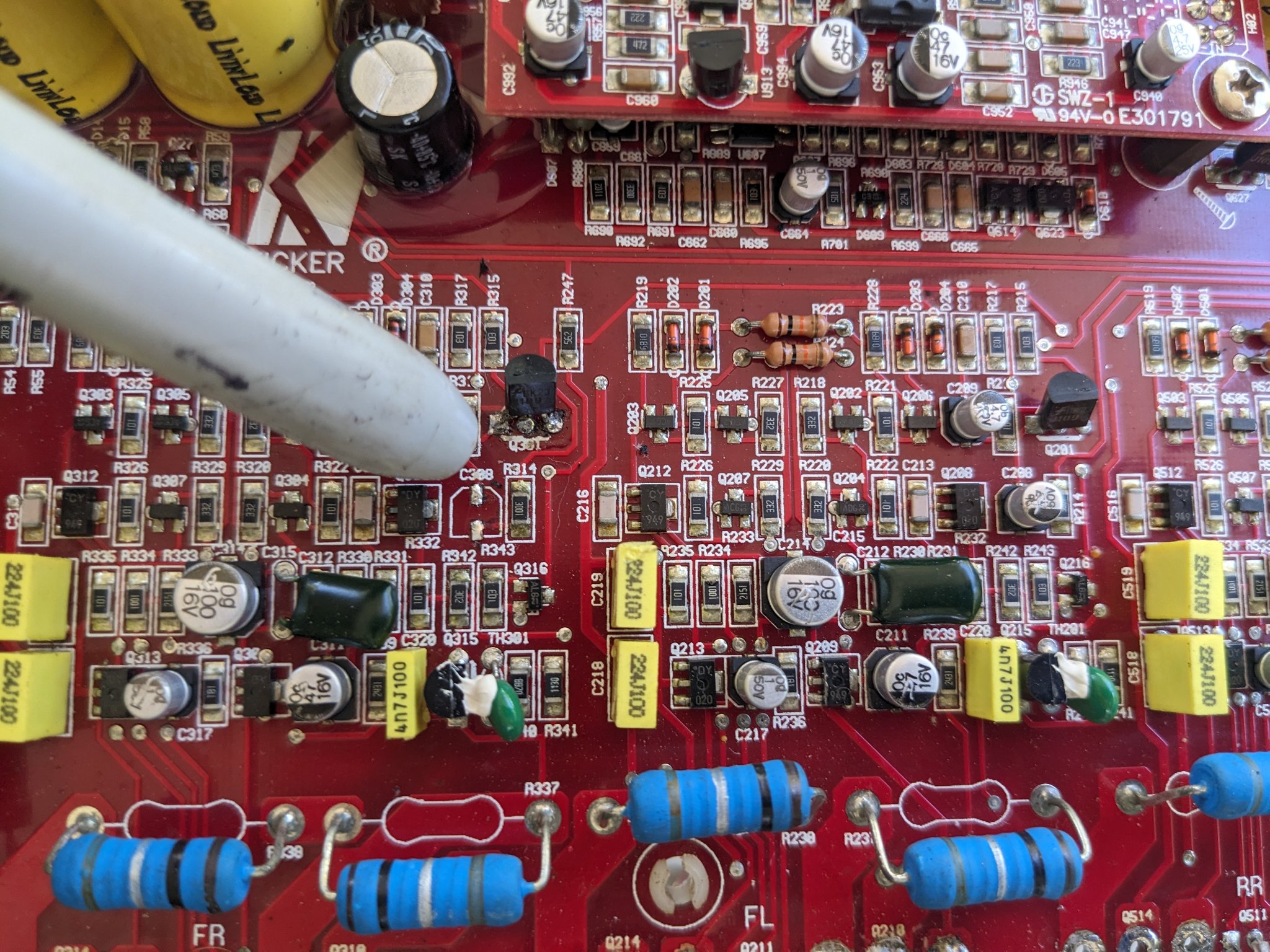

In the meantime I swapped the output transistors (front to rear) and it made no difference. I also tried pulling q301 in the output section for FR and it made no difference.
Any ideas?

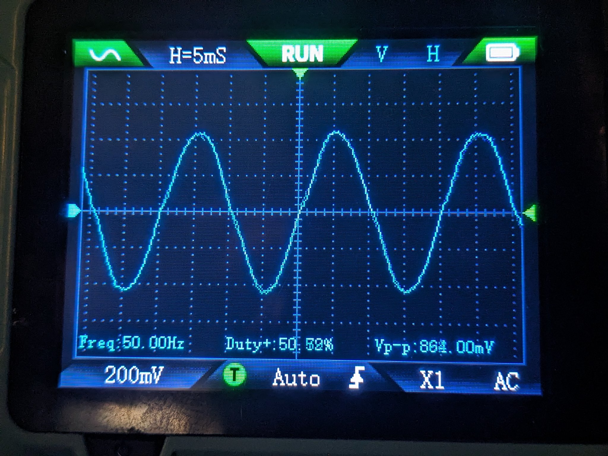

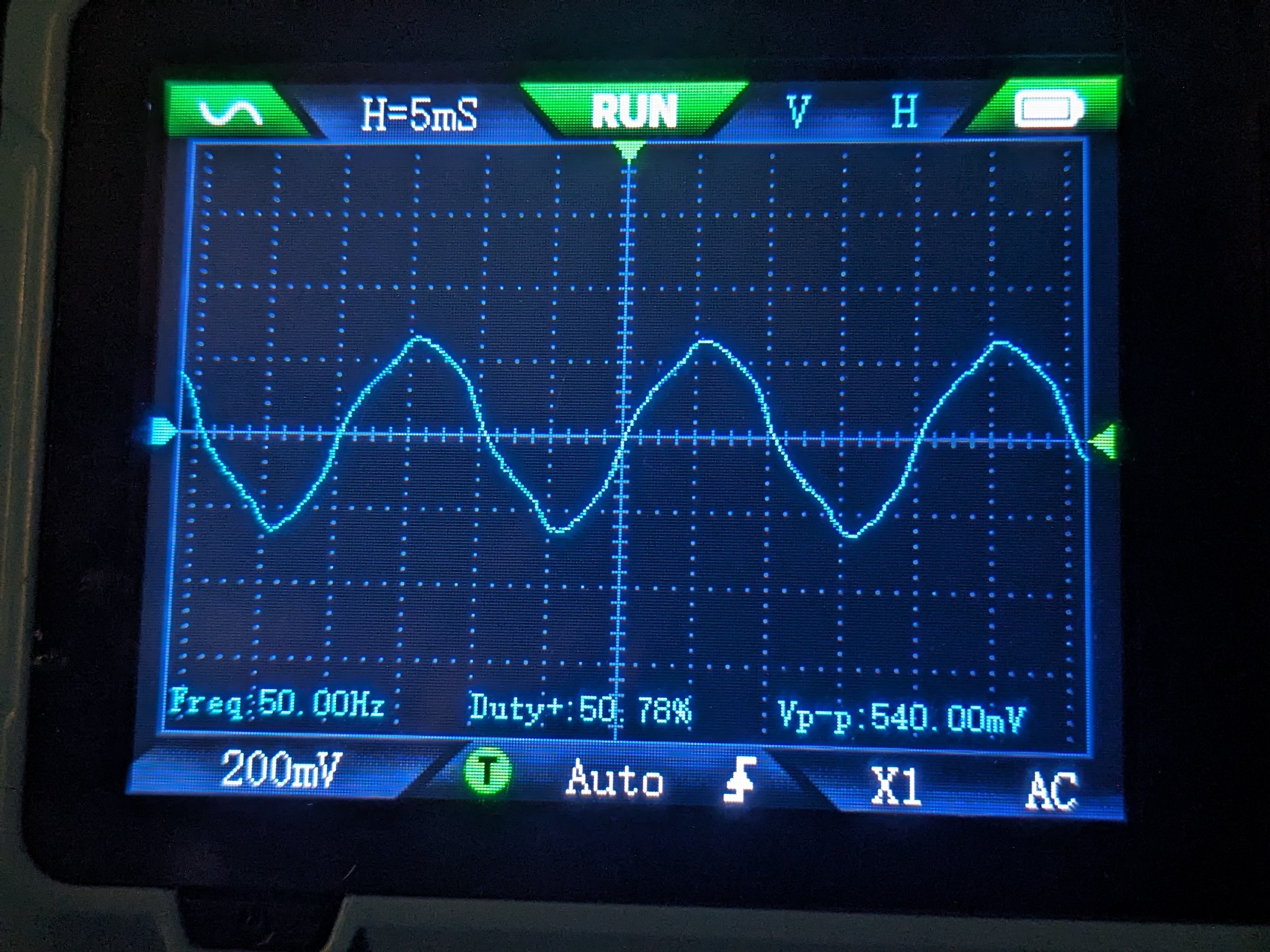

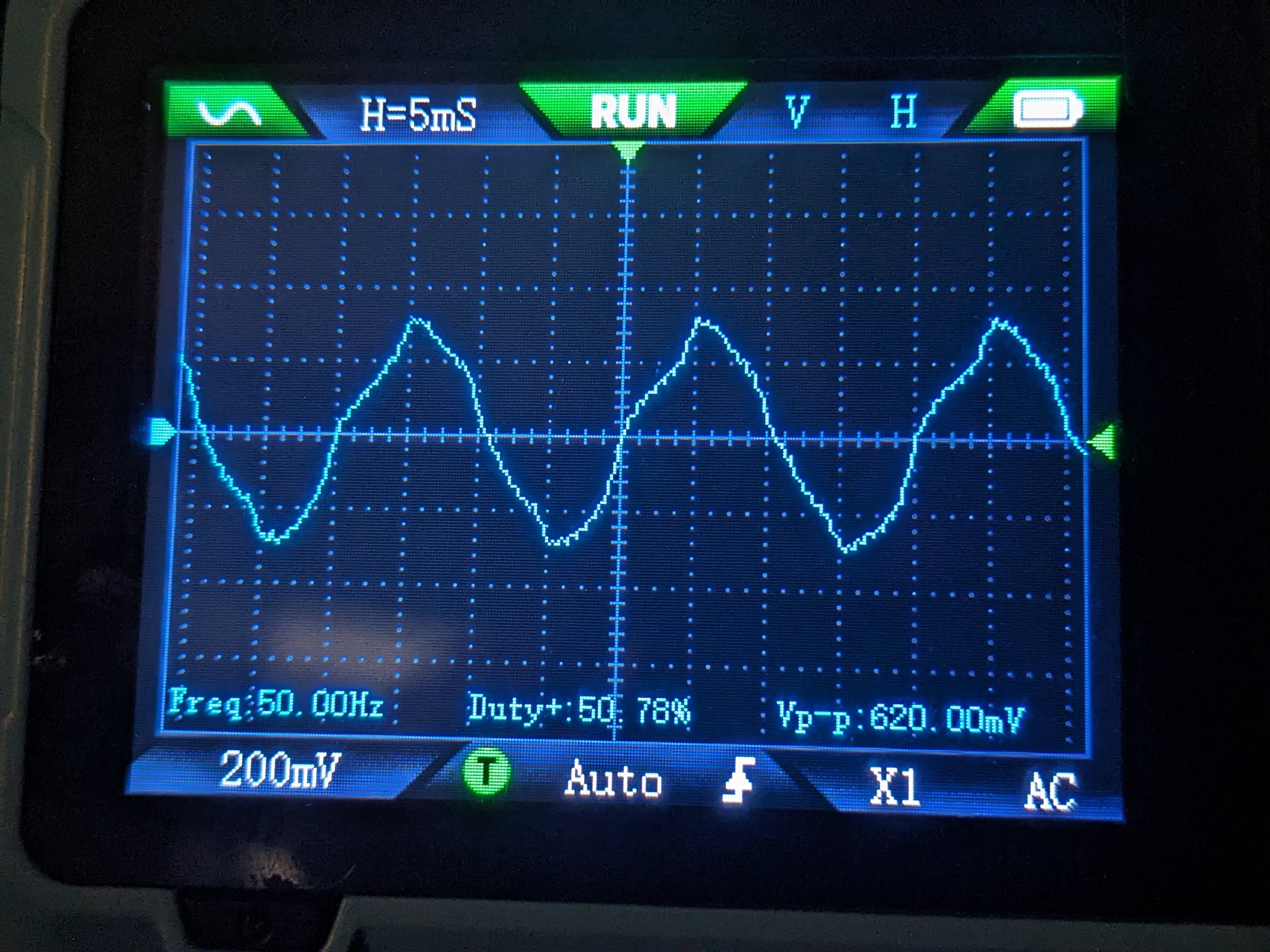

Take it off of auto and use it by setting the vertical amplifier to 5v/div, the timebase to 2ms and drive a 50Hz sine wave signal into the amplifier. Set all crossovers to the highest frequencies. Subsonic to lowest.
Adjust the trigger level if it doesn't trigger. If it still won't trigger, go to 2v/div.
Here is the best I could get with 3.0V sine wave at 50 hz input at rca. Trigger is on auto. That is FR, RR, FL, RL.

PapaZBill is who you need at this point. At least there's something to work with.
Is the 300 series channel the low channel?
Do you have a 5.6k resistor feeding signal to all of the muting JFETs?
If so, is the signal level the same (in general, measured with a multimeter set to ACV) on all of those?
At the speaker channels, how much weaker is the weak channel than the others? ACV for each?
