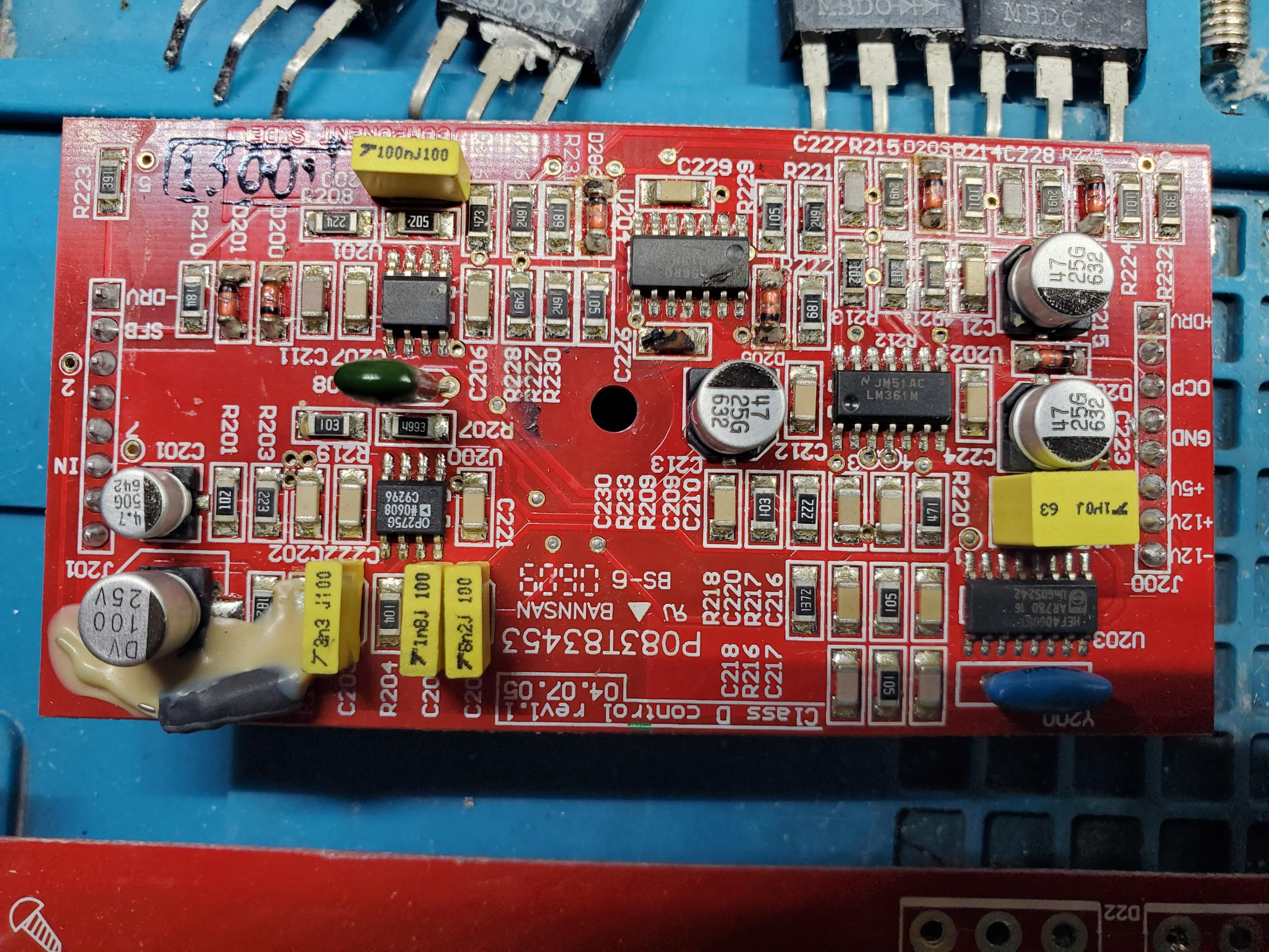

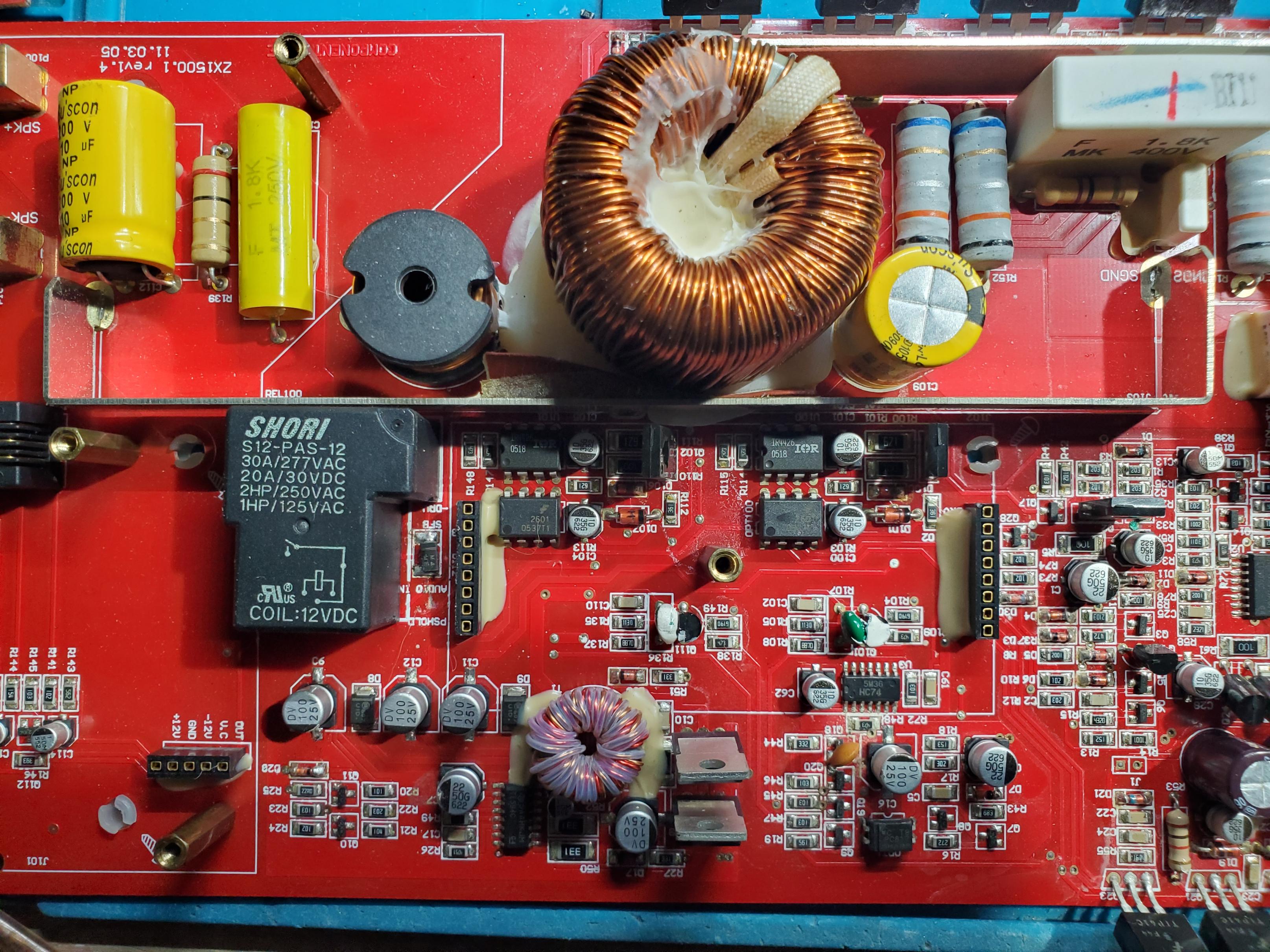

So, everything in place including outputs and w/o Q15, you have a rapid protection LED flashing?
Is this also true with Q15 installed?
Are you applying signal? Remove the input board and see what happens.
Post a closeup picture of the softstart circuit and U2, and another of the board w/o the input board.
D3 through D6 are 1N4148.
Verify that the following are true.
Q1,Q3,Q6,Q15 are all 2N4401
Q5,Q16,Q17-2N4403
Q4-MPSA14
Check C1-22uf/25v and C2-10nf
Send a close up of the soft start as is. I might be able to spot something.
Q5,Q16,Q17-2N4403
Q4-MPSA14
Based on the list i found a few transistors of the wrong value installed. Could you tell me what Q14 and Q28 should be.
