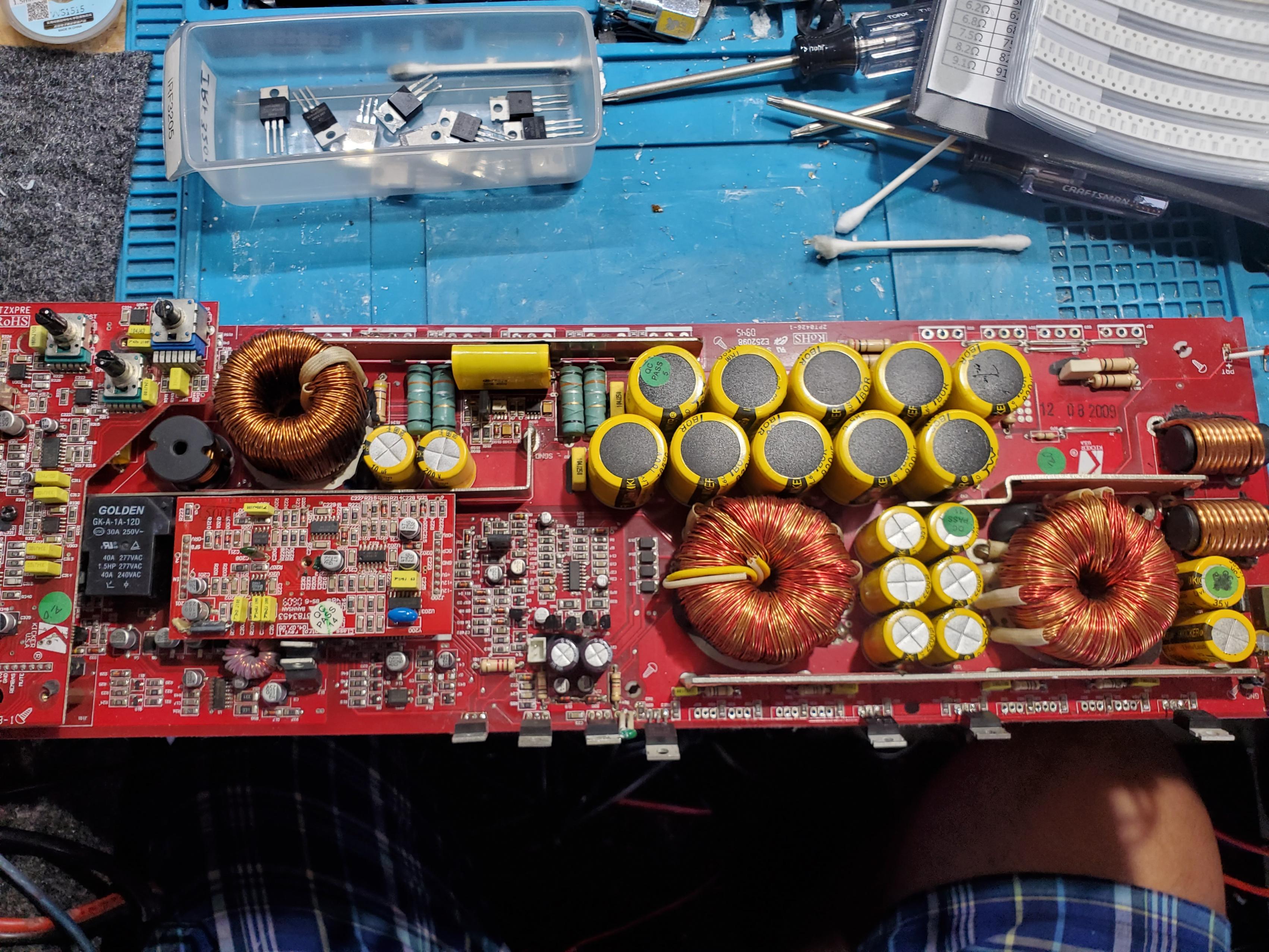

Ok so im back to looking at these amplifiers again. Since i cant remember what i have and havent done. Im starting at the power supply. Right now i only have four ps misfet in circuit.
I beleive there is a problem with the voltage regulation.

Q21 (15v) Q22 (-15v) Q23 (5v) so it appears the power supply and regulator circuit are working. If memory serves the +/- rails should be about 110 volts.
If the rectifier diodes are not shorted, reinstall them and replace, same with the output mosfets.
What are the symptoms? Protection, no Drive no Output?
protection now flashes. my probe slipped between +12, +5 pins.
if i remove the d7 diode it powers up.
i will.reinstall the output and rectifier diodes
they all test good.

Ok i reinstalled all good components. Output transistors. and the rectifiers.
d7 installed protection just flashing.
d7 removed. Drawed about 2amps and the relay was clicking every 5 seconds. The protection came on again
This is with the driver card with the L200.

rail -65.71 +70.21 and regulated voltage is present. Some strange sound is emitting somewhere near the outputs when the amplifier goes into protection and starts clicking the relay on and off
Check U3-74HC74 Pins 4 & 6 for 5Vdc from neg speaker terminal. If no 5Vdc on Pin 6 Look at Q9,18,19,20-KTC4401 for shorted devices. Also, check Q101-MPSA92 and Q111-MPSA42. Q101 and Q111 are the OCP sensors and tie back the U3 through the KTC4401 transistors. If any short whichs has been known to happen they will send a false and cause amp to go into protection mode.
neither pin has 5v on it, replaced every part on the list still same effect. the relay will click 3-4x fast on and off off then wait like its going to come on but just click again.
pin 4) 2.894vdc
pin 6) .336vdc

Remove the Class D control board and check to see if U3 Pin 4 has 5vdc. You may have to remove D7.
Have you tried the other Class D board?
no its at 3.85 then drops down to the 2.89
D7 is removed.
I have tried both driver cards same result.
D7 is removed.
Okay, Look at the DC voltage across C11 and C12. You should have about 18 volts.
This is the isolated supply for the Class D drivers Q102 associated with C12 and Q100 associated with C11.
Check the Voltages at all three legs of Q102 and Q100 using the negative side of their associated capacitors.
Recheck the following. I'm not clear if you replaced the devices. There should be 5 volts on U3-Pins 4 & 6. You may need to replace the 74HC74 or the OPT1-PC817- You should be using the negative speaker terminal as a reference or the power transformer secondary.

ok so across the capacitors 15.69vdc
i changed the 74hc74d and now have
pin 4) 4.979v
pin 6) 4.726v
the protection stopped somehow? Not right away after changing the 74hc74d but a few power up after.

So the 74HC74 was bad and replacing it restored the protection circuit. Pin 6 of U3 is the Not Q output of the flip flop and when low will cause Pin 16 of U2-TL594 to go high and causing a Protection condition.
Now that the amp is out of protection what is the status of output, drive etc..
so once i installed the class d card back into protection. and something is pulling down the voltage to about 10.2vdc after the relay engadges, without the class d card the result is the same now.
When you say something is pulling down the voltage to 10.2 vdc,which voltage are you referring to?
And without the class D board the amp Powers up and all voltages appear to be nominal?
Please give as much detail as possible. This amp is tricky, with isolated supply's and the class D board complicates troubleshooting.
