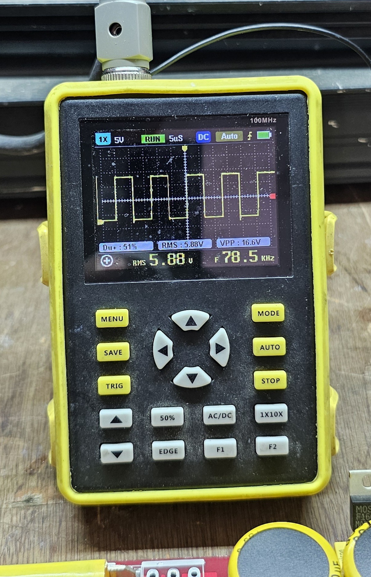

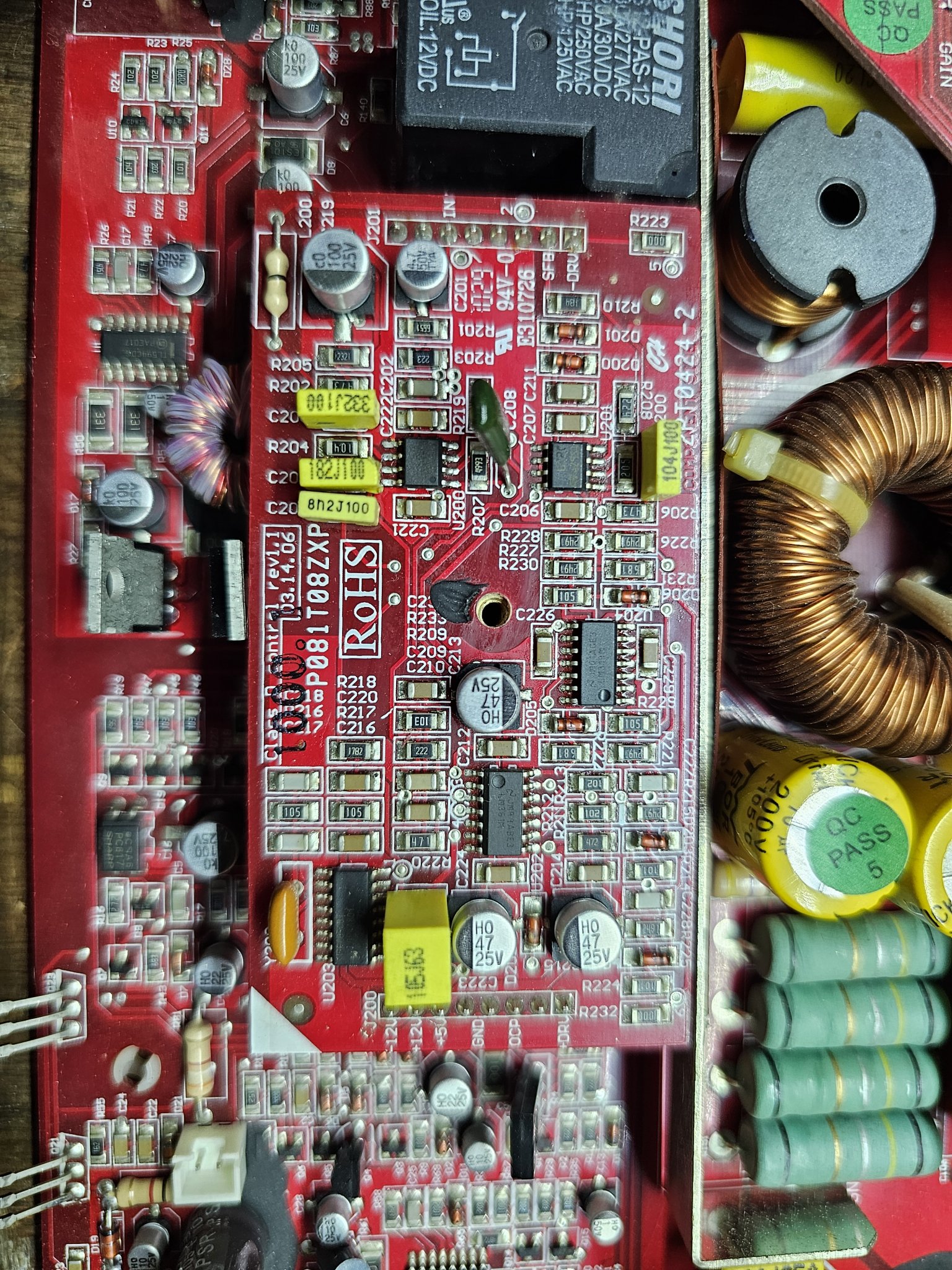

Good afternoon everyone, on this occasion I am urging you to repair this Kicker brand amplifier model ZX1000.1 REV 2.1. At the beginning, damage was found in the power supply, it has already been recovered and in the output stage there is an auxiliary supply that was damaged, the 2 htp18n06g were replaced and the 1n4002 diode is already oscillating, but now I have stopped at the driver card, I already managed to get it to turn on and stay on, I don't have any pulses in the output fets, I mention that I have the fets outside the board since if I leave them inside they won't stay on, greetings

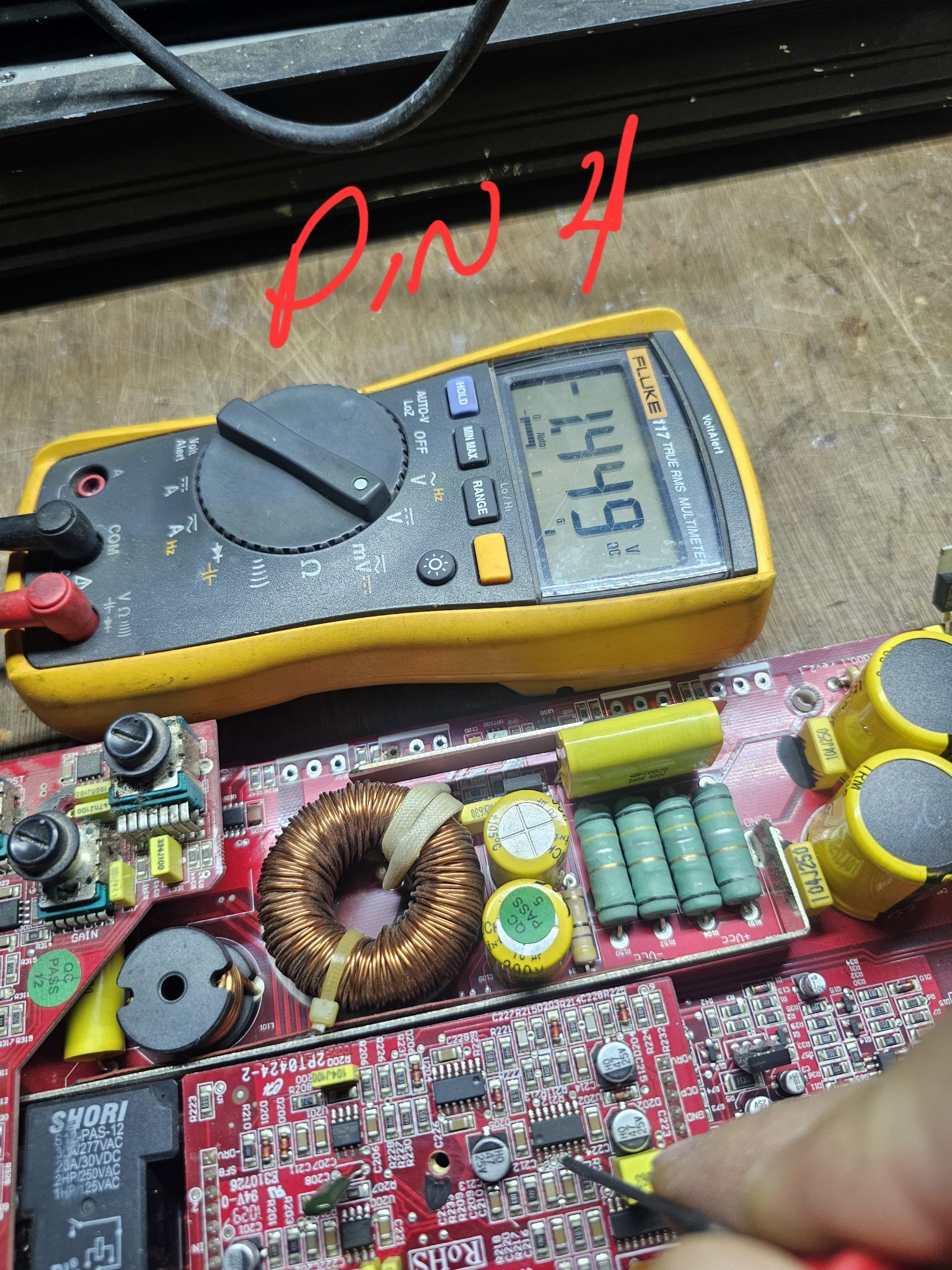

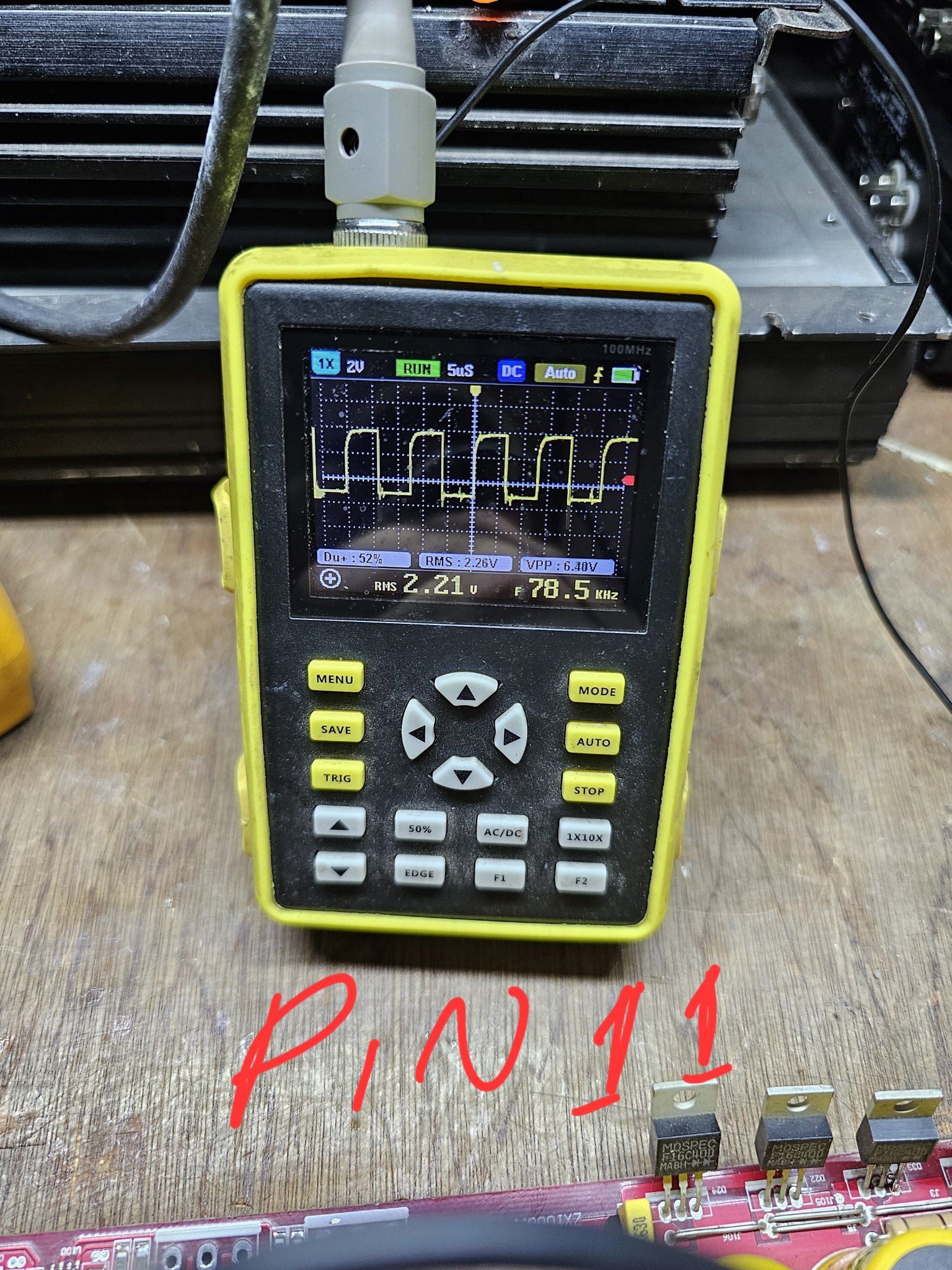

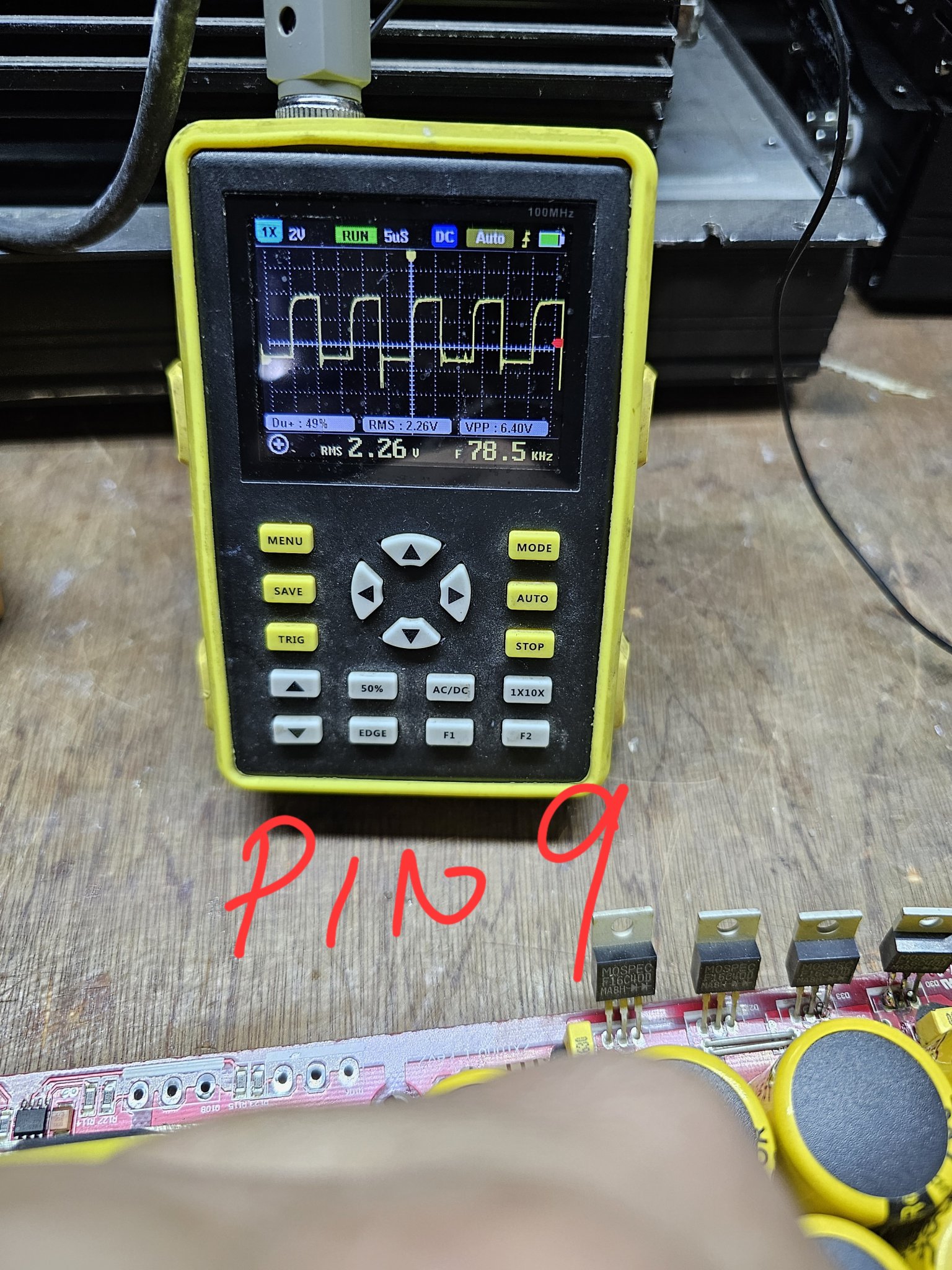

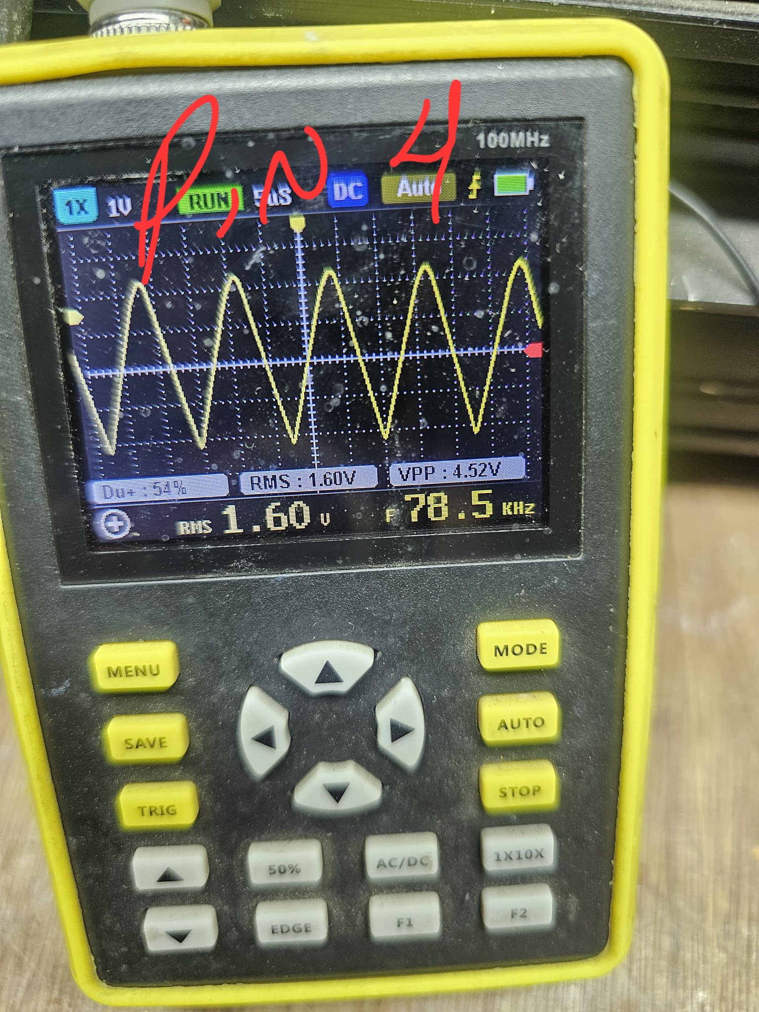

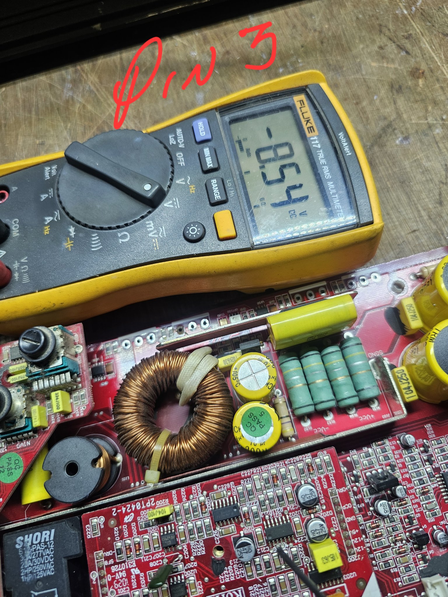

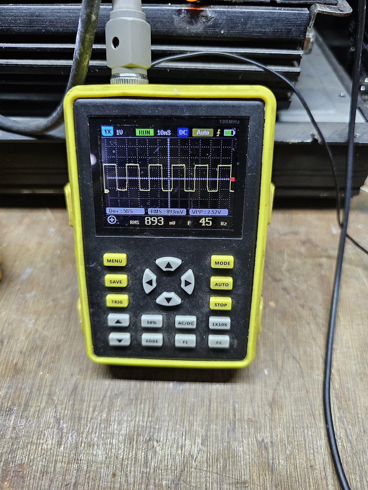

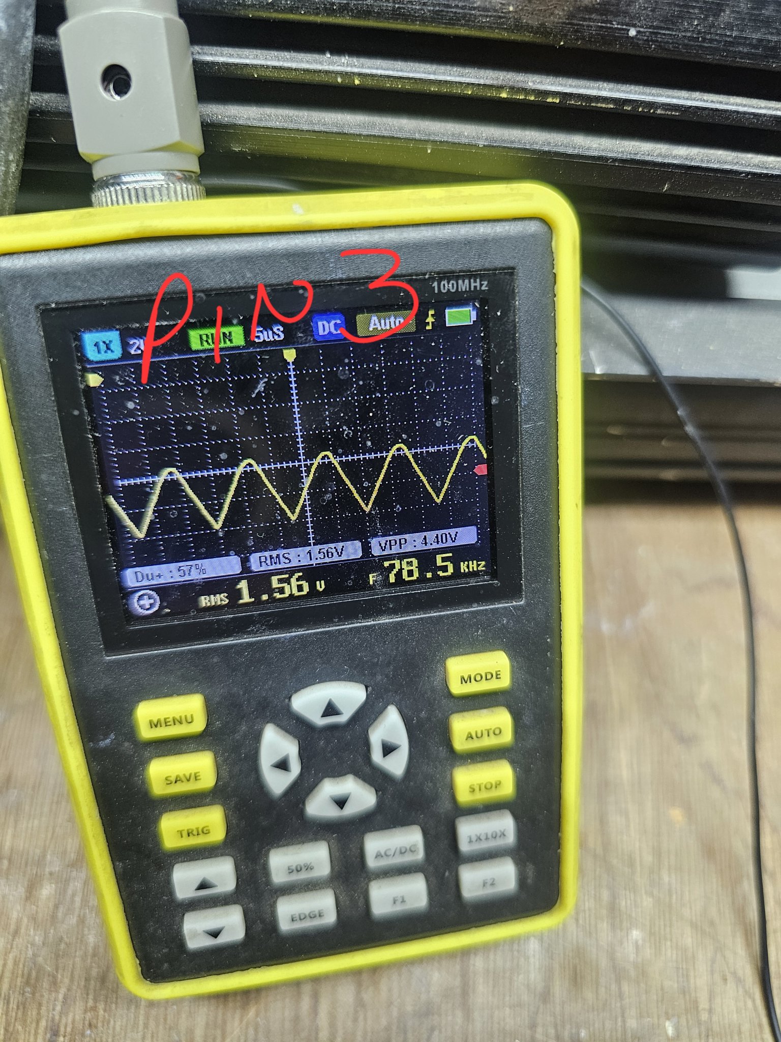

Here are the voltages and signals measured with a multimeter and with the oscilloscope

To clarify, you have a triangle wave on pin 4 and 0v DC on pin 3? Yes
DCV on the two output terminals of the LM361? Pin 9. 4.64v Pin 11. 0v
DCV on the 4 PS terminals of the LM361?
Pin 1. 15.36v
Pin 6. -15.35v
Pin 14. 2.6 with reference to pin 10 and 4.9v with reference to gnd

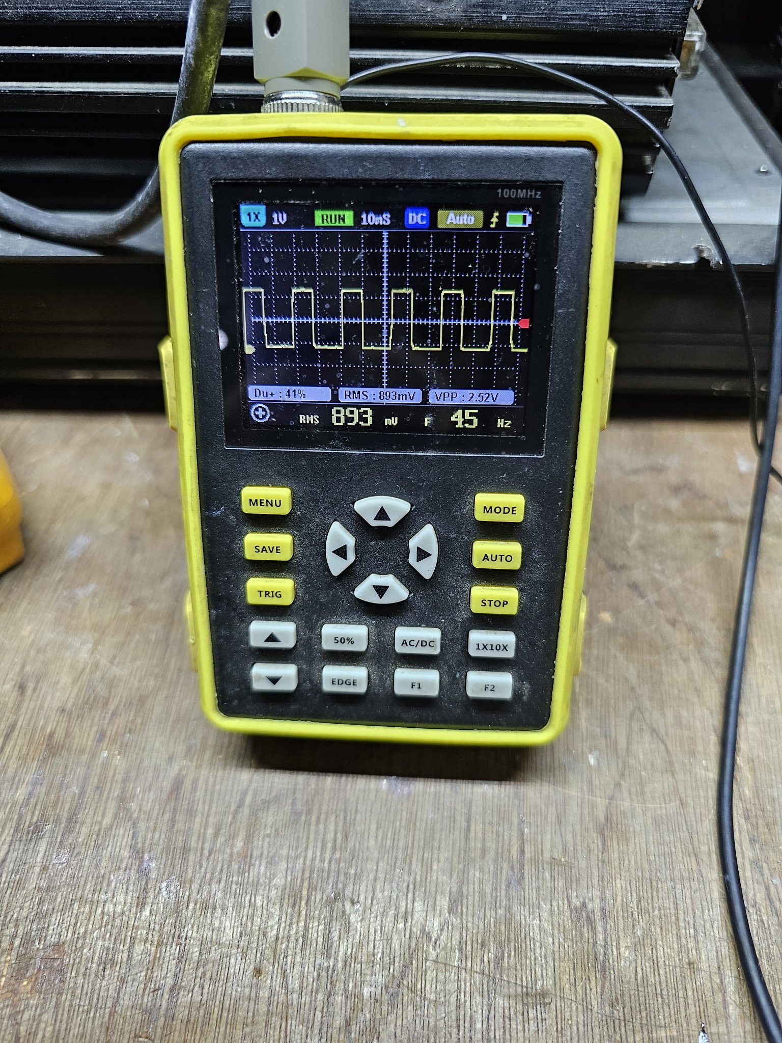

On pin 9 and 11 I already see a 45 Hz square wave and that signal reaches Diodes d205 and d206 on their anodes and from then on it does not go out to -drv and +drv respectively

oh no, it first goes through a 1kohm resistor followed by another 2490 ohm resistor and touches some diodes until it reaches the lm319 and at the outputs of the lm319 I don't see it coming out and and I don't think it's because of dirt, I just pushed it all the way down.
